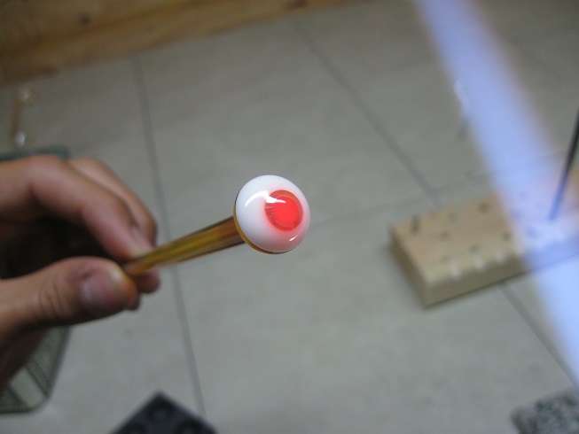

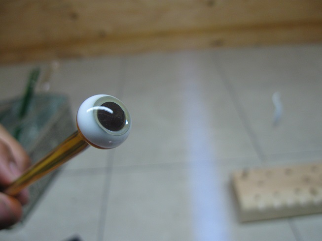

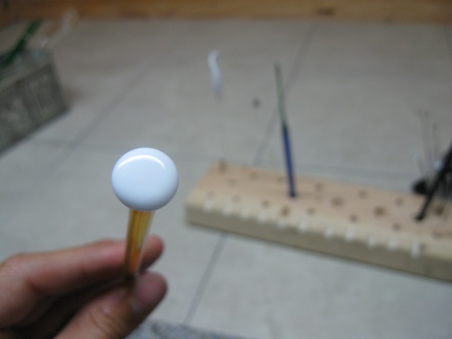

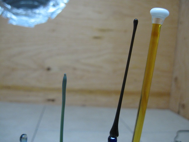

First I attach a section of white to a punty. (all out of 6 mil so I used some chinese yellow with clear on the end as my punty) I attach the white to clear in order to save color, if you have long rods of white you can just build the eyeball off of that. Flatten the gather and flame polish.

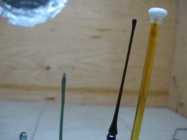

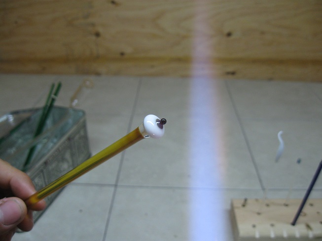

Have some stringers ready for adding the iris and pupil, or you can use some pre-made eyeball murrine.

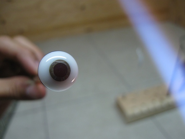

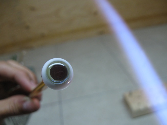

I place my color for the iris down, melt it in, then put a small black dot for the pupil. Use gravity while melting in the pupil to make sure it is centered

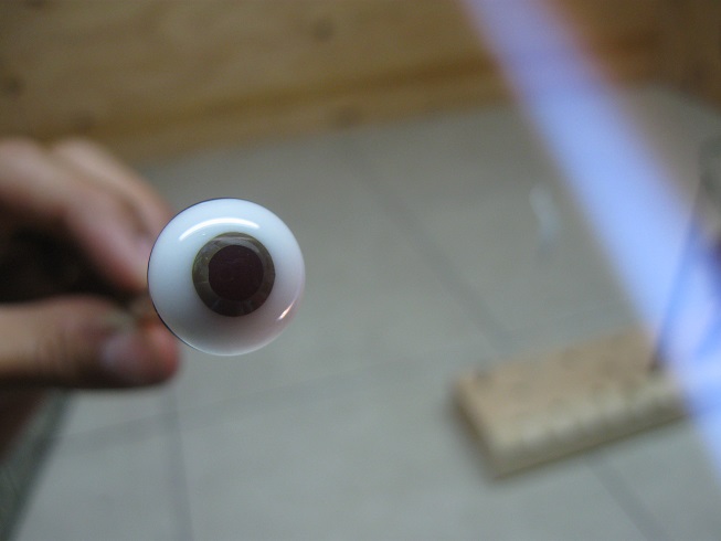

After it is all melted in nice and smooth, add a small gather of clear that is big enough to cover the iris.
I usually marver it slightly to make sure it melts over evenly with the pupil in the center.

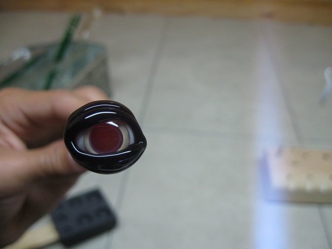

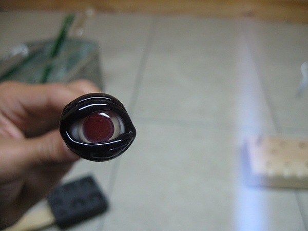

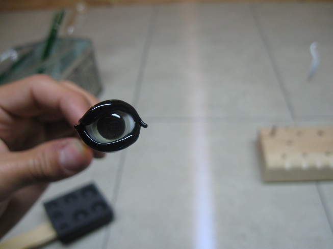

Now start laying down the lids. I used NS Jet black for this one.

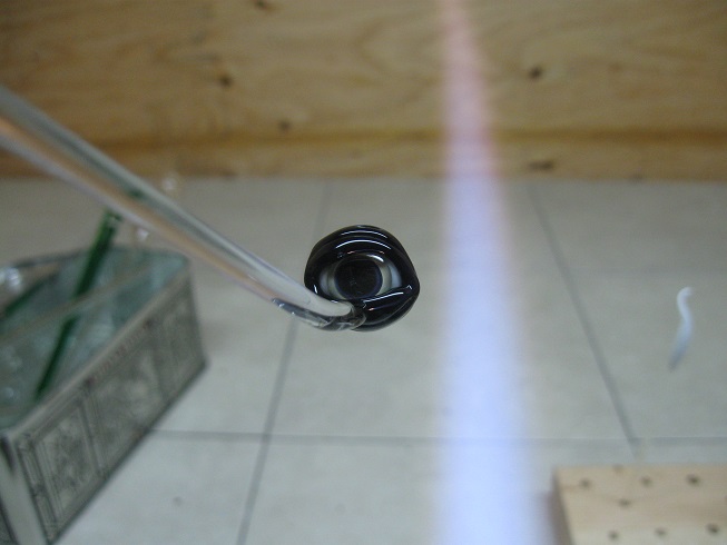

As you lay the eyelids down, make sure they are pressed up against the previous lines to prevent gaps in between them. Melt in the ends of the eye lids with a small pointy flame, but be very careful not the melt them into the lens of the eye.
For me it takes 3 lines on each side to make the eyelids, but this all depends on the size of the stringer used and the style of eyelids that are desired.

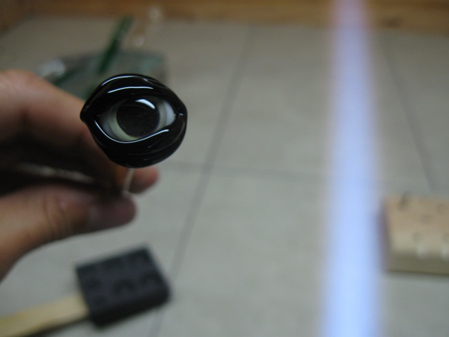

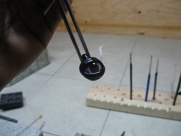

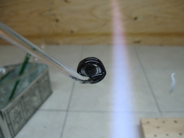

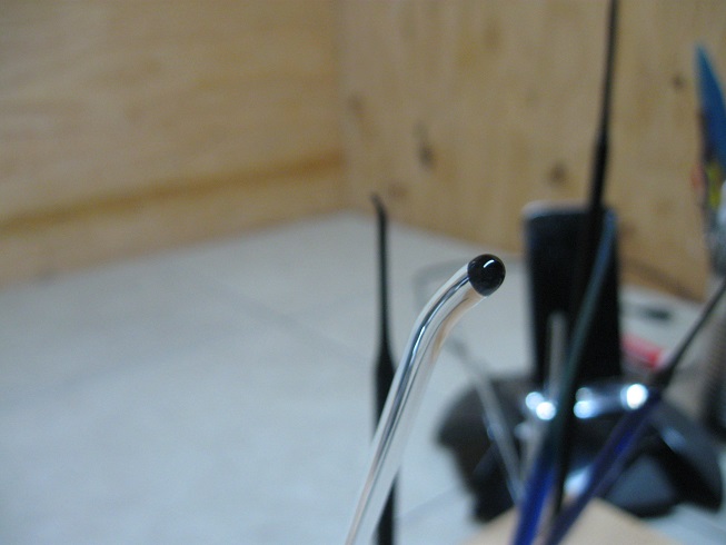

To complete the back side of the pendant, I punty up to the front of the eye. I add a bit of color to some 4mm rod and cold seal it to the bottom eyelid. I have to say it took messing up a few really nice eyes to figure out how to punty up to the front, but this is what method I found most suitable for myself, others prefer puntying to the lens.

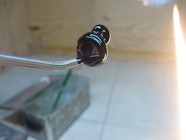

Once the back is nice and melted in smoothly you can attach a loop. I make loops by attaching a section of rod and bending it into place before melting in, this is one of many different ways to attach a loop.

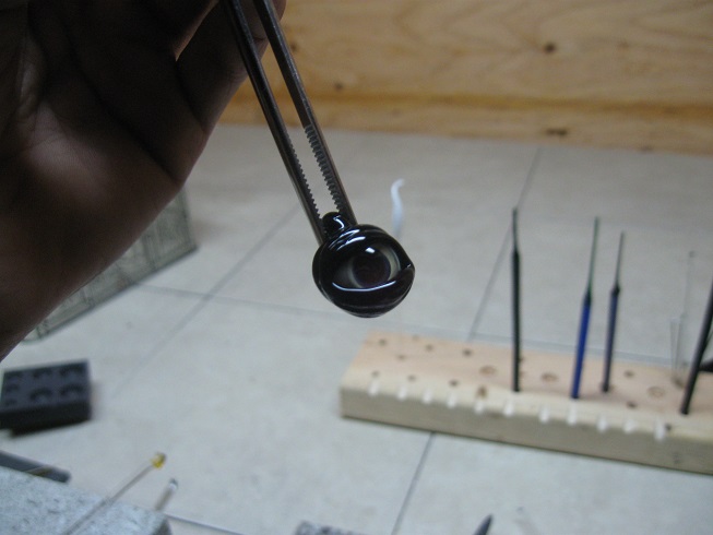

Now just grab the loop with some tweezers, break off the cold seal, polish and anneal!
