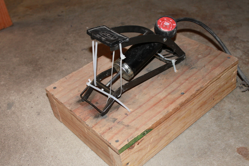

Here is the footpump. I zip tied the pedal down about halfway to limit the amount of pressure with each pump. You can feather it for the slightest amount of pressure, or step on repeatedly for large amounts, with everything in between. I zip tied the whole unit to a small wood box to elevate it and stabilize it.

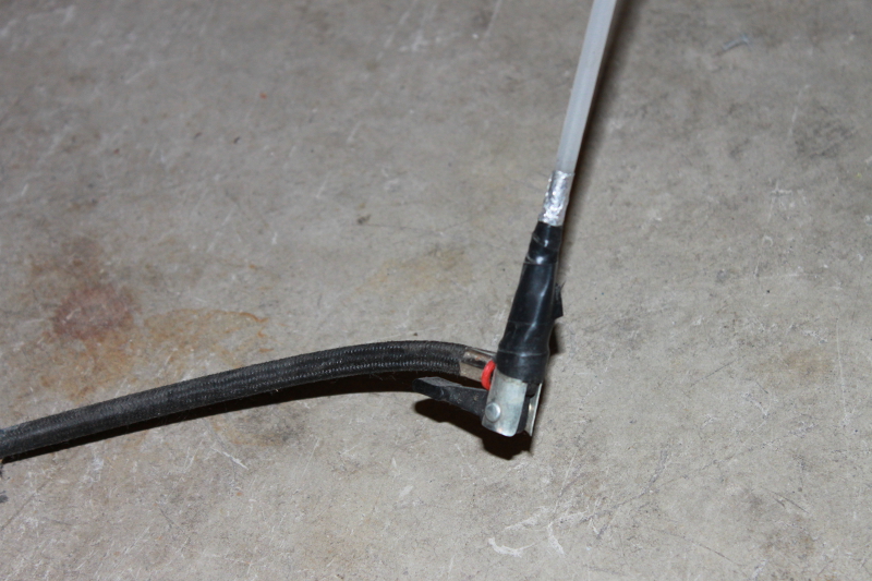

Here is the connection point. I used 1/4" hard plastic line (like the water line for your fridge ice maker), which slides over the red cone adapter on the footpump nice and tight. I then just threw some electric tape over it just to make sure it wouldn't come out.

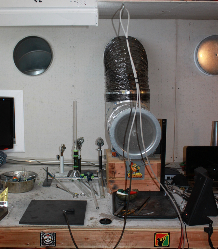

Here is the hard plastic line coming up my station. I hung it on a loop to my side so it just hangs there in arms reach at all times, but is still out of the way. The normal 1/4" latex blowhose tubing fits right over the hard plastic stuff nicely. Make sure to poke at least one small hole in your plastic line so you don't create a vacuum. This is also another way to variate the pressure - more holes for less pressure, cover them up for more. I personally just have one small hole in mine, but season to taste. (Notice the 12" can fan mounted to the bench. I turn that on when pouring frit or creating dust which sucks it all out nicely. There is a backdraft damper on it so it is sealed when not it use.)

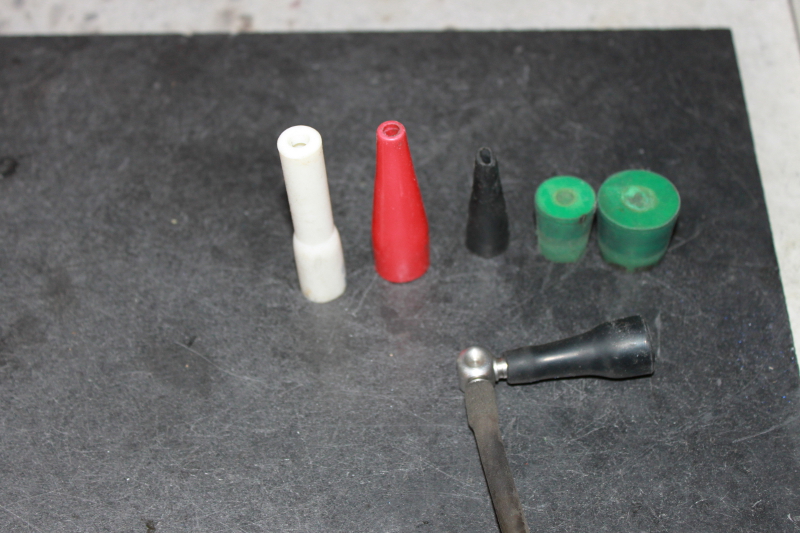

Here are some of the stoppers and boots I use. You can get something to fit any tube you like. You can stick little pieces of 6mm in the holes to make them plugs. Note the Firekist swivel, if you use a swivel and don't have one of these you are really hating on yourself.
