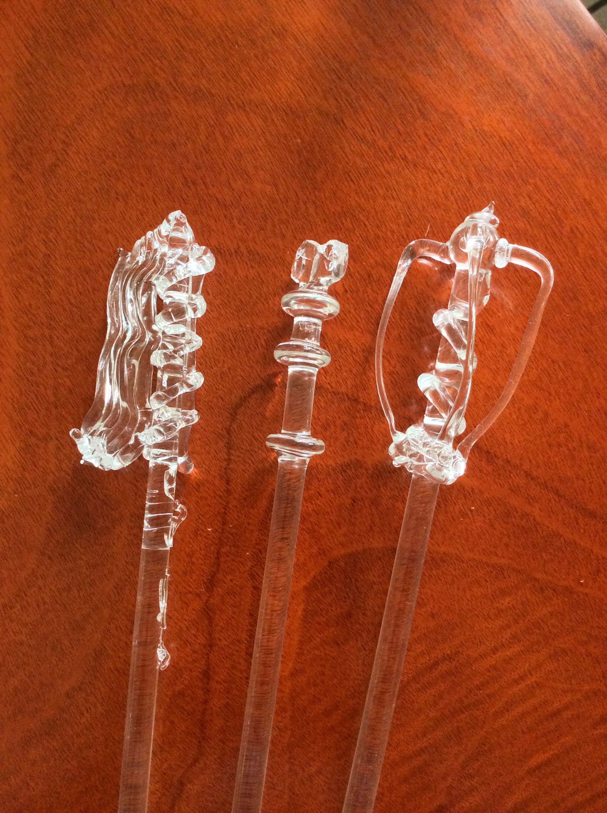

First bubble, point, and bit of creativity...
Attachment 69815

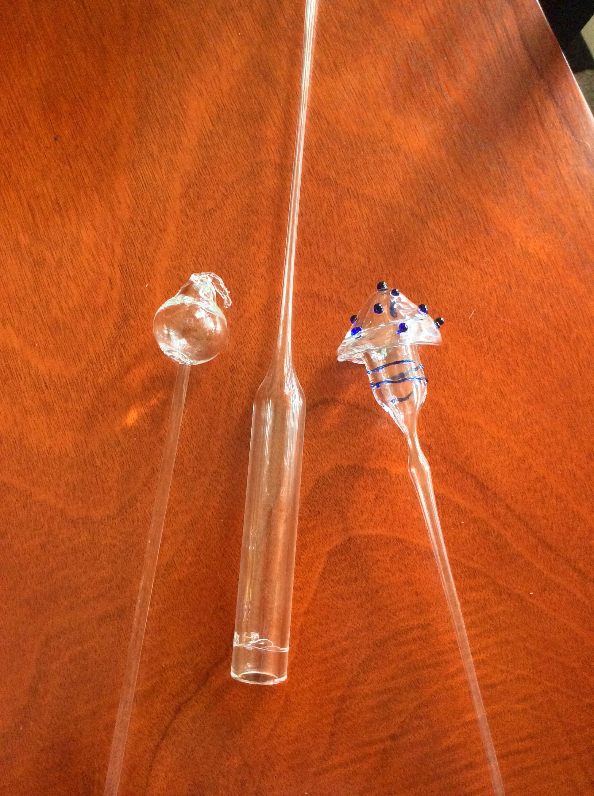

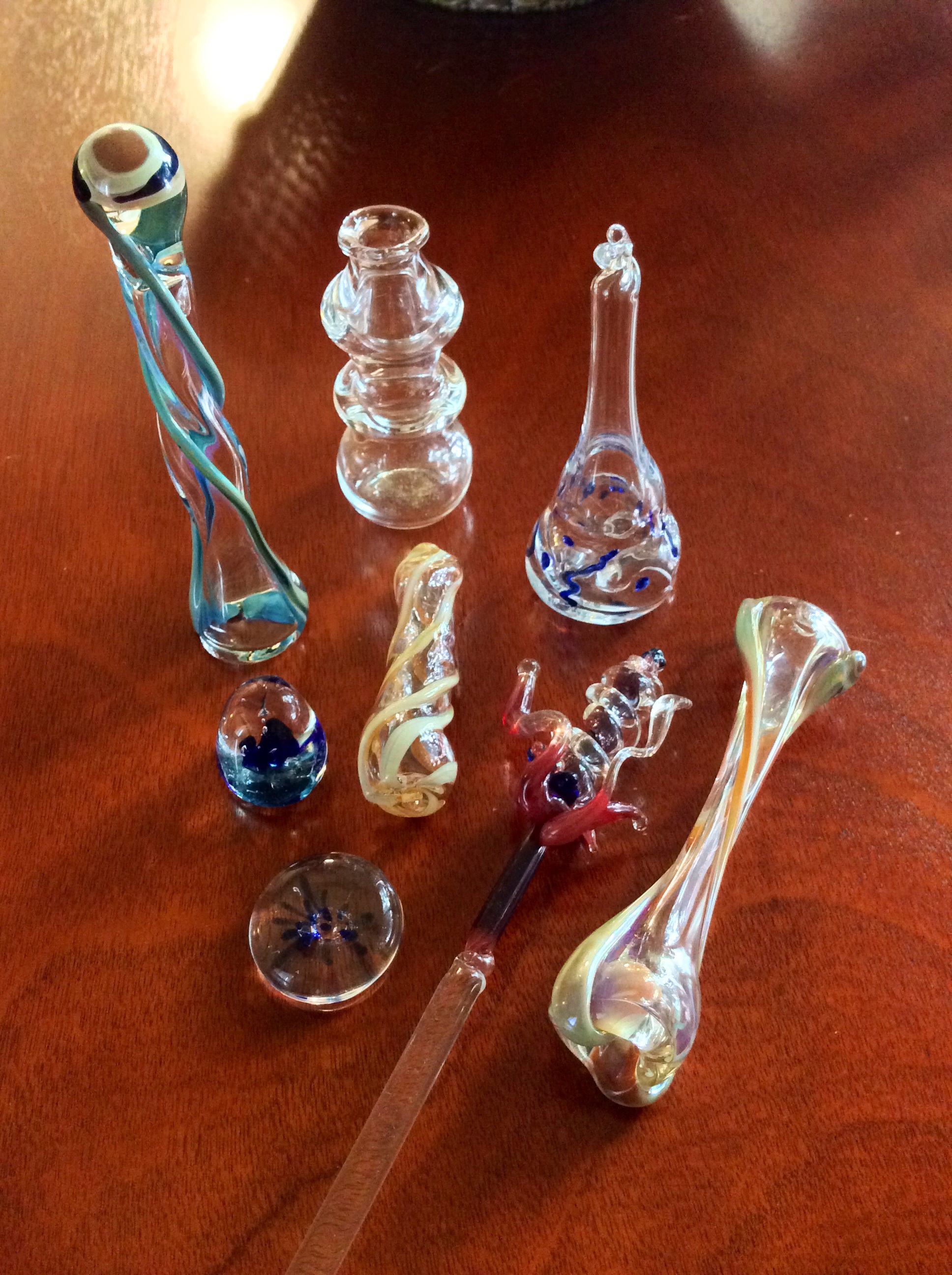

Getting to use some color and a bit more shaping.
Attachment 69816
Attachment 69817

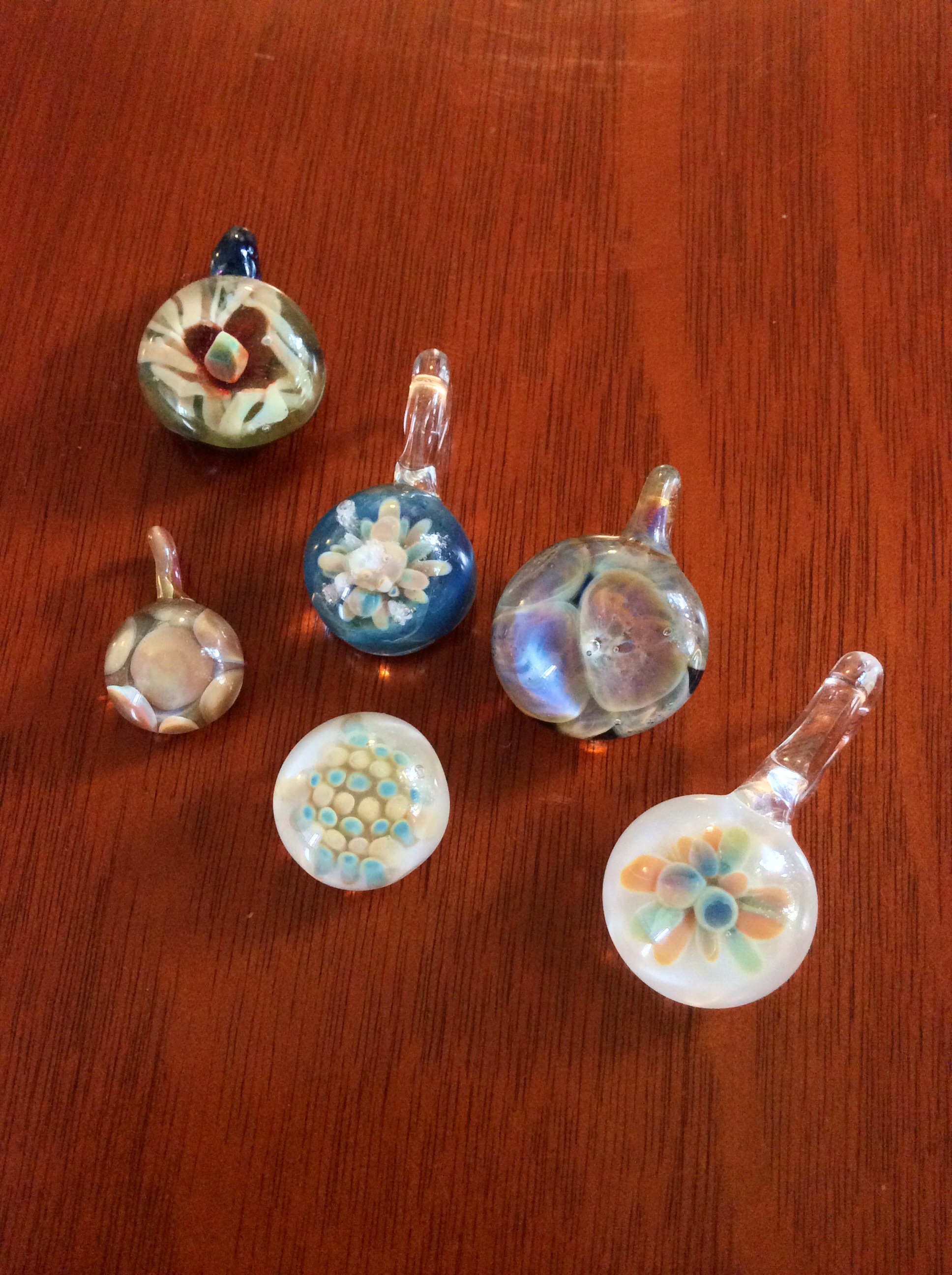

Implosions and pendant shaping.
Attachment 69818

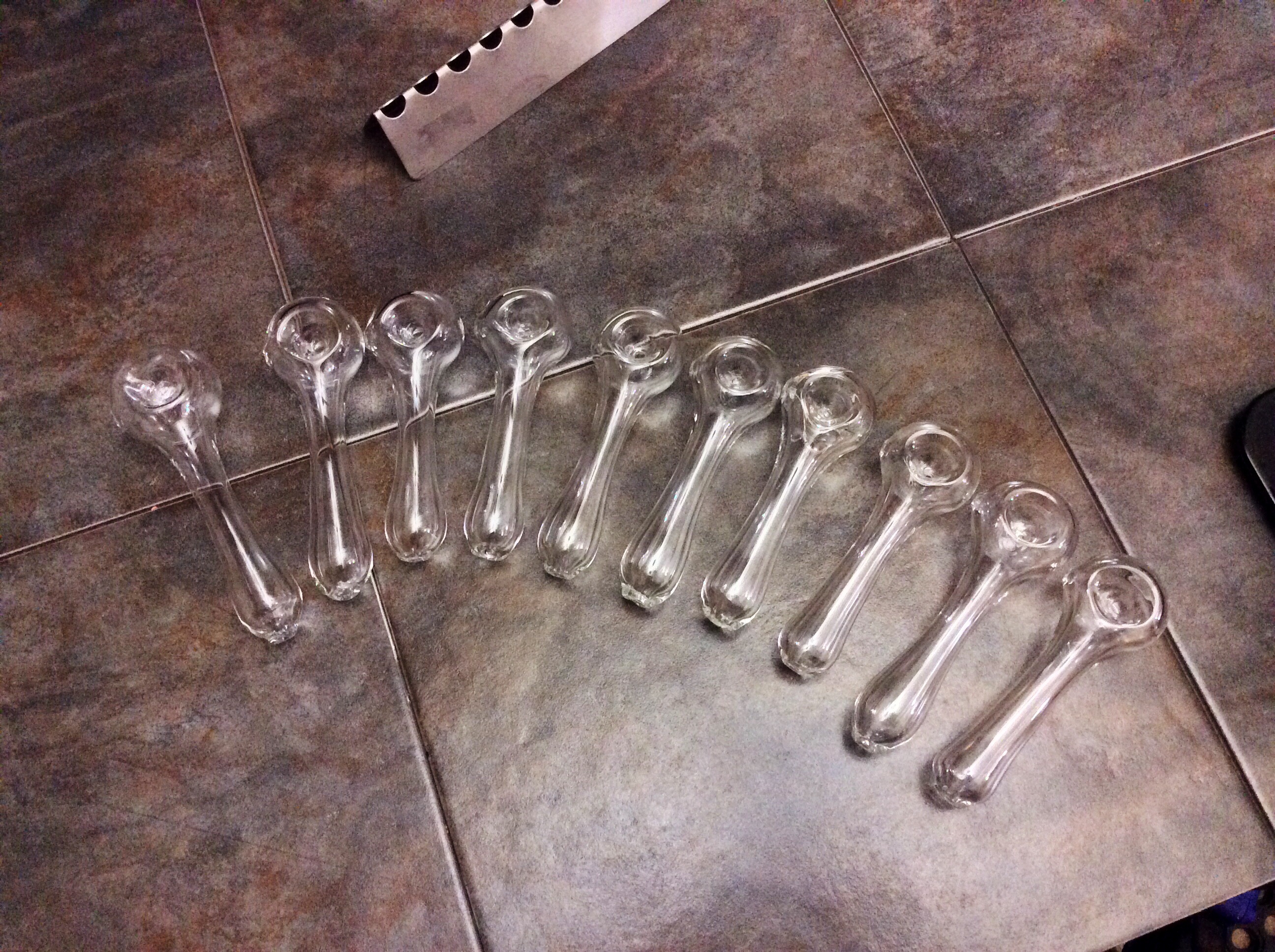

Can't fight the desire to learn pipe art. And everything I've read and watched lets me know it all starts with the spoon. I've also seen enough advice on leaving color alone in the beginning. So I set a goal of 50 clear to start out with.
First ten. Sorry, some of those are hard to even look at...
Attachment 69848

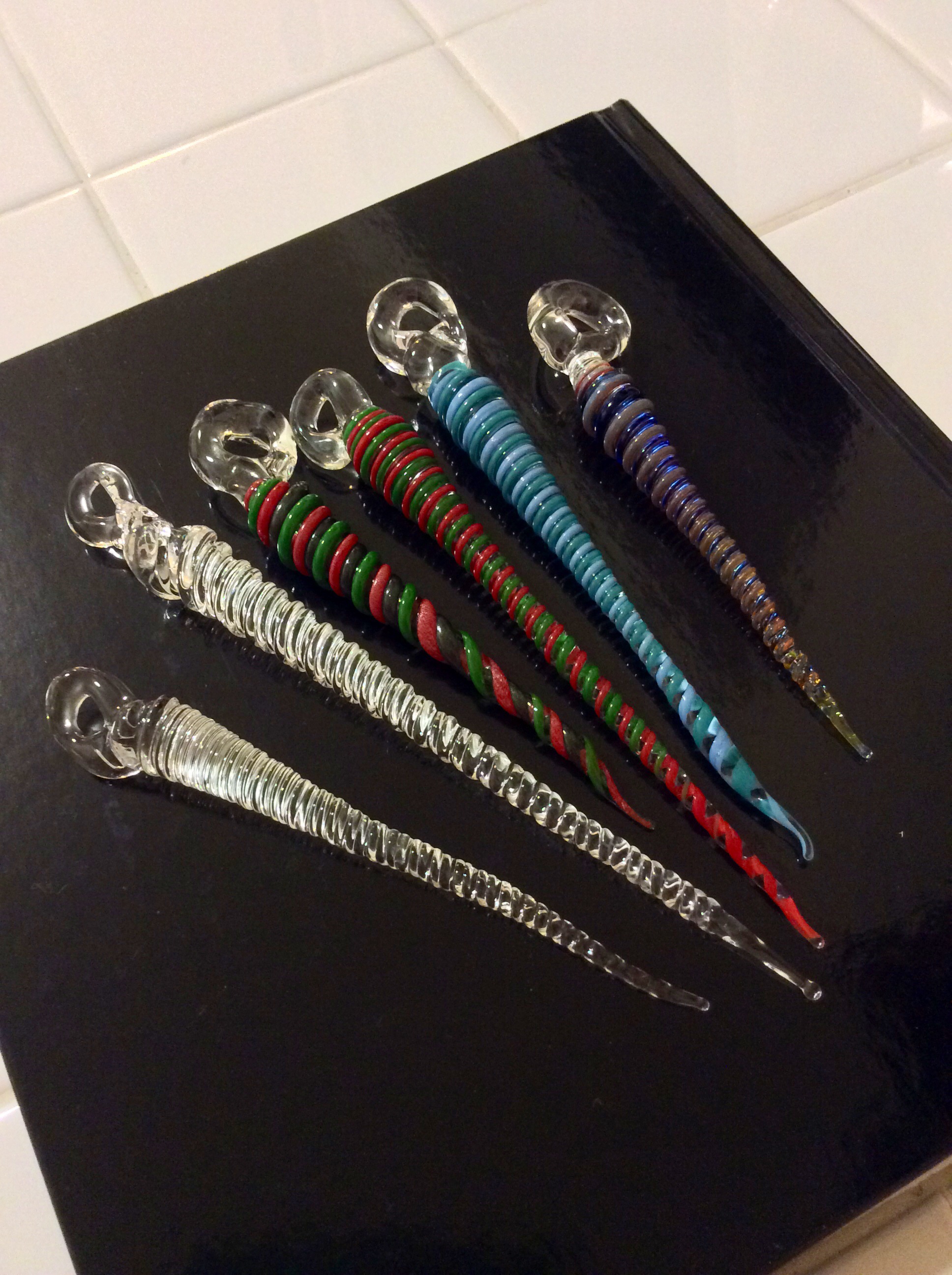

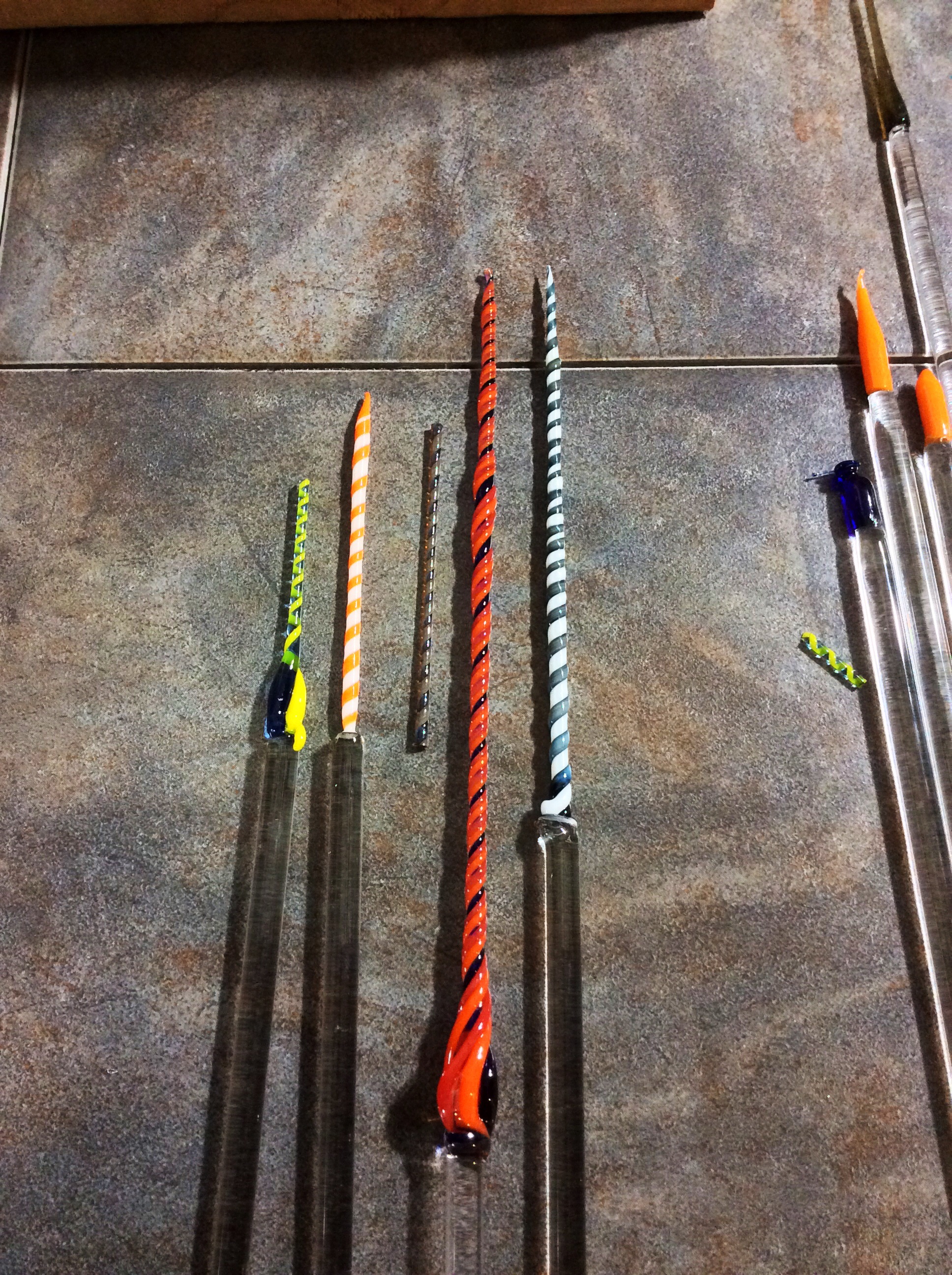

Tried twisting up some icicle ornaments for the holidays.
Attachment 69884

Next set of ten. Having lots of trouble picking out the mouth hole and can't seem to push a straight bowl to save my life. Sizing is starting to get a hair consistent I suppose.
Attachment 69928

i can clearly see progress in just a fews day. good idea setting goals and sticking to them for clear shaping before moving on. your attitude is awesome and i can imagine you making some really cool stuff in no time! sub'd this thread
Re: OceanMelt's Melty Thread
it seems almost everyone thinks picking out the mouthpiece hole is an art you must master, but if its a pain, just get a pair of diamond shears and learn how to work them nicely; they leave a perfect hole easy to ream into a mouthpiece every time in very little time, after a little practice.

Just trying to figure it all out. Diamond shears are def on the next order!

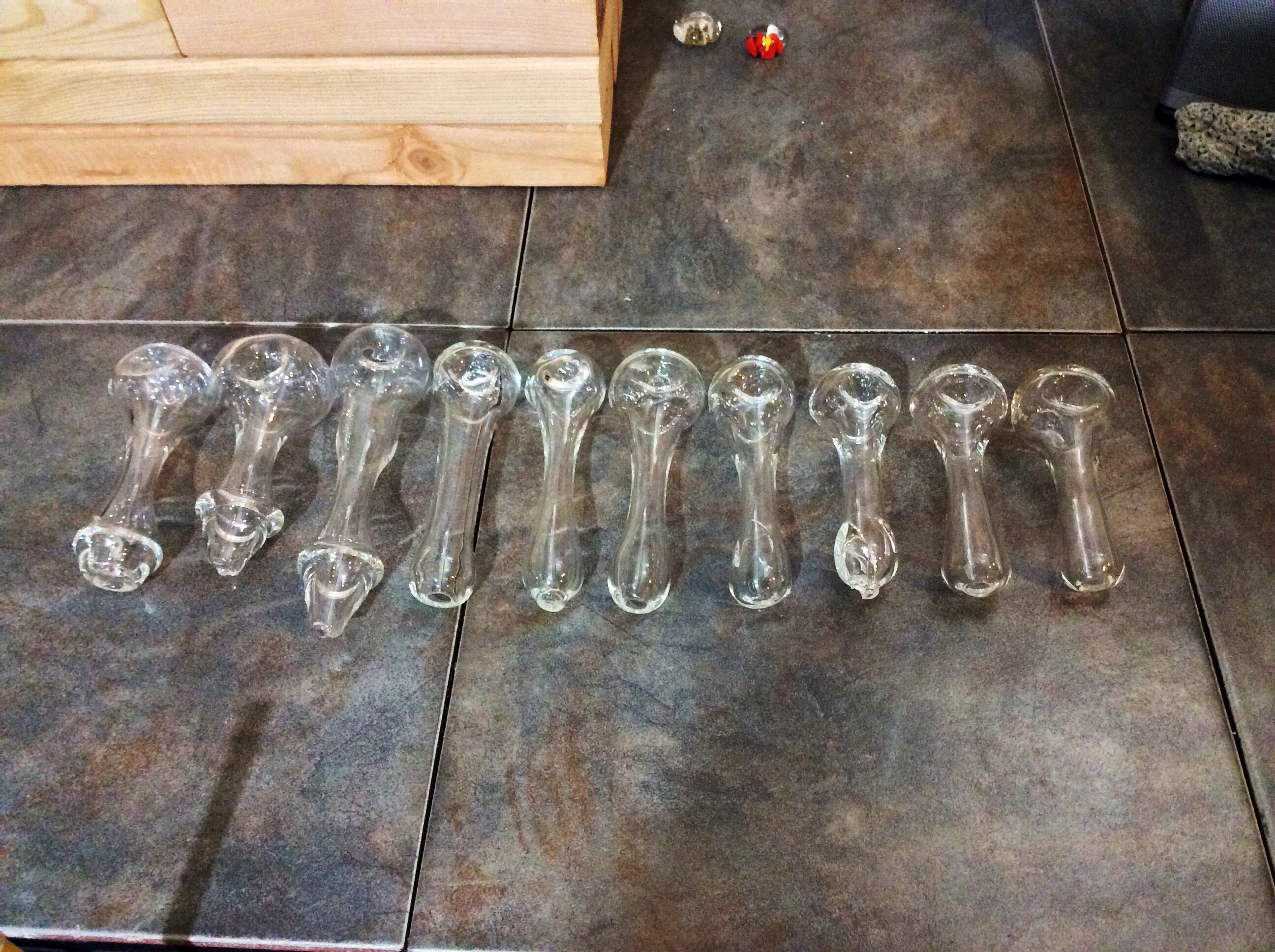

Next set of ten. Second to last one was shaping up to be one of my best to date, but I forgot to flash it before detaching the blow tube....and pop. Then I dropped a blank onto it. Double fail. Pushes seem to be getting straighter though.

Your spoons have a nice shape so props for that! I've been at it 4 months or so and finish all my mouthpieces by picking them open and it's still a pain. So just keep practicing, there's other techniques too. On pushing bowls, I'm just starting to get this down but I make sure to heat evenly around the bowl hole, then take care to have the piece and your push straight up and down when you push. Good luck on your new adventure!
Thanks Ghost. Yeah, I've noticed that taking the extra time to ensure a straight push is key. That and endless repitition :)

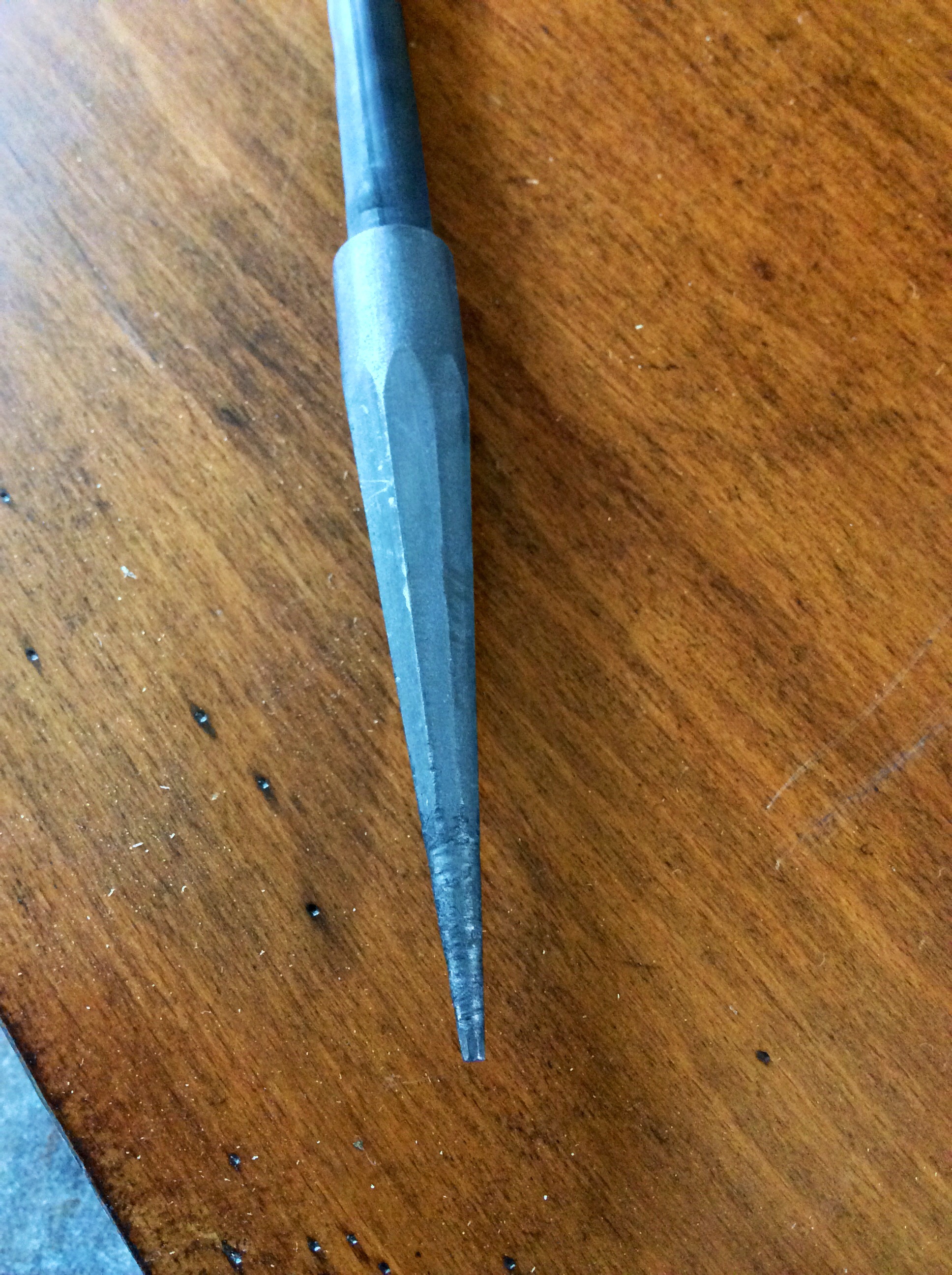

So what's up with my reamer (Sundance)? The edges have quickly worn down to the point where its going to be a round reamer soon. Didn't have any issues with the reamers used in my workshops.
So is it me or the tool?
Attachment 70572

More heat on glass,less pressure on tool...I just use a pencil reamer same on last least few years.

Ok cool, I'll pay more attention to that, thanks.

If its the economy reamer than yea, they are kind of cheaply made! Get some 1000 - 2000 grit sand paper and redo the edges(600 or 800 will work but not as smooth!) I just re-sanded all of my tools this weekend and yes my reamer looked exactly like yours! Nice progress, keep it up!

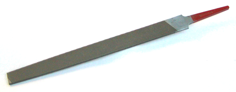

I start with one of these and then finish with fine sand paper or steel wool, then final stage is brown paper towels or wadded up newspaper Attachment 70581

Thanks fellas, I have lots of fine sandpaper/files so I'll give it a go! And yeah, pretty sure I bought the economy one.

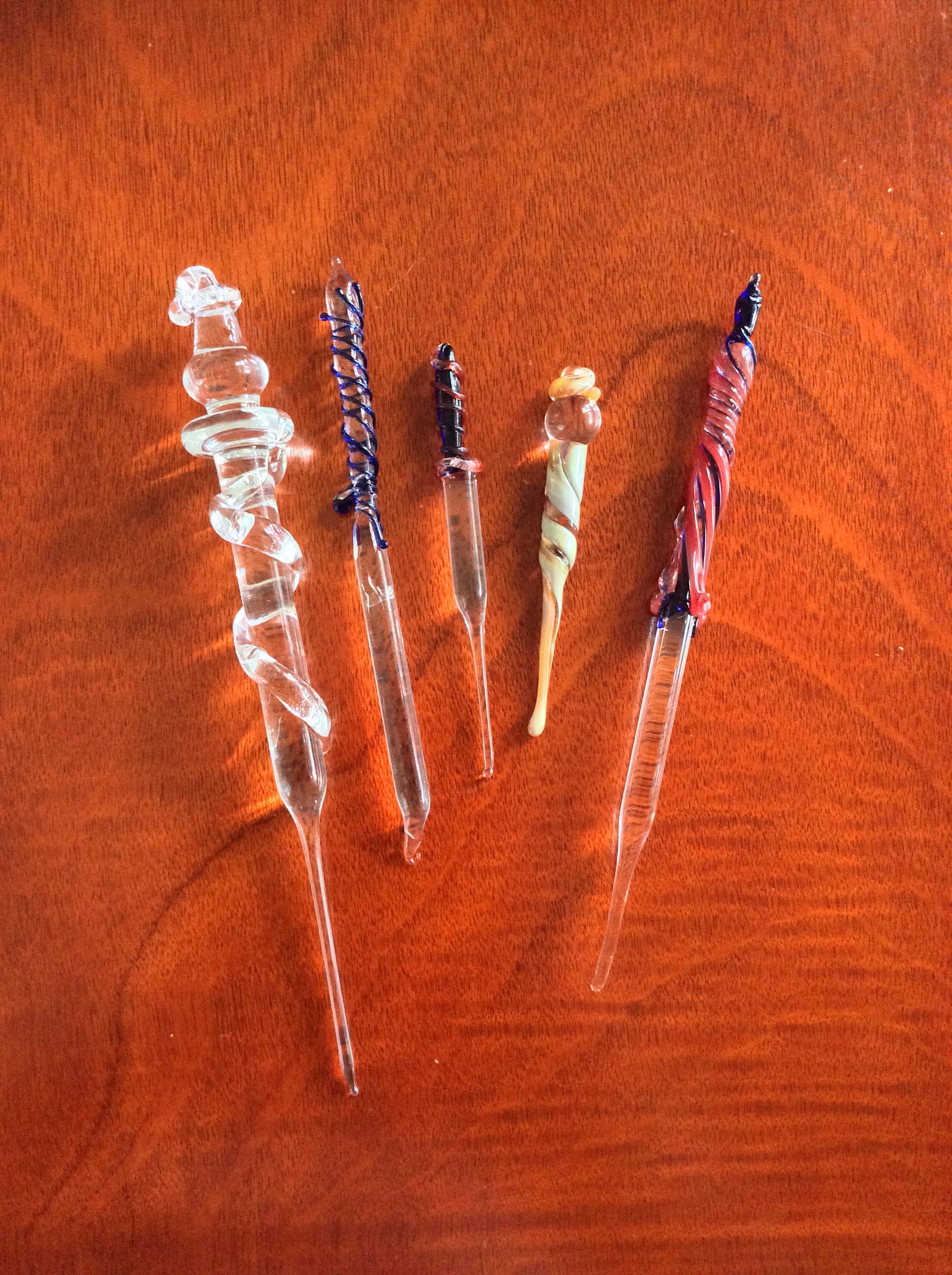

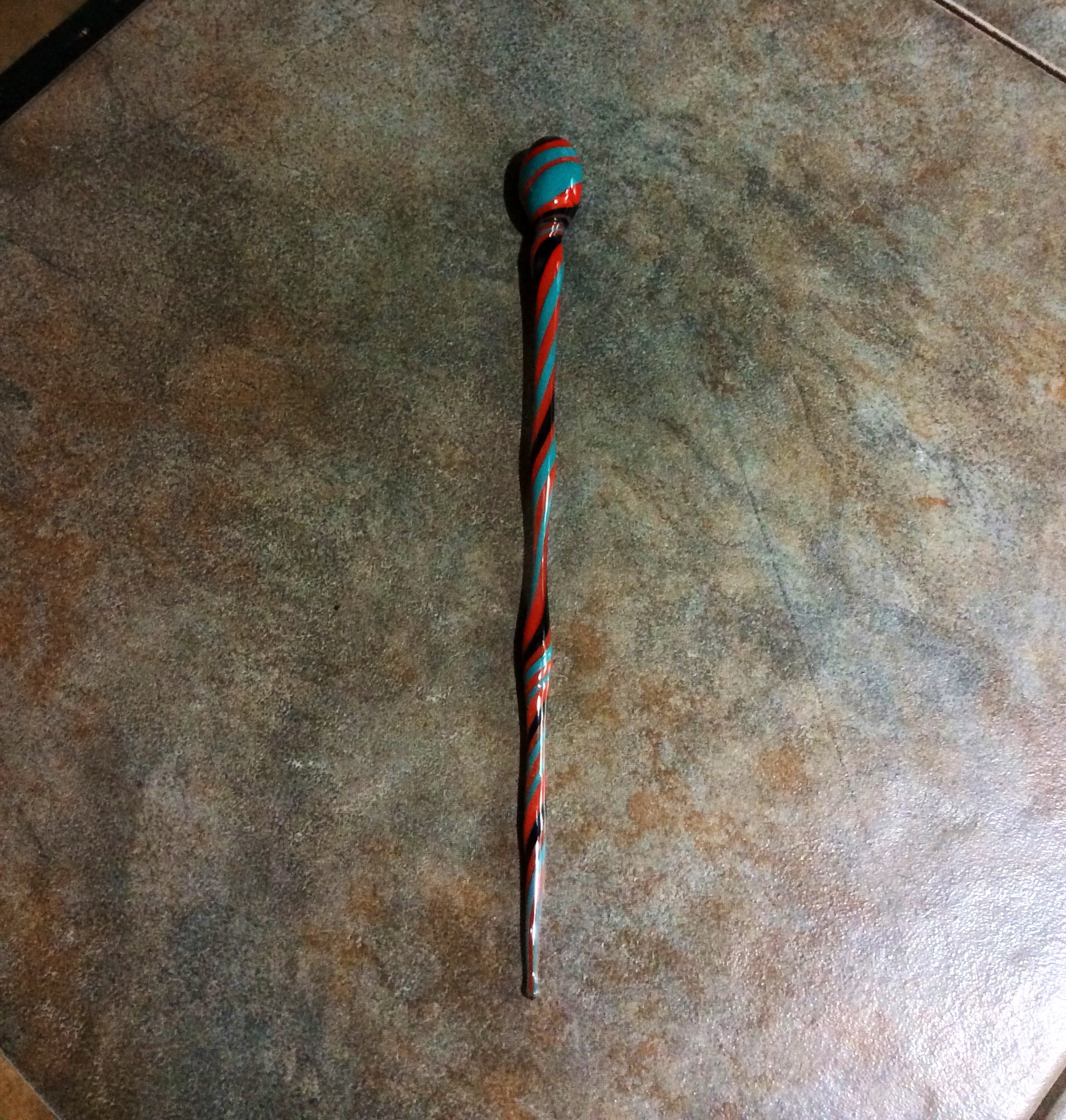

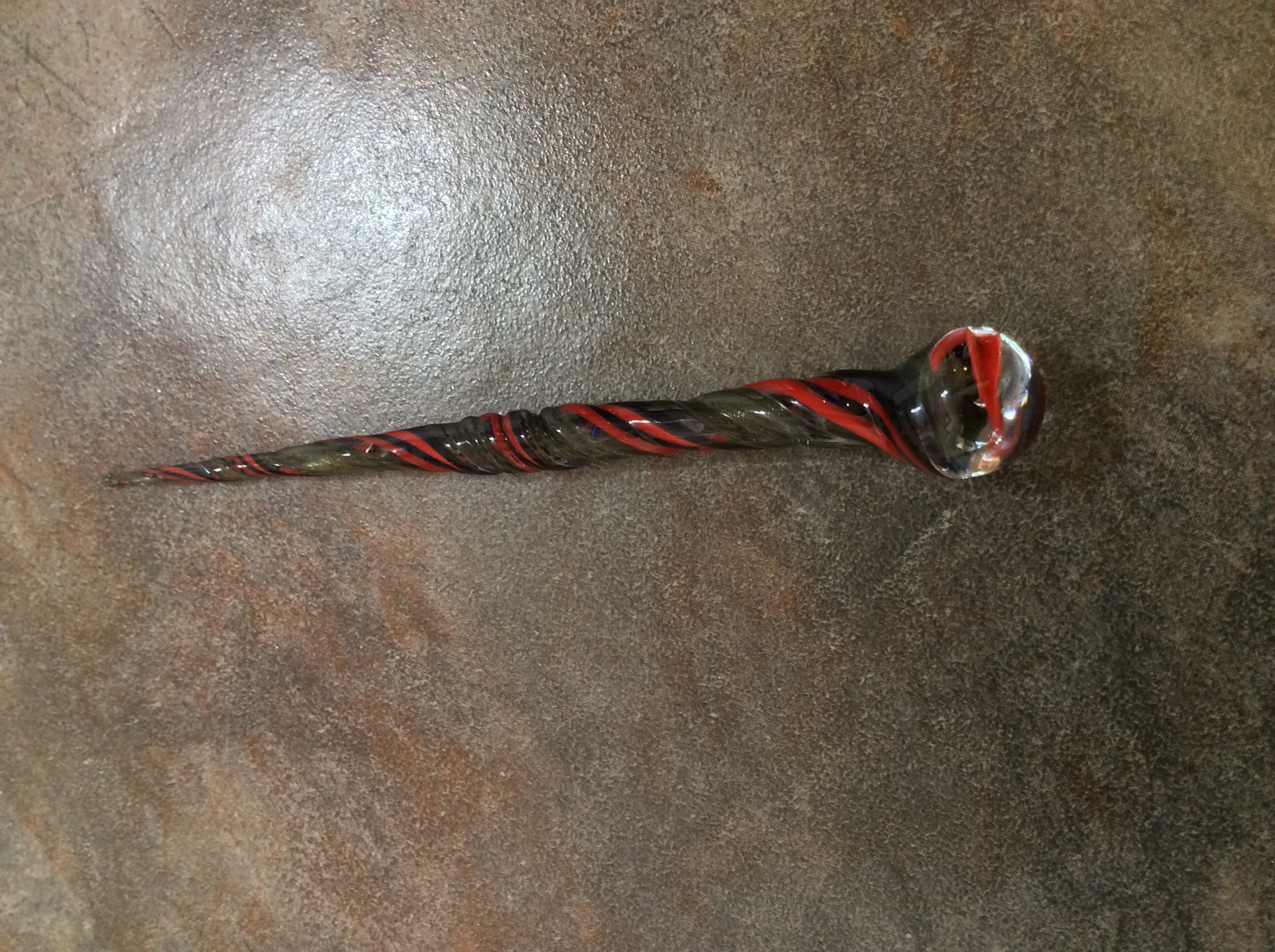

Also made a litter dabber, prob a bit to thin for comfortable use, but fun to use some color!
Attachment 70990

The trick to the angled bowl push is hold the blow tube up at a 45 degree angle when you push your bowls. Keep it up buddy

^^FYI if you get tools from arrowspring they fix free.I got one of the kilns randomly and like better than the big names.

props! exciting stuff. looks like you're starting off right using clear and setting achievable goals. you seem very patient and disciplined.. a lot more so than i can say for myself anyways. subscribed. keep it coming! this thread is going to blow its cap in no time. as for the reamer - i ruined a graphite skull by using it while the glass was too cold. remember you should never have to FORCE anything. especially graphite. just remember your delicate pencil lead in grade school when you were taking that important test and that mean nun wouldn't let you get up to sharpen it if you broke it because men are dirty rotten cheaters and probably up to no good...
what were we talking about? oh yeah.. marver/ream when its still hot and moves. if you're having to push very hard, you're probably working it too cold. I'm still new to this as well, so this is beginner advice, but these are problems that i have run into as well. looking forward to more pics. cheers!

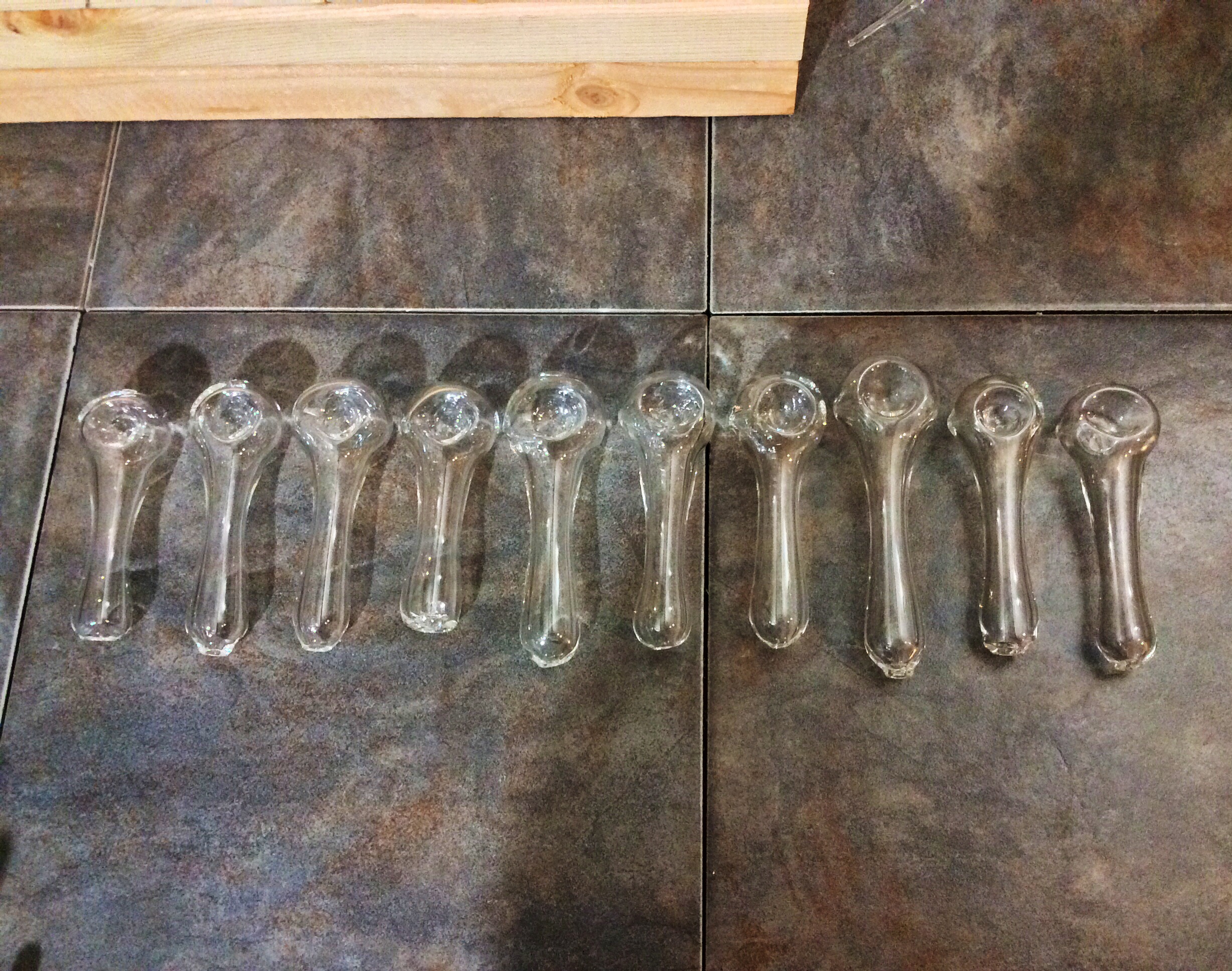

And fifty. Definitely more consistent on shaping, but still much work to be done. It will be fun to start making some with color. I'm thinking it will also help show flaws and areas to focus on...

Big thanks James! Totally was spacing on this! Didn't get all of my last pushes great, but this was def part of the problem.

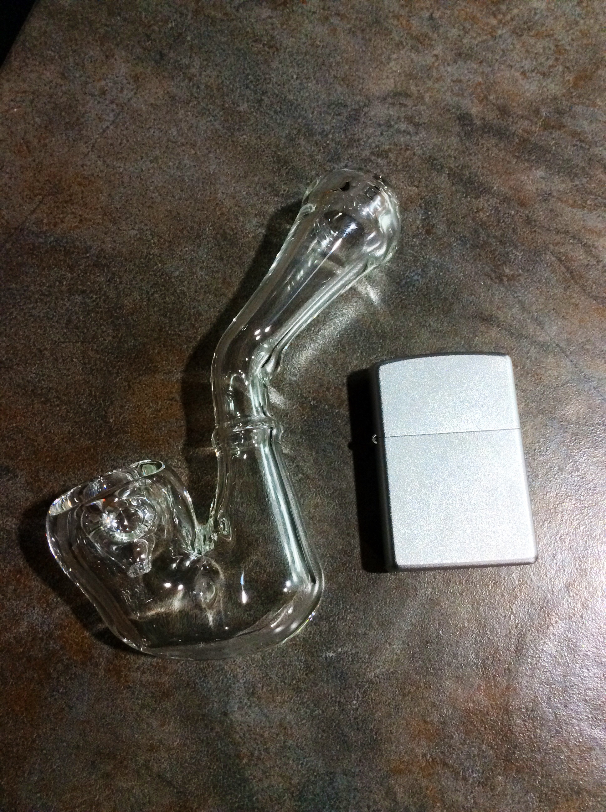

So with hitting my little goal, I decided to push my limit. 1st attempt sherlock. Pretty much followed (or tried to) the Revere video exactly. My seal def had some gaps, and it was tough bringing it together, condensing, and reshaping. Felt good to struggle and make it to the end though :)

Another little dabber, this one a bit more usable.

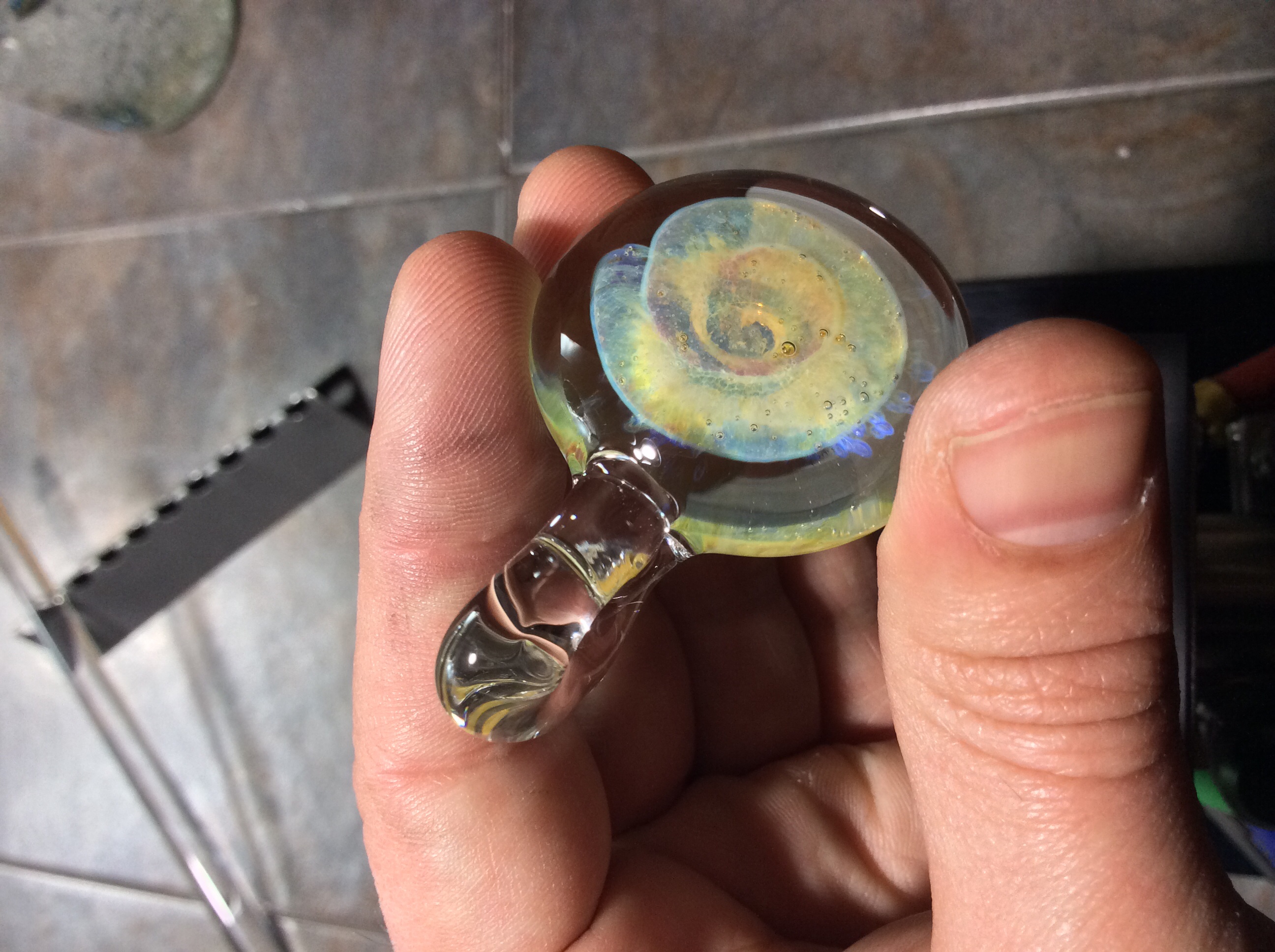

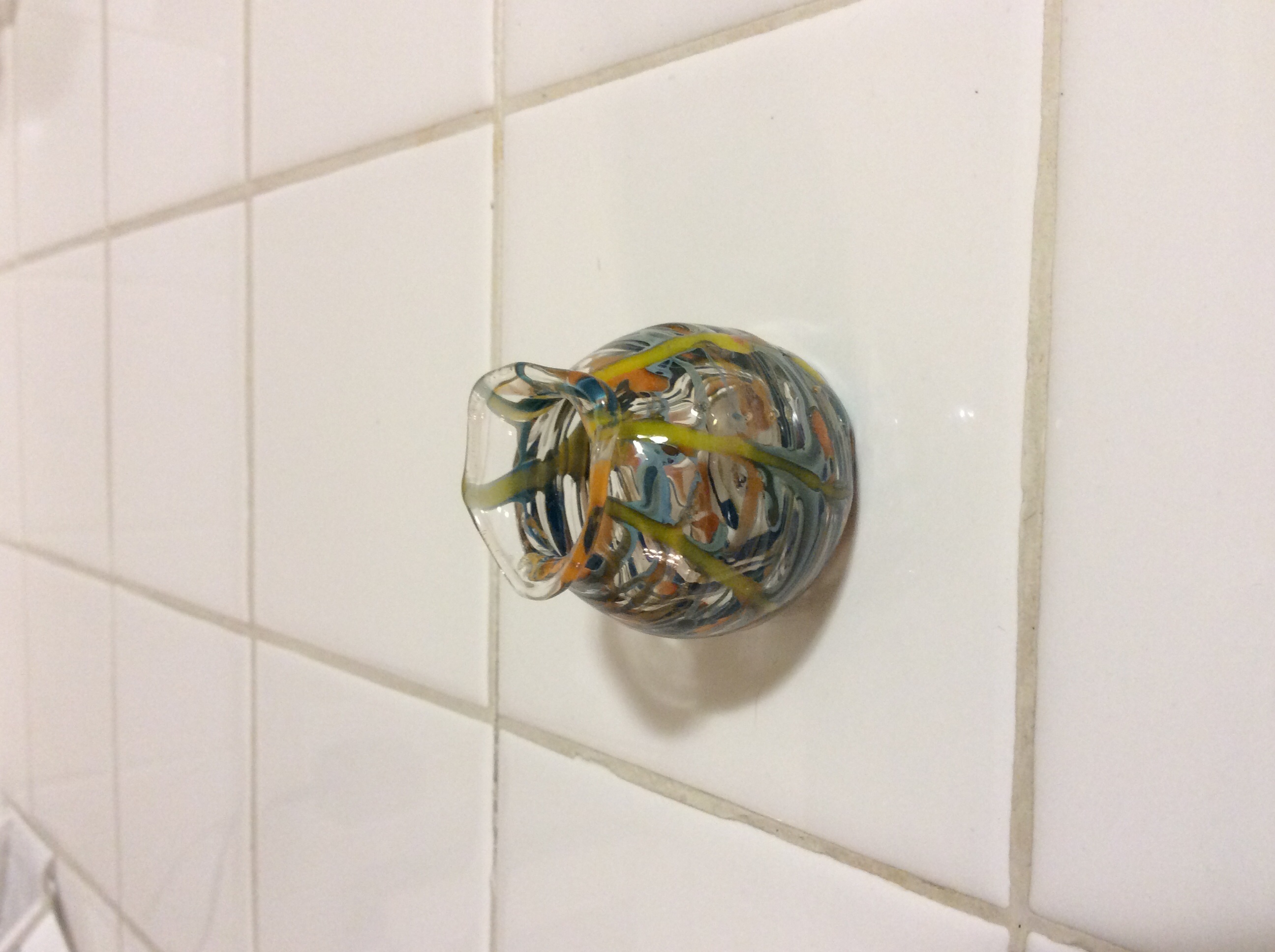

Tried a frit implosion, with really no idea what it would look like. This one was nothing great, but it gave me some cool ideas to experiment with.
Attachment 71477
That's all the updates for now. Thanks for looking!

Nice work! I was not expecting that on the frit implosion mine usually come out looking like a sea urchin or a kidney stone or something really spikey. What type frit did you use? Superfine ? Powder?
Thanks paulsafo. It was GA triple passion (small). I covered the face and then laid down a spiral of clear.

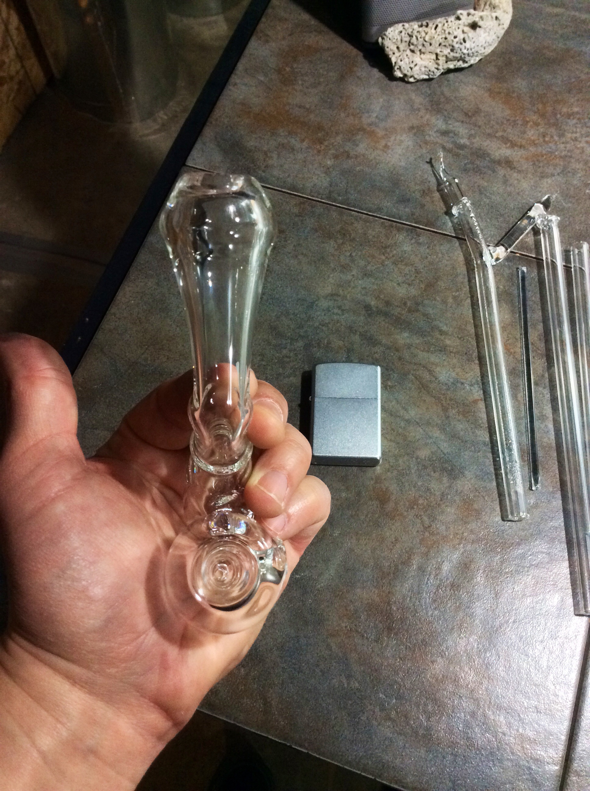

Tried a single piece sherly.
Attachment 71604

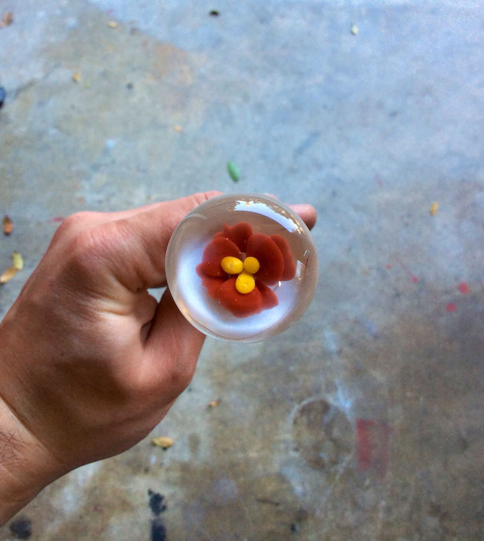

First flower implosion. The colors are a bit drowned out bc I snapped a pic before it completely cooled (waiting on kiln) in anticipation of a crack.
Attachment 71606
