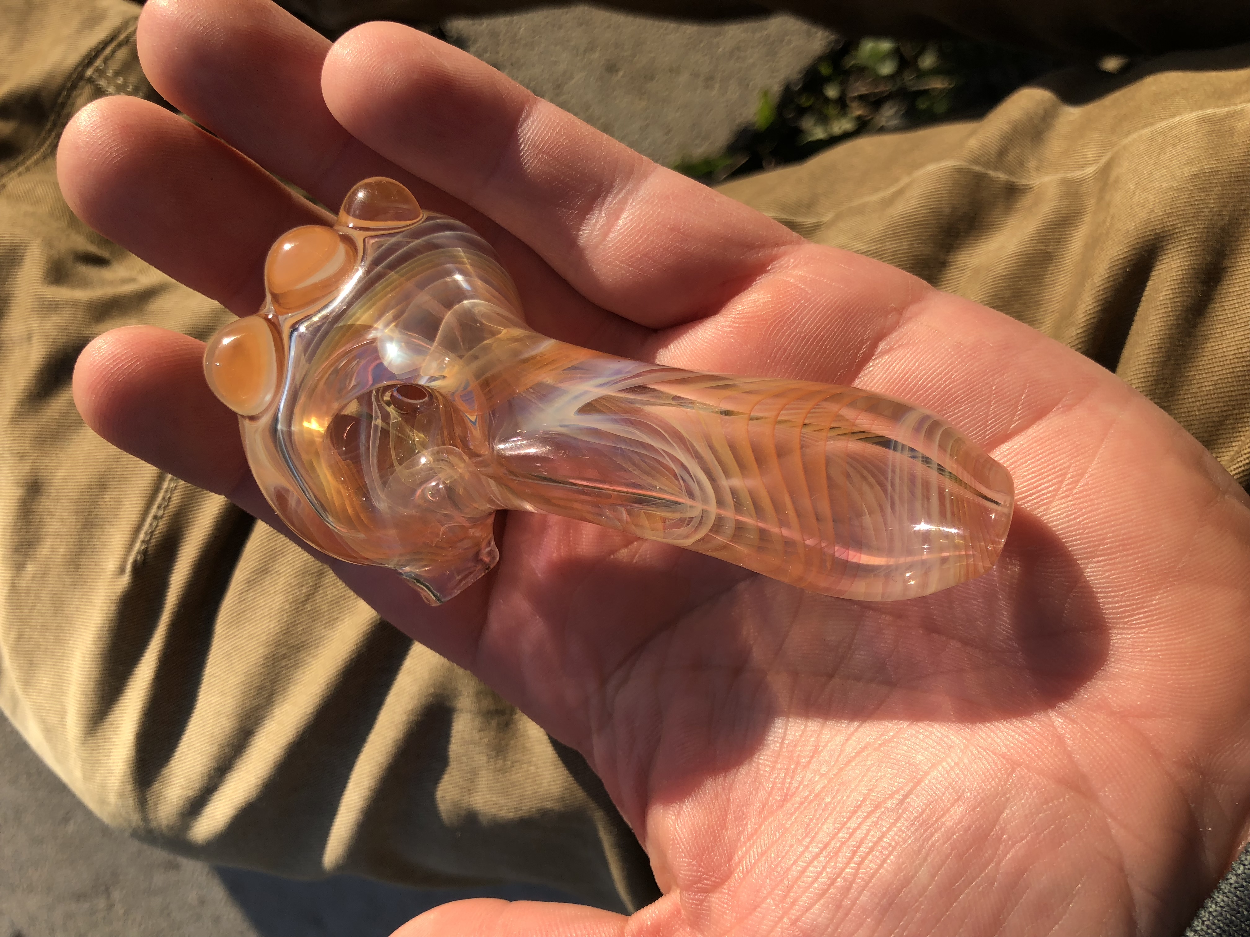

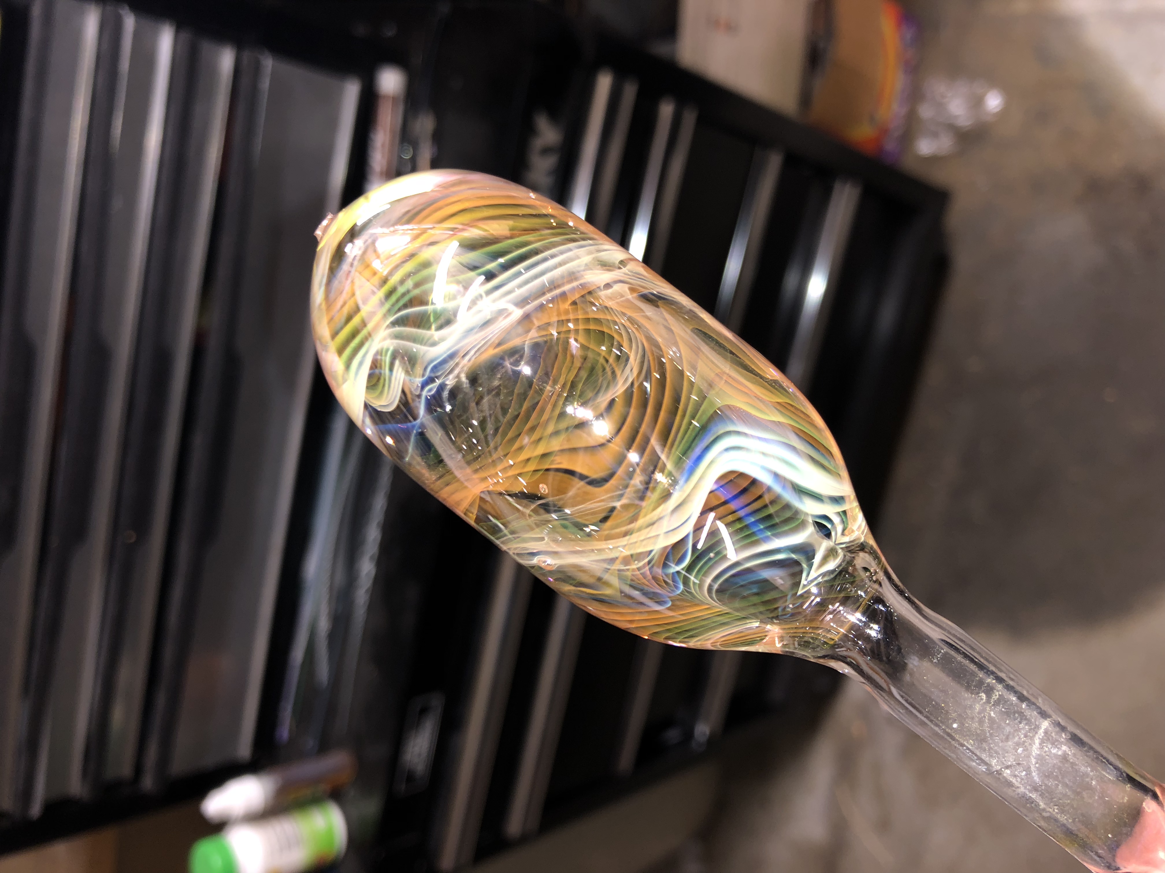

Here’s what all those pipes look like, I guess the first pic doesn’t show any detail.
Nice W&W. Sup with a lesson :)
I can live stream one on ig for ya. Hm... maybe a w&r photo tutorial thread, that could be fun. The short story is I get as many wraps, as close together as possible(without touching) than rake with 4mm again, as close as possible. This one is all raked the same direction. I’ve been able to control the pattern better that way recently. Although it means I probably need to work on my back and forth takes!
Nice color fade for sure. I'm a sucker for fume :)
Here would be awesome. I don't do IG.
I’ll take a bunch of pics tonight I’m gonna soon another few up
