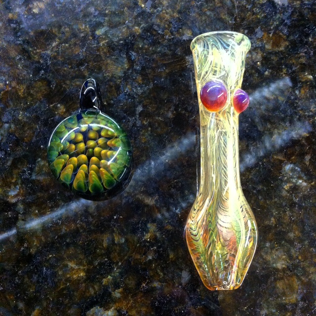

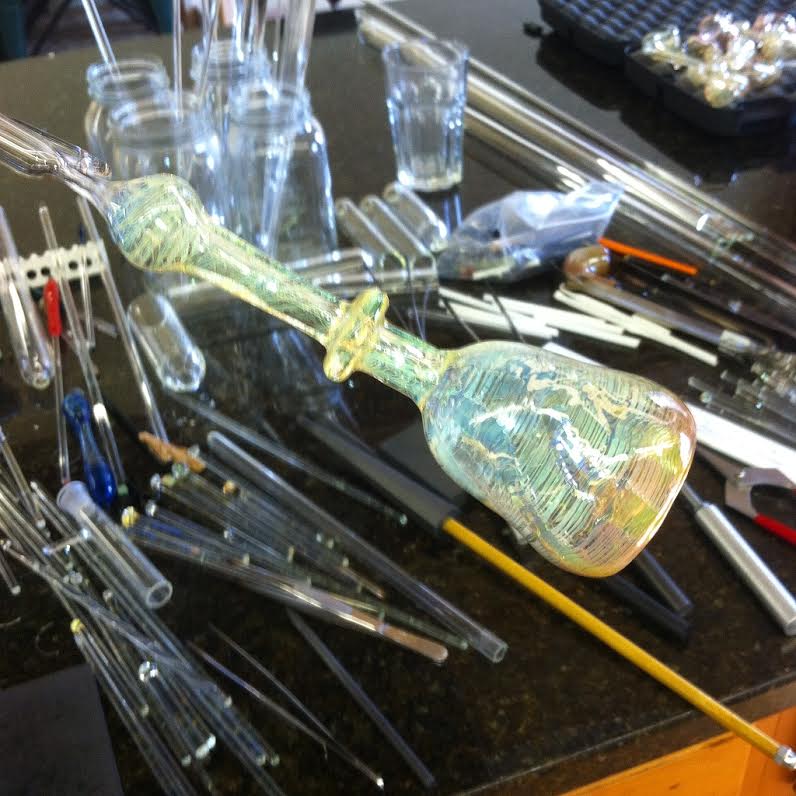

I'll have to try and use it as a marver. I just got a dm on instagram someone wants 5 of these. Said they aren't a retailer and is just digging this tube. I'm not sure what tubes go for but this last one is maybe 6-7 inches. With the marble what do you guys think these would retail for? I'm not sure I want to do retail sales yet I think I would prefer wholesale orders. Any advice guys? My tubes are still a little sloppy too
http://tapatalk.imageshack.com/v2/15...4fca4517e4.jpg

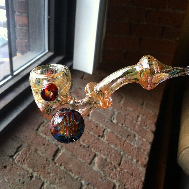

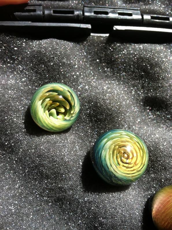

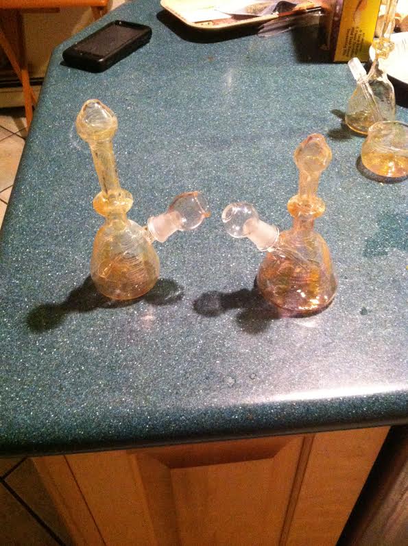

some marbles for attachments. fumed implosion pendy and fumed wrap and rake for a friend.
Attachment 72821
Attachment 72822

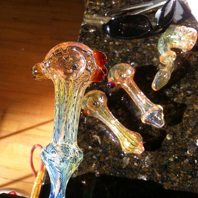

Thanks Jxbey. I haven't sold any mini tubes yet because I am not completely happy with them yet. I have been focusing mainly on fuming lately which I am loving more and more everyday. Heres some recent pics.

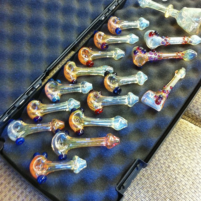

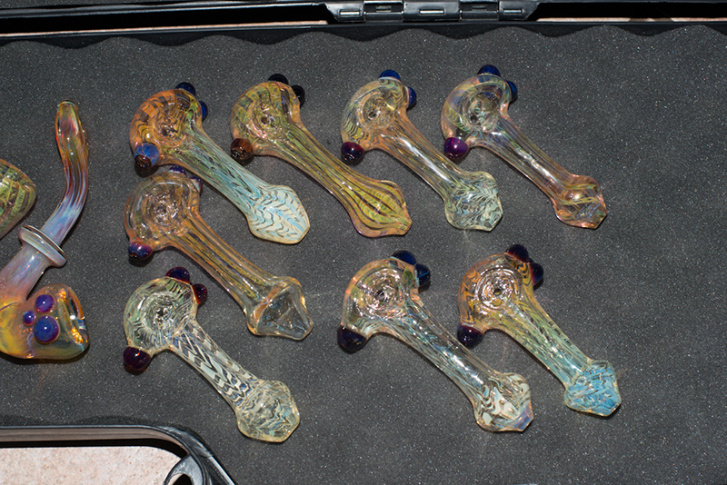

I posted these in fume but I am going to post them here as well. What I have been working on lately. I love fuming but I am getting shut down on the prices I am going after here. Maybe it's just because all the shops are stocked for the 420 or whatever but I spend a decent amount of time on these. My spoons are taking between 25-30 minutes and my sherlocks are taking me about 50 minutes if i am in the groove. I am just slow and I am having trouble selling these. $15 for the spoons and $25 for the sherlocks. I have overhead and I am barely making it by. This is so frustrating. I had a shop owner tell me today that my spoons are worth 10 and my sherlocks 15. How do I make these faster? Anyway sorry for the rant but I am putting a lot of effort into these and I have a decent amount of overhead. Blah whatever.
Attachment 73808Attachment 73809Attachment 73810Attachment 73811Attachment 73812

Are you fuming with gold and silver to get those colors or just silver?
Could you give me some tips on not burning up the silver?
Loving those sherlocks and the fume work, nice stuff man!
Thanks guys just sold everything. Montoya I use silver and gold to get the spectrum of colors. Silver will get you blue and gold will get you the pinkish red. I overlay gold over silver on my blank to get the yellows and greens. As far as not burning the silver up I am using my smith hand torch to fume silver and I get a lot more control so my silver lasts longer. Try not to use too much of a reduction flame. The trick to silver is less, you want a yellowish color. I do multiple layers of silver instead of one heavy coat. Hope that helps.
