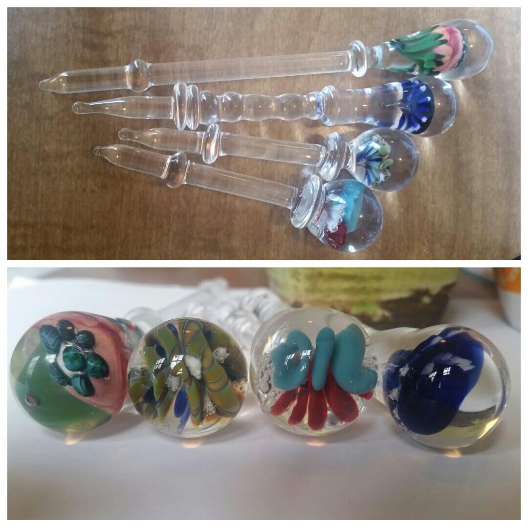

Had a couple of stressful weeks with personal issues. Finally back on the torch regularly. These were a nice break from working with hollows.
Just got messaged for a wholesale quote....how much would you charge per dabber that seems reasonable?
ive done 5$ on simple ones those implosion ones id say 7ish for sure on the 710 oil one thats sick nice work, thats just what i would offer. shops in area like my prices thats why im able to sell to them it depends on how many they want to buy,the more the cheaper. i look at it as an investment on my end to let things go for a good price because if im happy and they are happy chances are they will be a returning customer. my prices are crazy low compared to other beginners in the area but im buidling relationships so once my work is quality i will be able to get the prices i want on pieces. is it a local shop or someone contacted you threw interwebs
That's what I was aiming for. Agreed at 35$ for 5 so I'm happy. The attracted attention from people selling my items online getting my name out there is as valuable as the money at this point.
Thanks for the input and appreciation!
