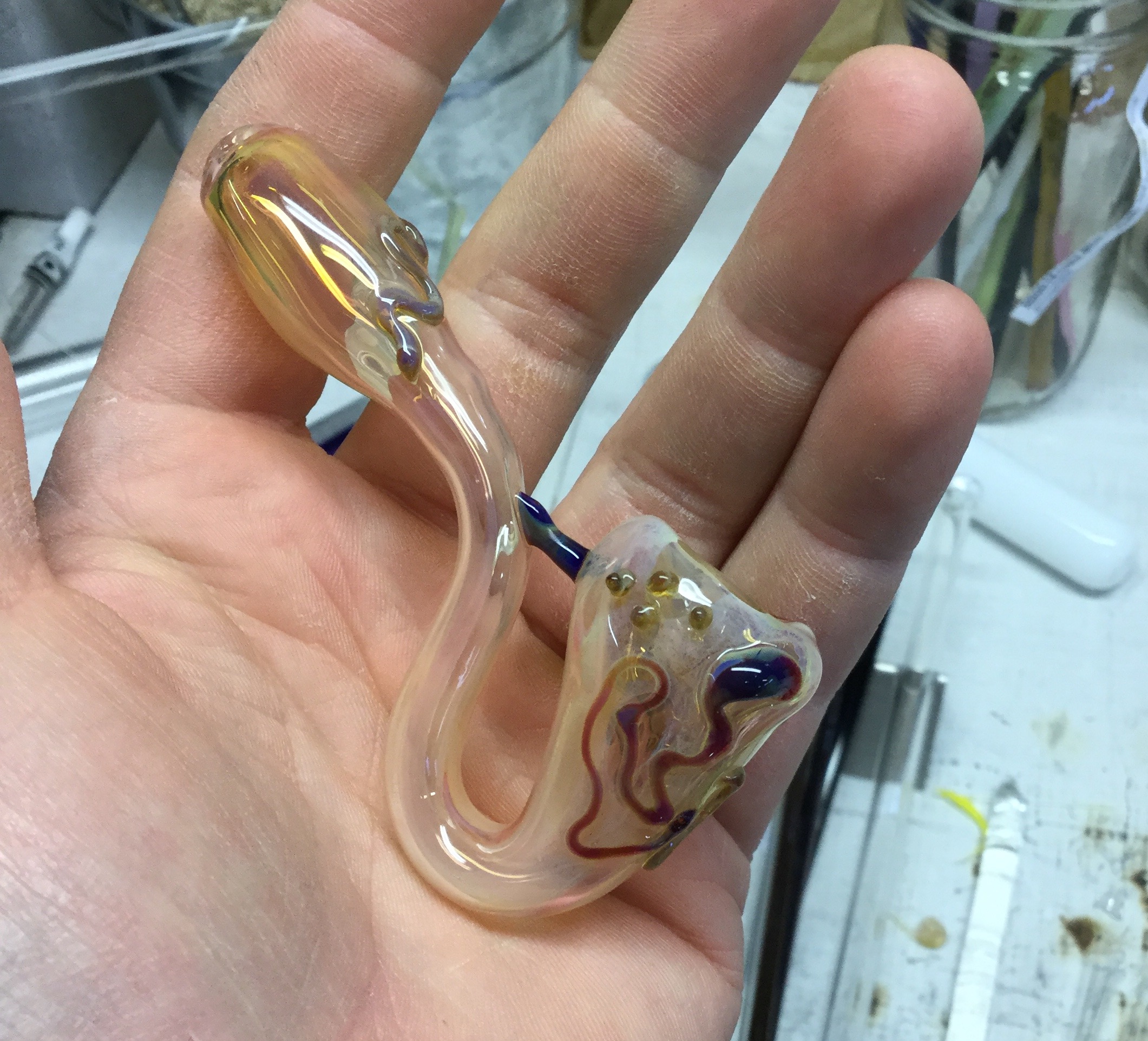

This started much bigger but it got too hot and the neck collapsed shut on the pull. I salvaged the mouth end and made this lil burner out of it. It came out better than the plans I had for the original!

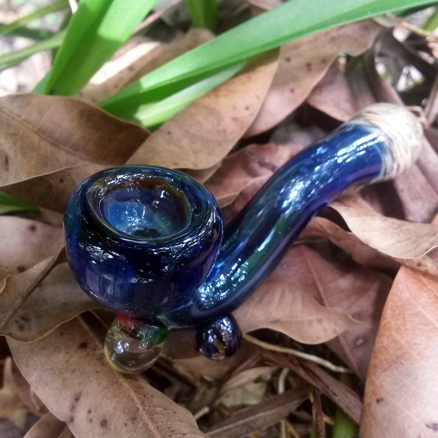

Blue Caramel frit w/ gold fume and English Ivy accents

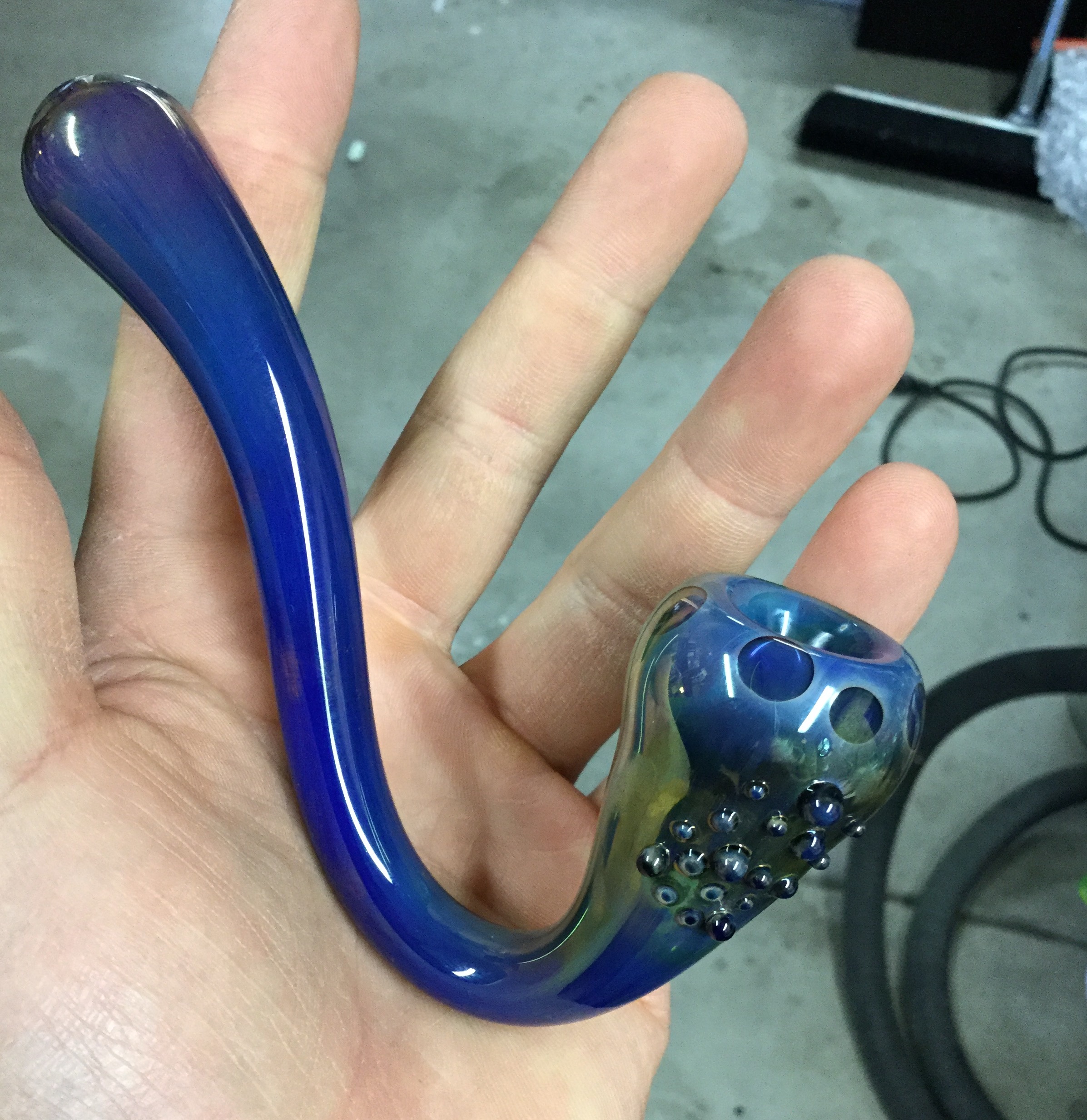

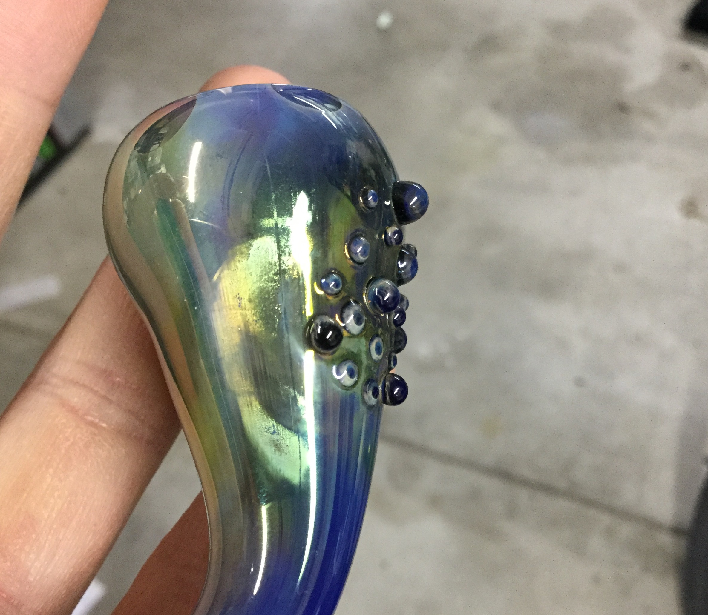

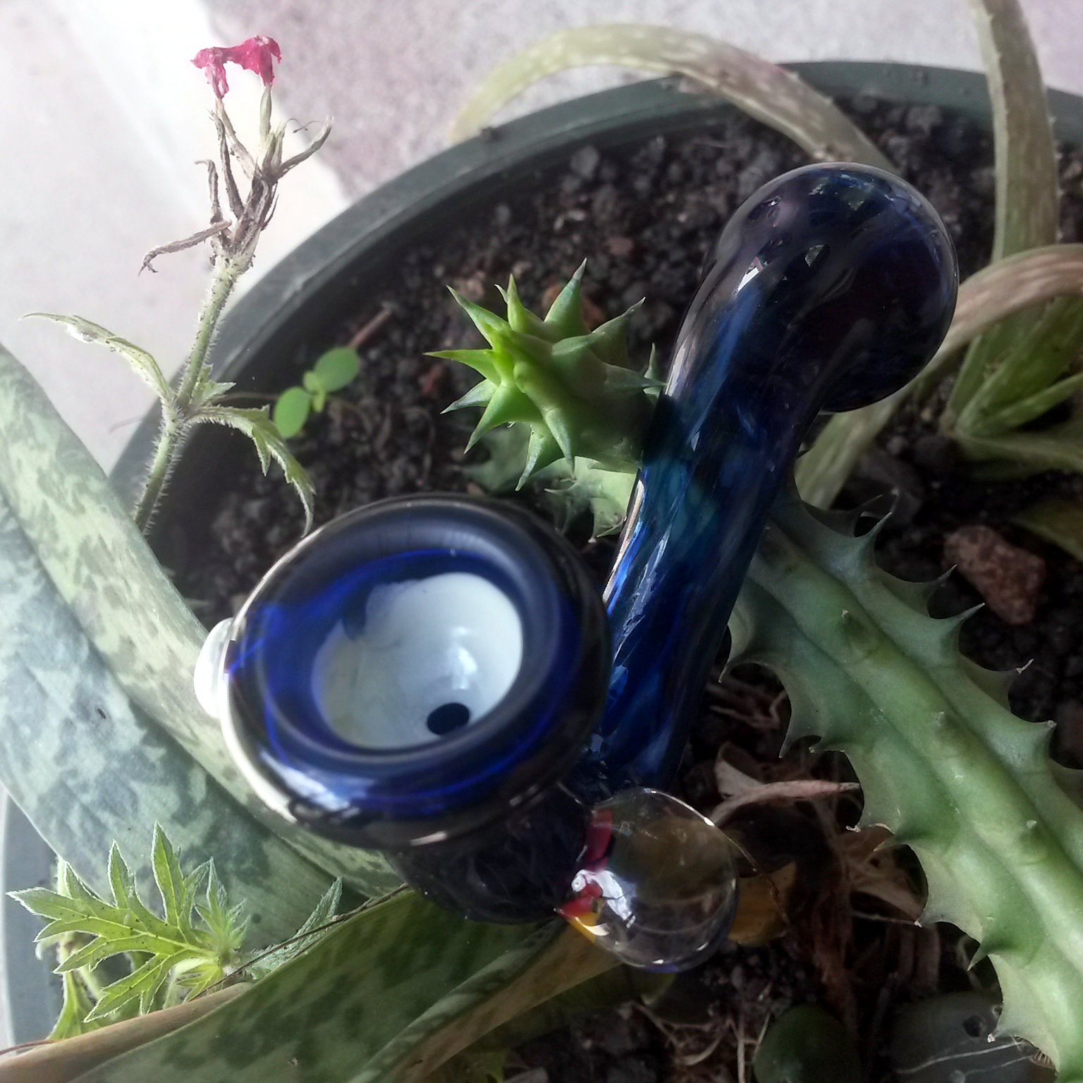

I could use some input on this one also. To the left of the dots is a "C" shaped area that "crystallized" when i was melting in the dots. Is this what is called "skuzz"? It only happened where it got hot like this and not where the flame was directly pointed but the side of the flame. I had what i believe was oxidizing flame (dots are Aquatic Carnival so trying to keep it from hazing).
I have had glass frost on me before and usually can heat it and smooth it back out but this didn't want to clear up. Is it the silver or cobalt? I have nor done much with cobalt and know it requires heat so it's a balance against burning off the silver. Not sure what i should do on the next one to avoid this, any tips or advice on fuming blue? Much appreciated.
Other than this skuzz it's a nice piece but not sure if good enough to sell with the crusty spot.
Attachment 87124
Almost looks like the glass was dirty, burnt something in. Cover it with opaque dots or a marble of something? Did it look like it was boiling in the flame? Maybe keep trying to get it hotter if it's not boiling or looking worse.
Dirty glass! That may be it. Did not see any boiling, it wasn't that hot, but it did seem to appear from nowhere. This was chinese tube that had been on the bench for a while so it may have been scuffed up a bit. Very little experience with color tube. I'll work more of the remaining tube in the same way and see if i can do it again (ugh) to narrow down the cause.
Too much 02 and it can scuzz?
http://www.talkglass.com/forum/showt...+fume+heavy+02
Thanks for the link BoRo.
I found last nite on a second piece that the high oxy flame seemed to cook the fume as I showed but then with a softer fuel flame I was able to polish it out.
I did not get the crust on the pull but after adding dots/deco, it came when I heated the piece to melt the dots in. I have not experimented with changing gas/oxy pressures at the regulators. I'm using a Mirage at 30/5 psi (have to confirm those tonite) and so far most stuff works fine. Not sure i'm good enough with glass to be confident changing regulator pressures will affect results as much as my lack of experience. I usually get decent fume results without going back to do detail work, this is somewhat new tech for me.
It's almost unnoticeable to the novice blower.
Your flames seem the same.
The knobs just become more sensitive at higher pressure.
Sometimes you can see a slightly better end product from the right pressures.

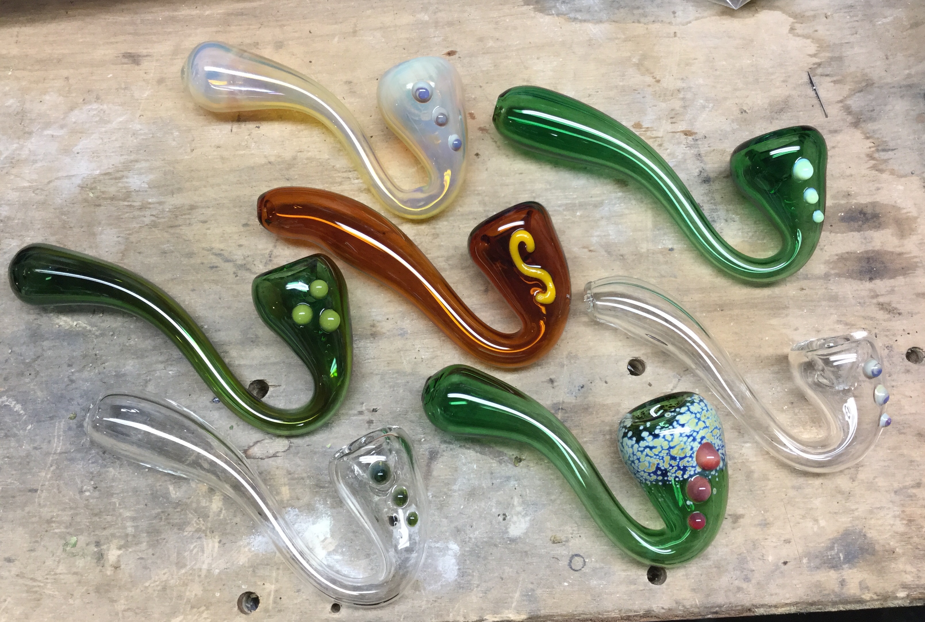

My dispensary wasn't interested in any spoons but wanted cheap sherlocks so I got after them a lil bit more. This week has been a cluster and ran out of oxy so no melt for the last few days. I did some of these on points and some on tubes, tubes are easier for me for these. I don't have the experience with points to feel totally comfortable pulling and bending so I overthink it and lose my groove. Came out pretty good, couple wonky mouthpieces but I'll hit it again this weekend, they want 25 next thursday.

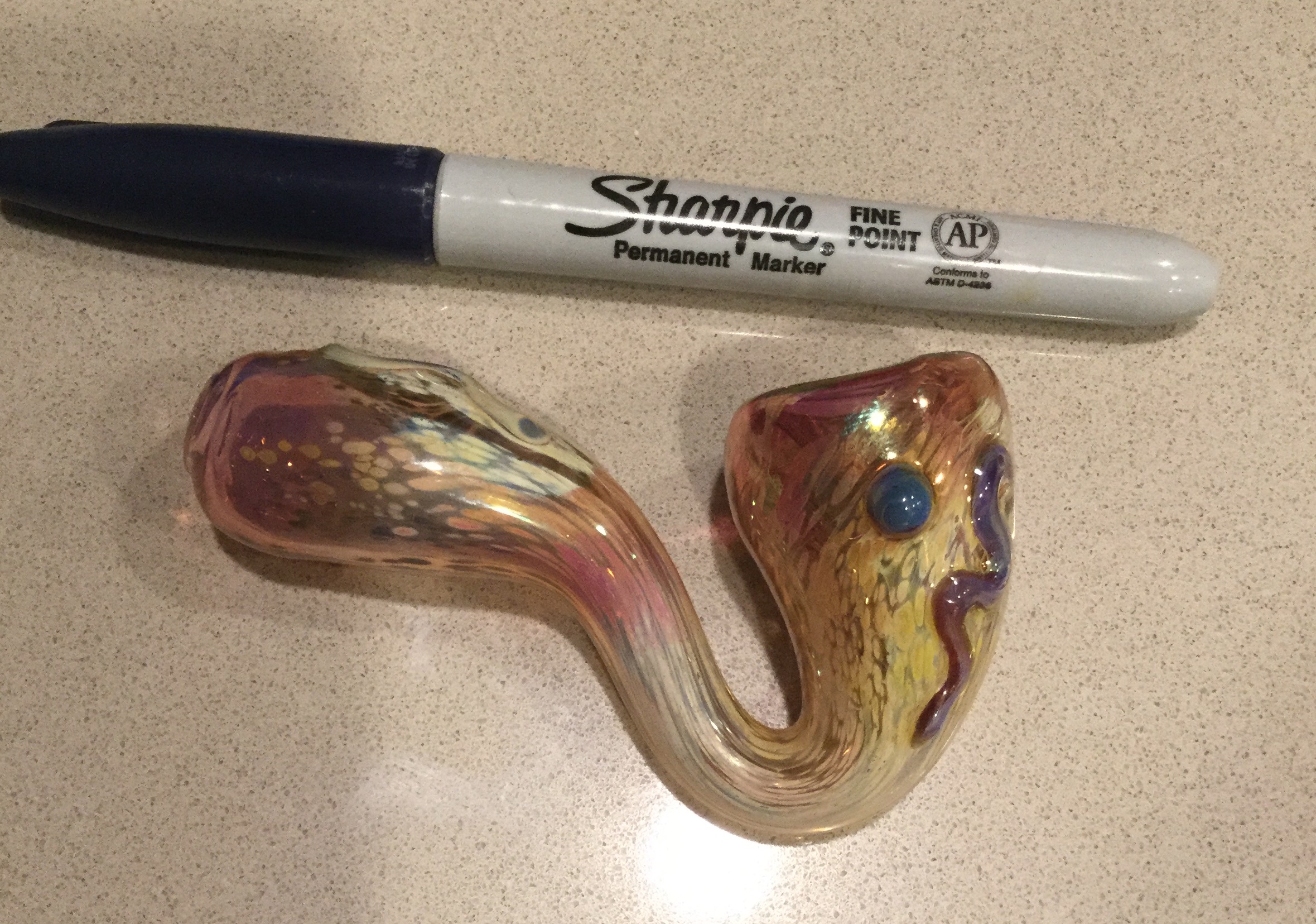

Coming on good there. I see you got it, here's mine...
I know Aymie's wonderful cleavage makes it hard to focus but I do the same, except that;
Mouthpiece is done and attached, then I cut off the blank (25.4, same as you) to work on.
The punty is in the left hand and I have a blowhose & swivel on the right.
The blank is rotated in the flame with axis horizontal and about 30 degrees to flame axis, looking down on it. This gives a nice spread of soaked in heat.
Take it out the flame, puff pull and shape all in one movement.
Do attachments and bowl work, remove from blowtube.
Everyone develops their favourite ways I guess :-)
