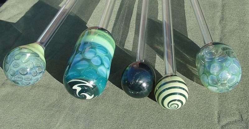

hi theese are sections i made for a customer wich will be assembled into a tube on the lathe by merlin bong
the customer picked the colourscheme
i hope he will be happy

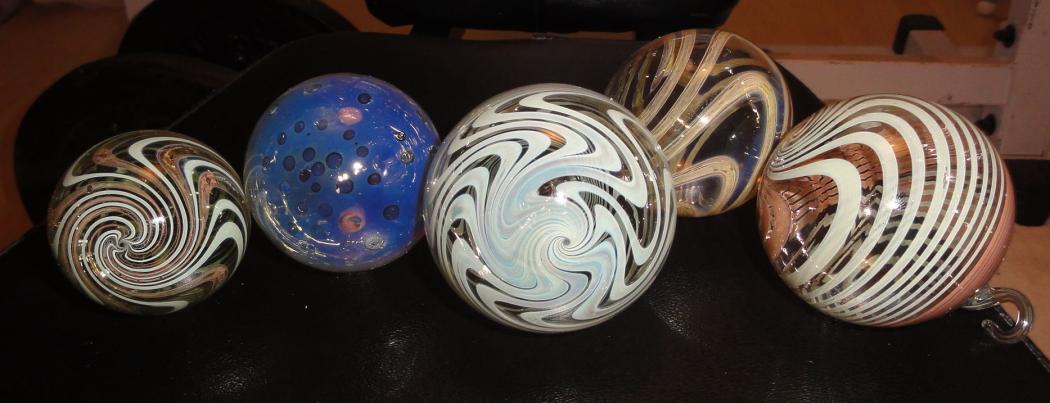

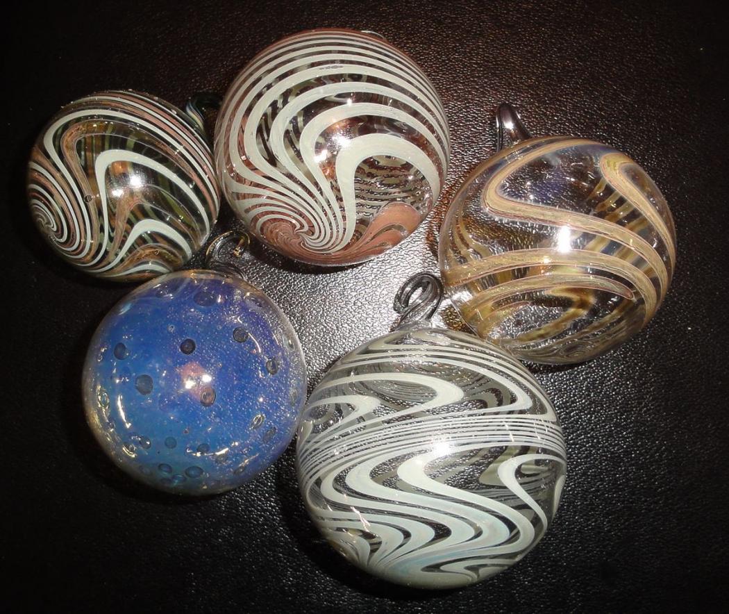

..had to make christmas ornaments, i had some real nice shapes but the meister said no just bubbles, lots of them, thin, closed and with a hook, theese are some i took home for the family
Attachment 44029
Attachment 44030
my safetyglasses were falling apart and werŽnt anymore comfortable the frame was damaged and burned etc , so i popped out the lenses, got old sunglasses and popped out the lenses there too for measurements, then i went to our grinders and sanded the old lenses so that they fit, voila new pair of safety glasses, and this frame even fits my head better than the old one
:D
Attachment 44031
kind regards from germany:shifty:
Re: steaks thread - progression
nice ornaments, and great job on the shade upgrade too.

Very nice! Love the wig wag Ornaments! And that's a creative solution to your glasses problem, They look great :D

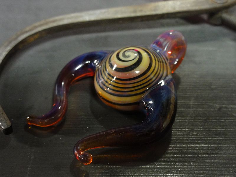

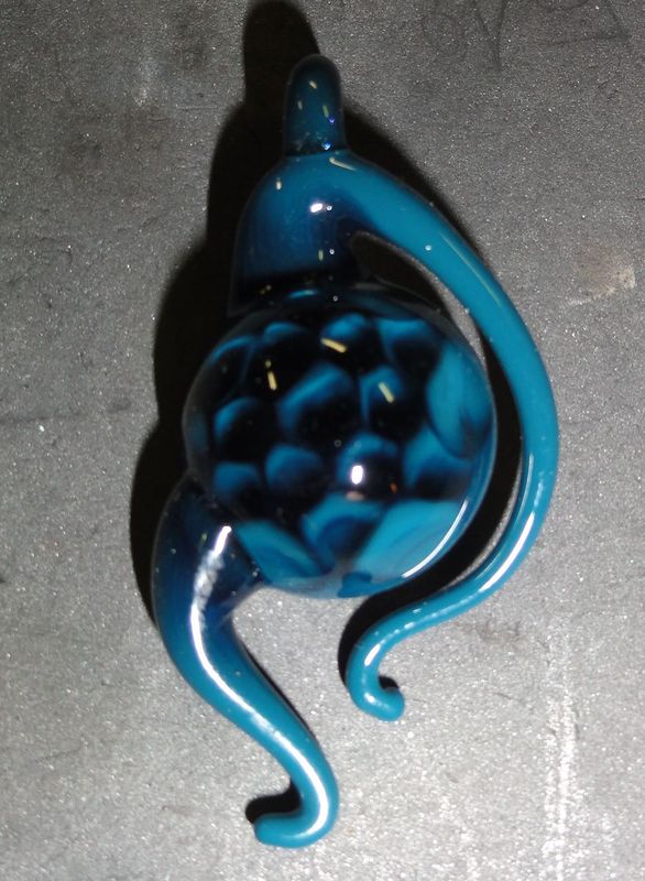

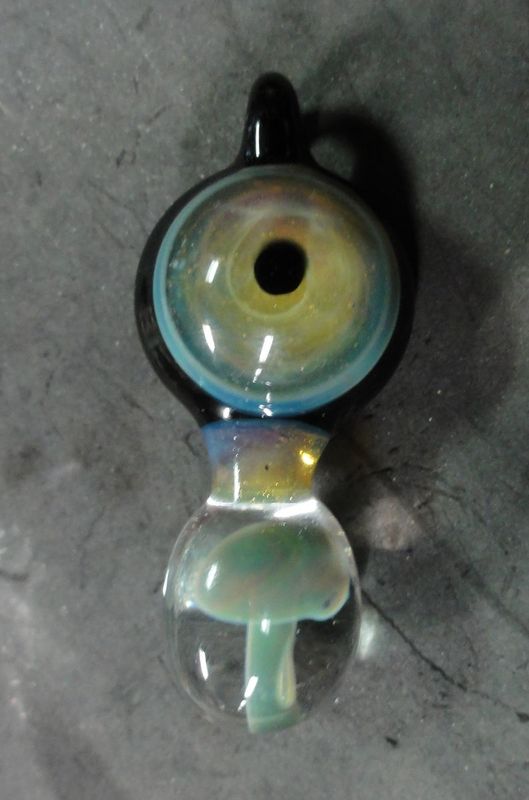

thank you for the nice words,
Attachment 44053
Attachment 44054
Attachment 44055
Attachment 44056
Attachment 44057
i starts snowing here in germany, greetings to you all :D

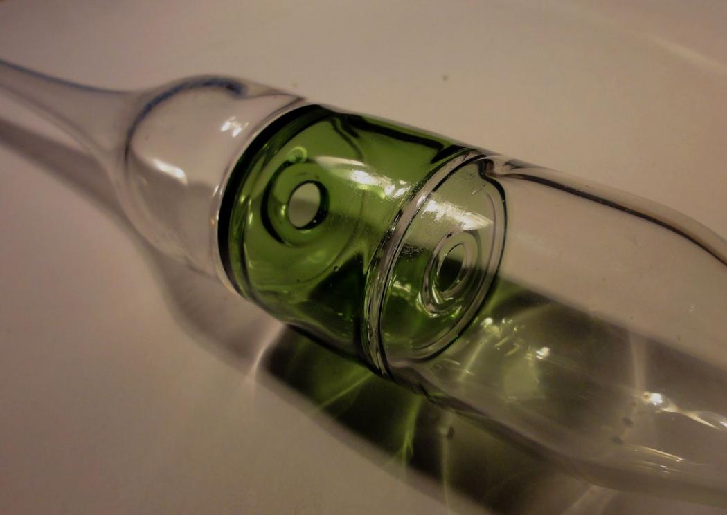

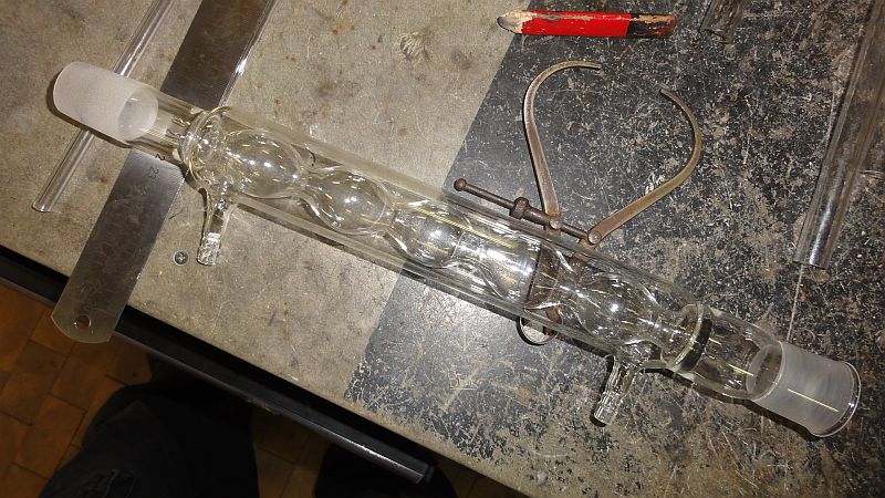

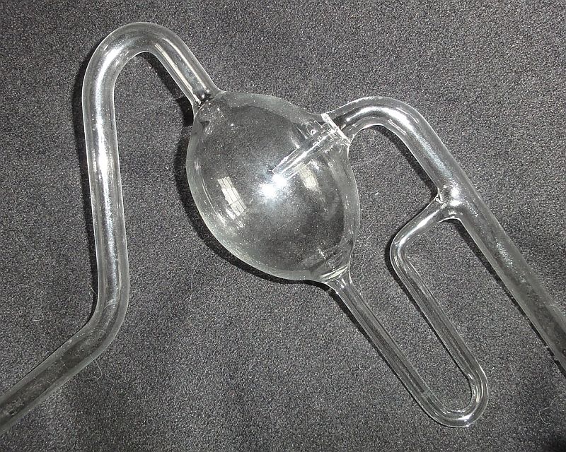

here is somethin from school but a fun one, i need to make 5 of theese discs in a row on 30mm std wall tubing
Attachment 44324
:D
neato, how did you do that?
cool art how about some pictures of your flame interested to see
pull points on 30mm tubing, real straight points, then make one side flat and pop a hole in it, put aside
take another point of 30mm tubing and pop a hole in the end and ream it open to tubing size and make a tiny flare like 1mm
so that it fits on the first point, then take both points and stick them together
then introduce to a tiny sharp flame and melt the flare onto the edge of the point with the hole
roll on marver if desired and blow into
you want to have it like a 30mm tubing with no ridges where the disc is
then take off the point and make it flat again, pop hole and so on
it takes a little practice to get nice thin discs wich are not too chunky
and a bit more practice to make lots of them in a row wich should look all the same , and still be straight when you spin the point, in your hands
my task ist 5 discs in a row with a centered 4 mm hole in each one, each disc is 20mm spaced apart from the other ones, the discs should as thick as the wall thickness of the used tube, and my teachers are picky so i make a lot just to practice :D
flame pics, i use a 40mm herbert arnold running on natural gas(in school at home on propane) and oxi and compressed air, for the discs i use a tiny sharp flame like 5mm wide

thats a sweet lesson with all sorts of skills involved. your teachers sound really good
