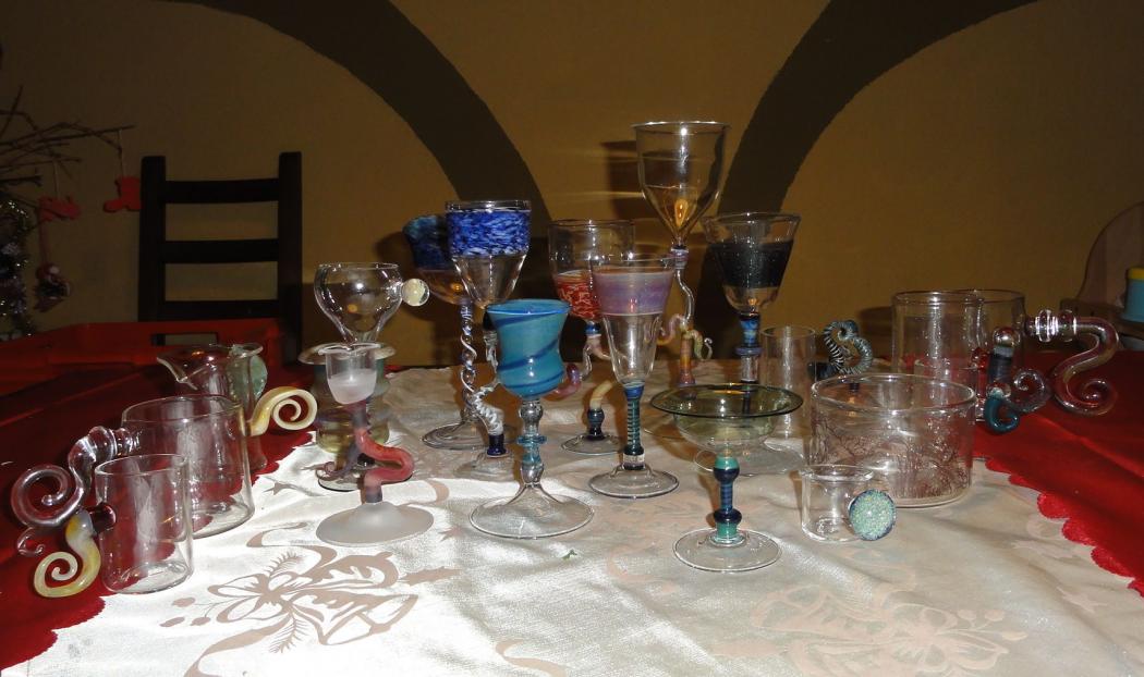

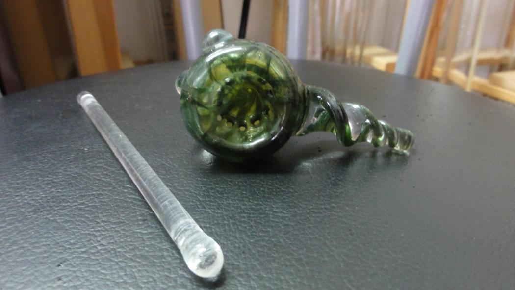

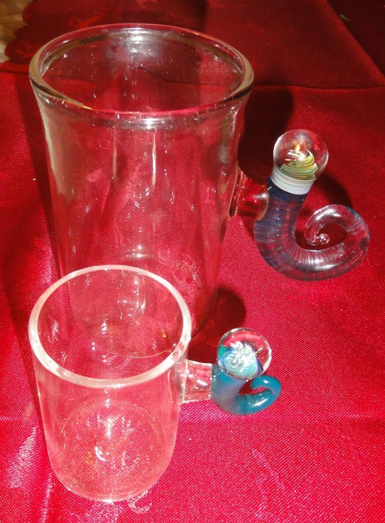

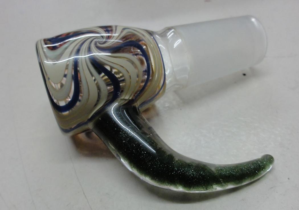

i made gifts for the family i thought id share the pics before wrapping them up
Attachment 44572
Attachment 44573
Attachment 44574
i hope you like
:D
Very nice, should be some happy family members this holiday season.

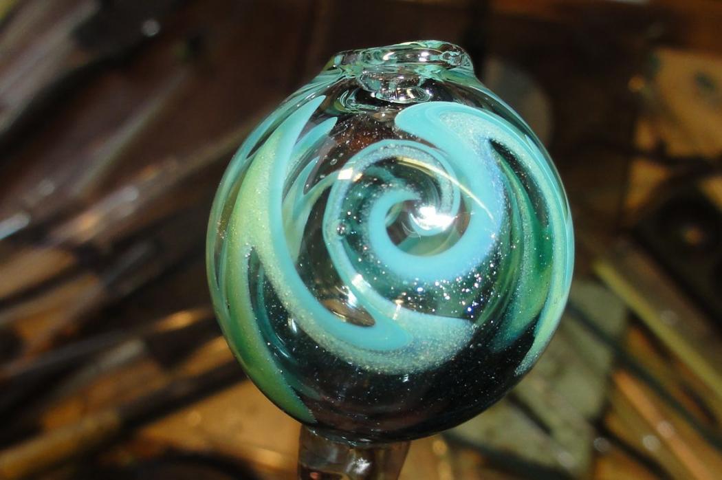

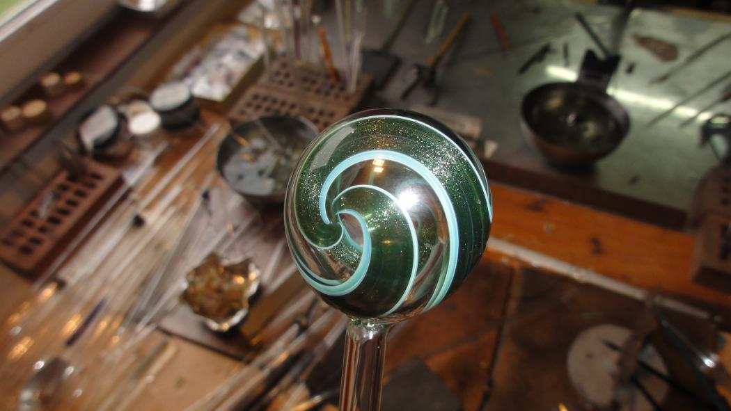

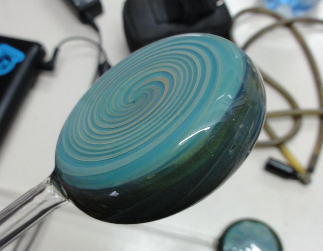

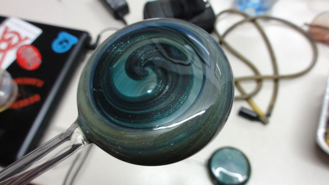

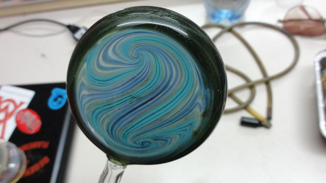

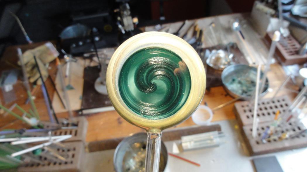

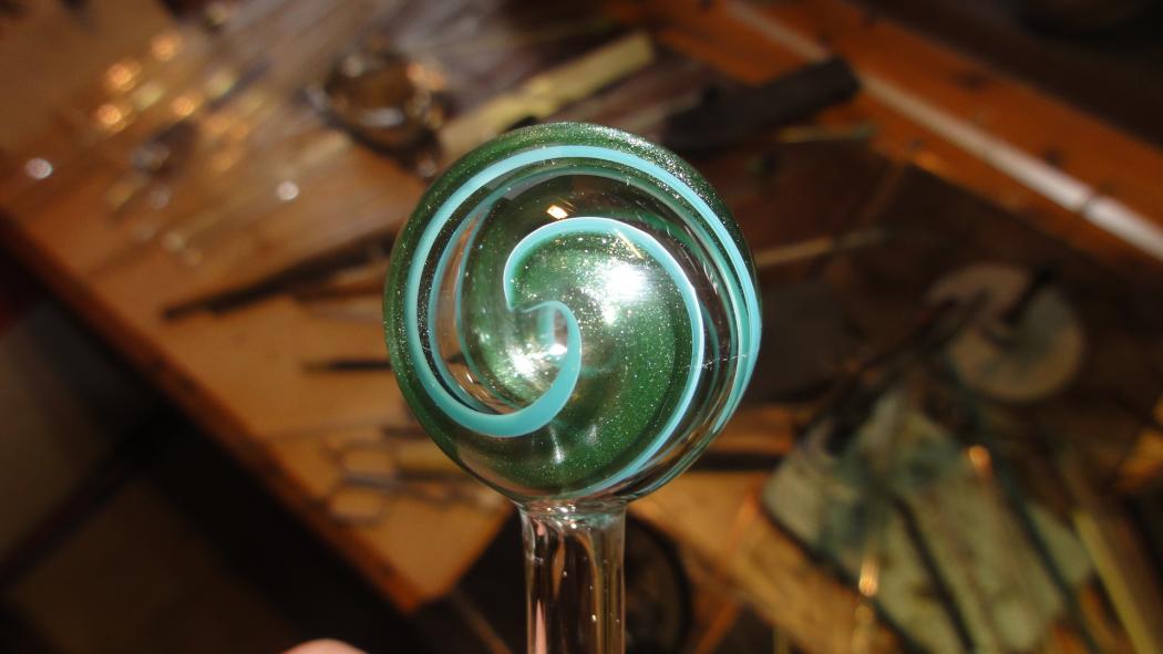

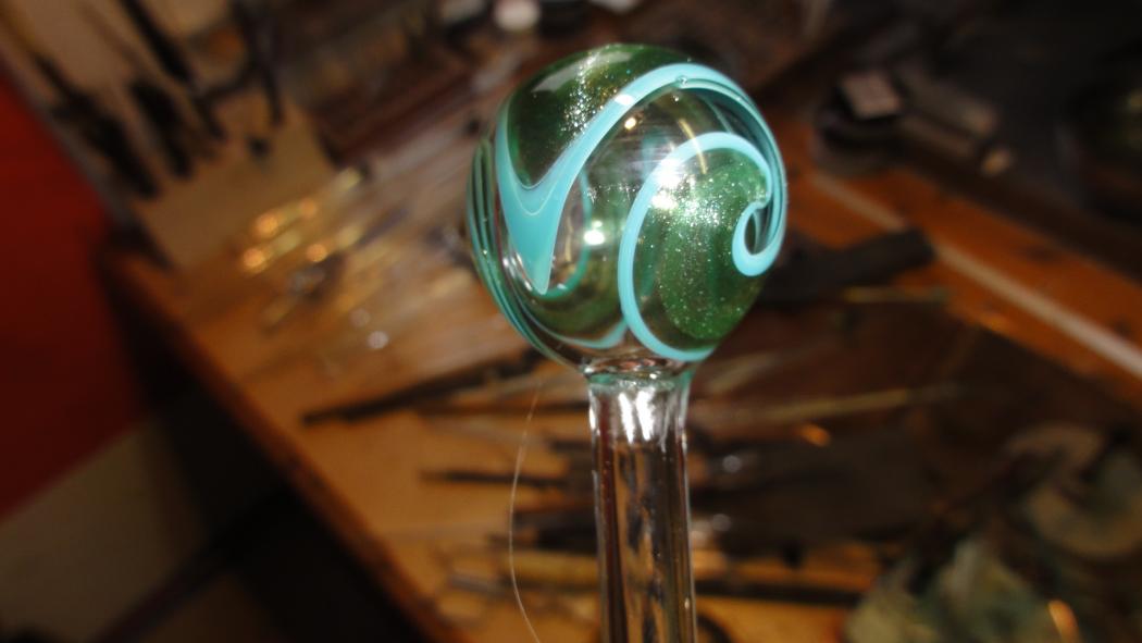

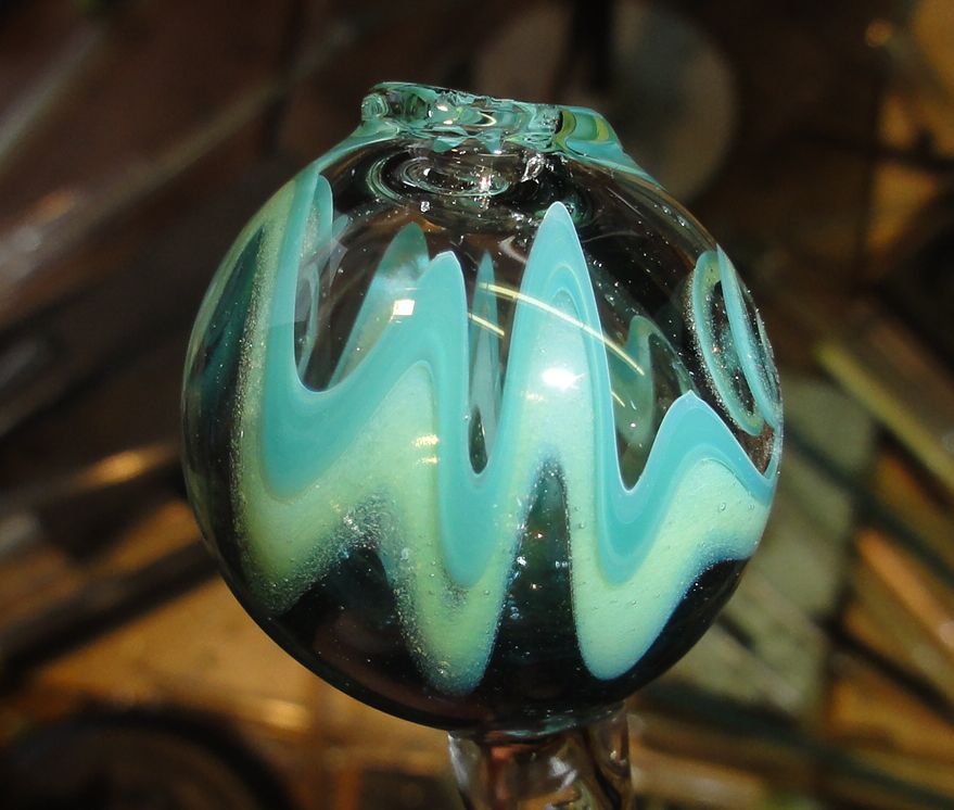

so finally holidays from school, and some free time in my garage, just for the fun i made discs cause i watched a short vid of eusheen on youtube so i thought i should give it a try, i used all new colours i got paparazzi and hbl ,its so cool how layered stuff looks in different light, now im thinking what to make out of it, maybe mouthpieces or connecting them together or something i dont know :D so props to eusheen i was afraid all the time cause of the cold seal o the disc front while making the termination on the other side, one punty took out a chunk at the reversal section, wich sucked , but on the other disc it worked real nice :D
Attachment 44681Attachment 44682
Attachment 44683Attachment 44684
Attachment 44685Attachment 44686
Attachment 44687Attachment 44688
Attachment 44689Attachment 44690
Attachment 44691

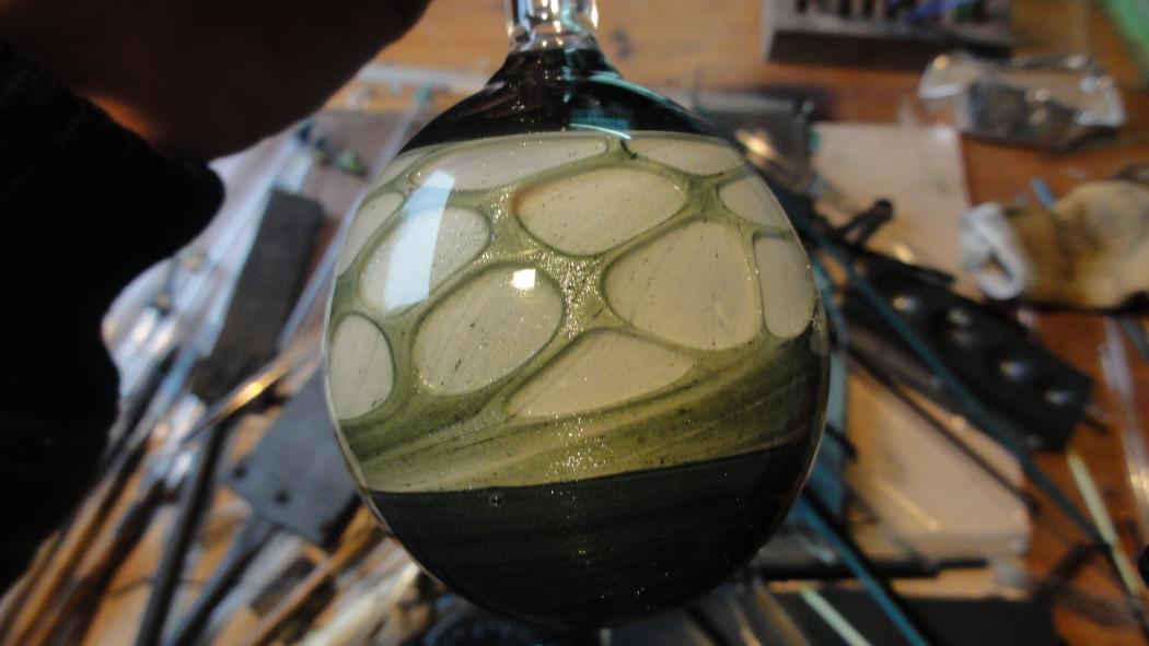

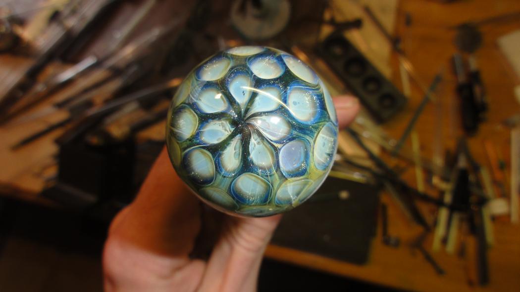

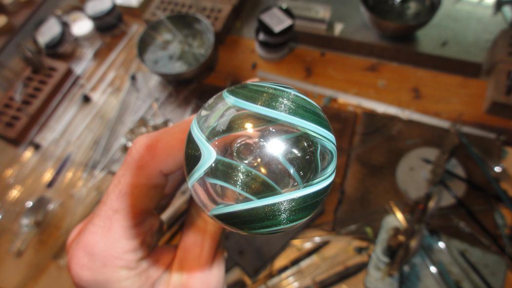

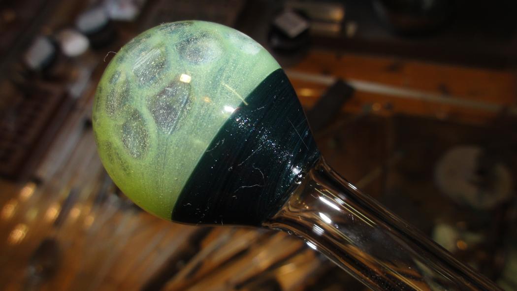

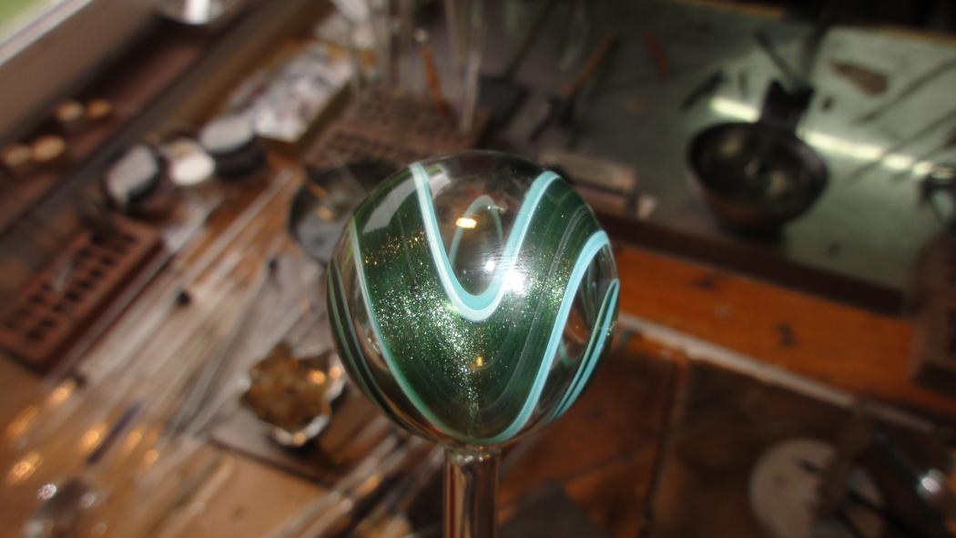

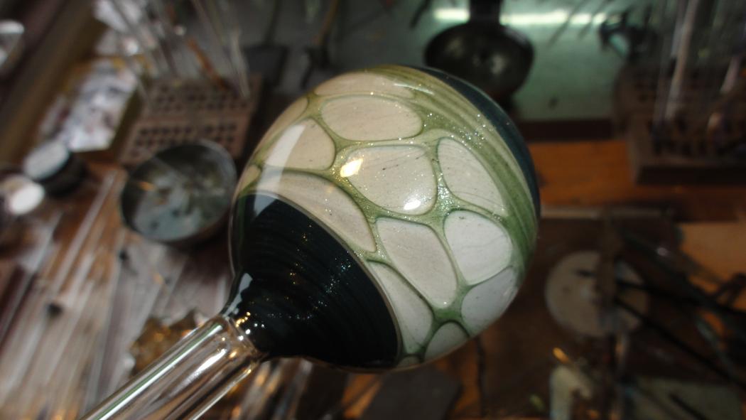

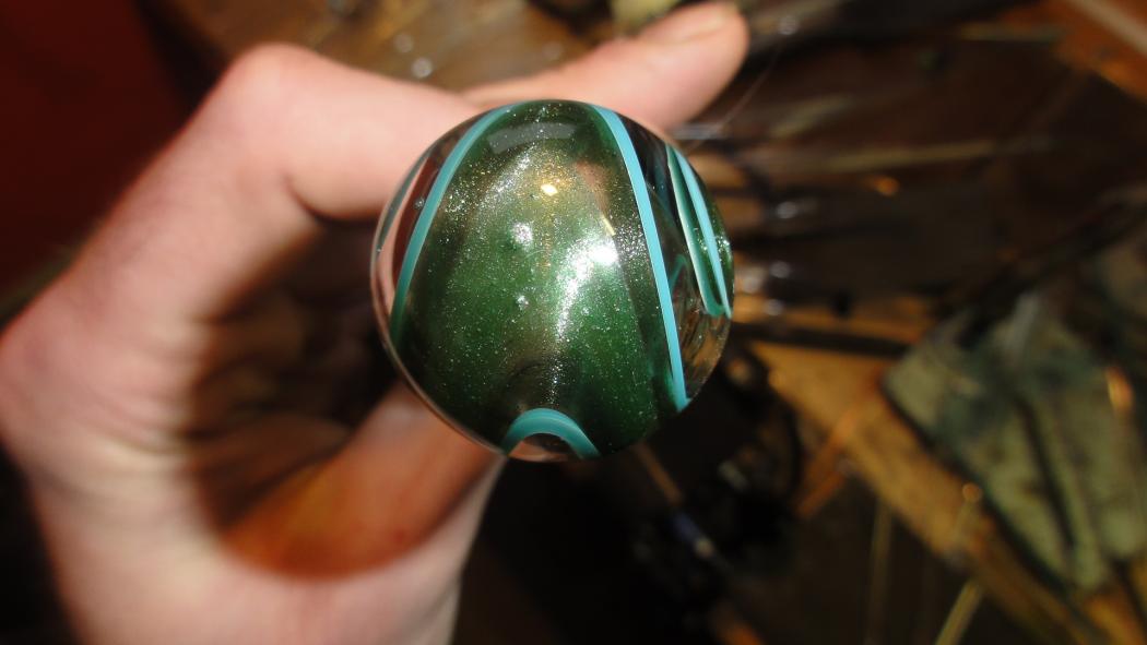

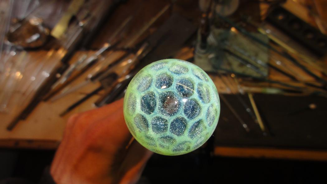

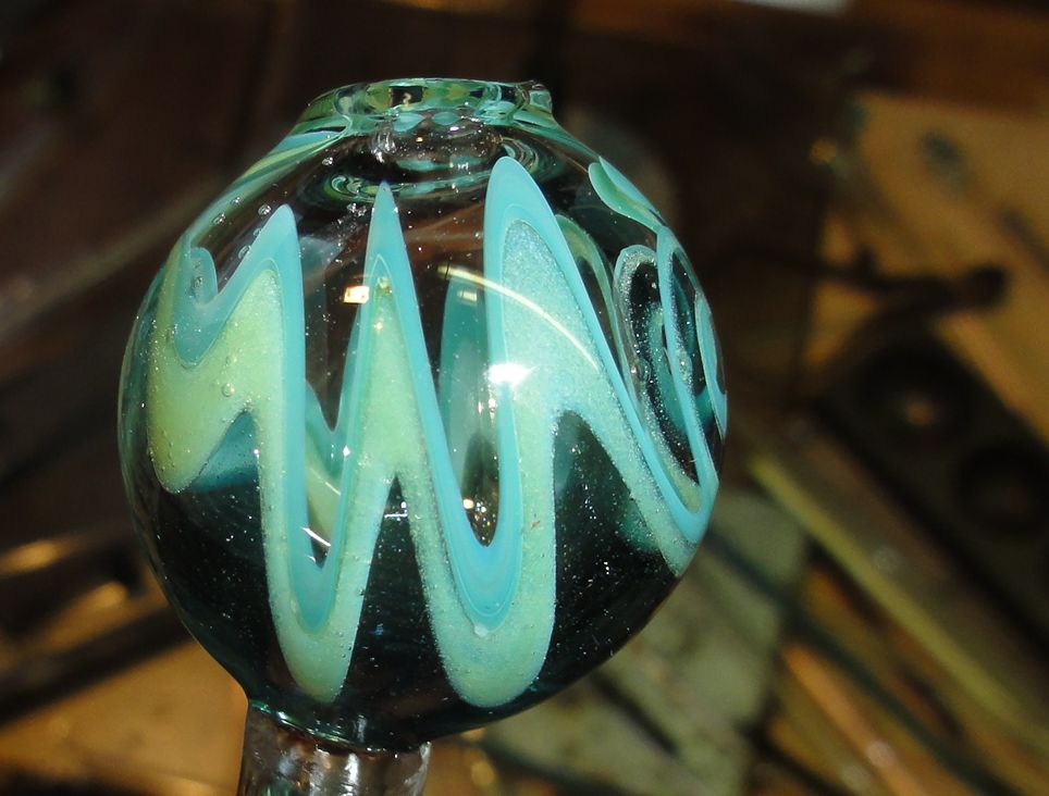

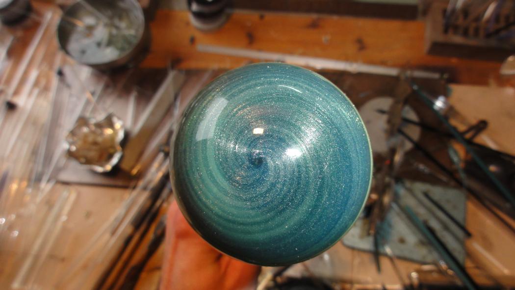

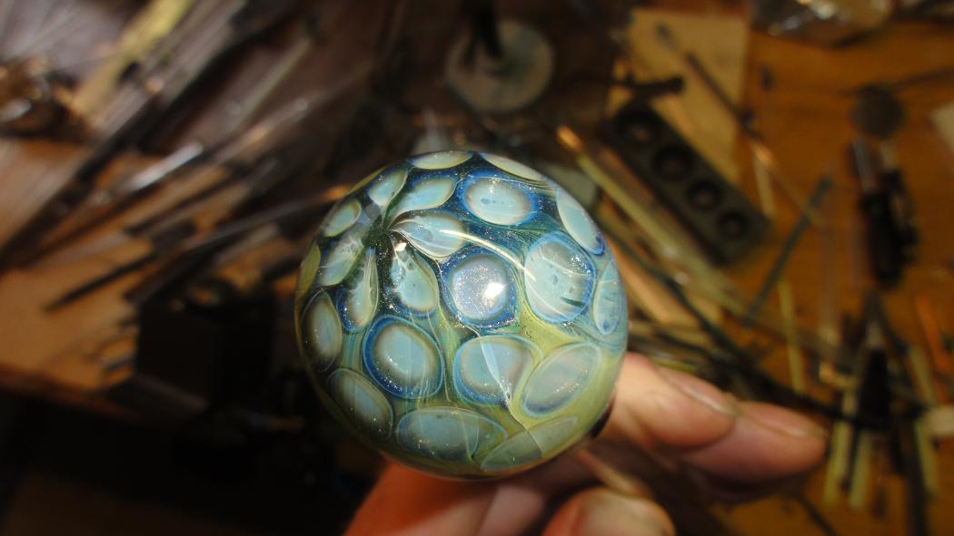

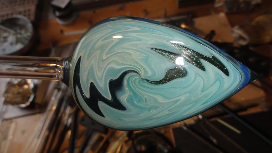

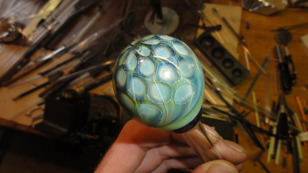

some things from yesterday
Attachment 44859
Attachment 44860
Attachment 44861
Attachment 44862
Attachment 44863
Attachment 44864
Attachment 44865
Attachment 44866
Attachment 44867
Attachment 44868
Attachment 44869
Attachment 44870
Attachment 44871
Attachment 44872
Attachment 44873
Attachment 44874
Attachment 44875
Attachment 44876
Attachment 44877
Attachment 44878
Attachment 44879
Attachment 44880
Attachment 44881
Attachment 44882
hope you like the pics :D

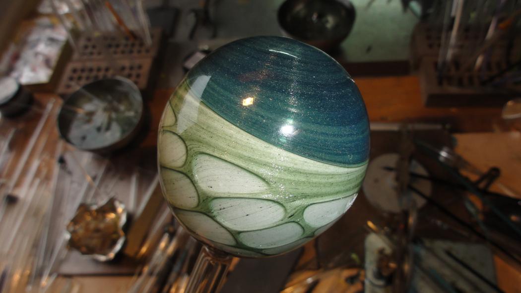

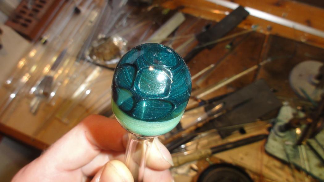

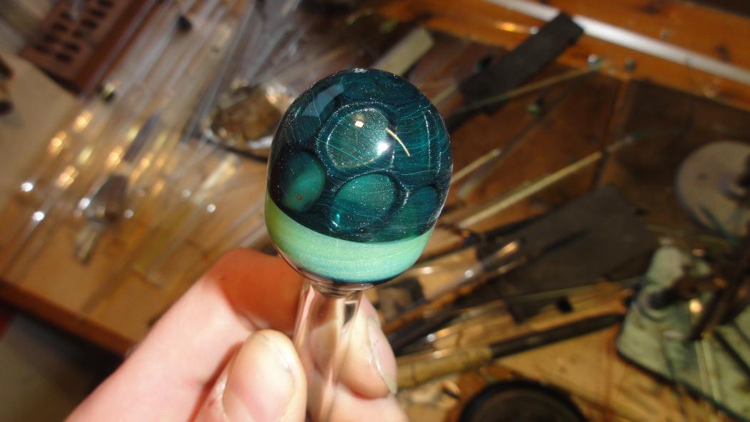

Wow! Beautiful stuff.
Can't wait to see what you come up with using those sections.
hi some of those are going to amsterdam to snob to be incorporated into a tube
some of them are for my personal projects i just need to play around to find my style :D
Well, you're certainly on the right track, wherever your style is headed!
hahaha exactly ^^^^
Works looking great Steak!! Those color combos in the last few sections are great, very organic, but still bright and lively!
thank you very much :)

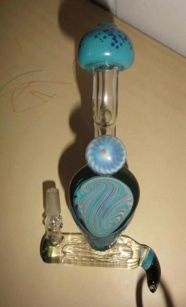

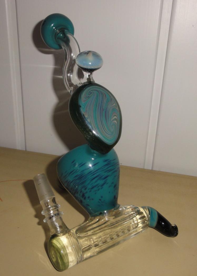

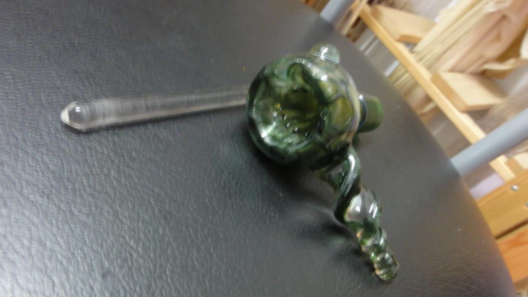

yesterday build an inline bubbler and fucked it up, i knew i should have bridged the connection, so the weld there was shitty and broke, now
it had some weight and i wonder if i should use somethin bigger than 5mm to bridge,
and i also have an important question to you all, do you put the bridges to special places like where a mib is gonne be welded on later or you just bridge anywhere it feels that it holds well? or should i bridge to the blowtube...? but the weld wich i will work on is lower so should i bridge from one section(can) to the other(disc)?

your curve looks nice bro :)
I bridge to the blow tube. A good trick is to weld an inch of 8 mil on the blowtube. Do this like an inch up from the weld to the piece. Then attach your bridges to this piece of 8 mil. This way your blowtube won't crack from the cold seal scars.
@hmk: thank you
but what if the connection that i have to weld lies lower like 15 cm beneath the blowtube, should i do a bridge that long or should i bridge from the section where the connection is to be made to the other section... it would just be a temporary one wich i would remove later...but than i have to wisely choose the bridging point cause it always leaves a bit of clear so i can attach a marble there...hmmmm
I mean.. As long as it doesn't get in the way there is no harm in a long bridge.
ill just try it out next time i have holidays, on sunday im returning to the scientific workshop
thats the one where it went wrong...
Attachment 45085
Attachment 45086
Attachment 45087
its now my shop piece for safety breaks :D
Oh wow, that's really nice man
