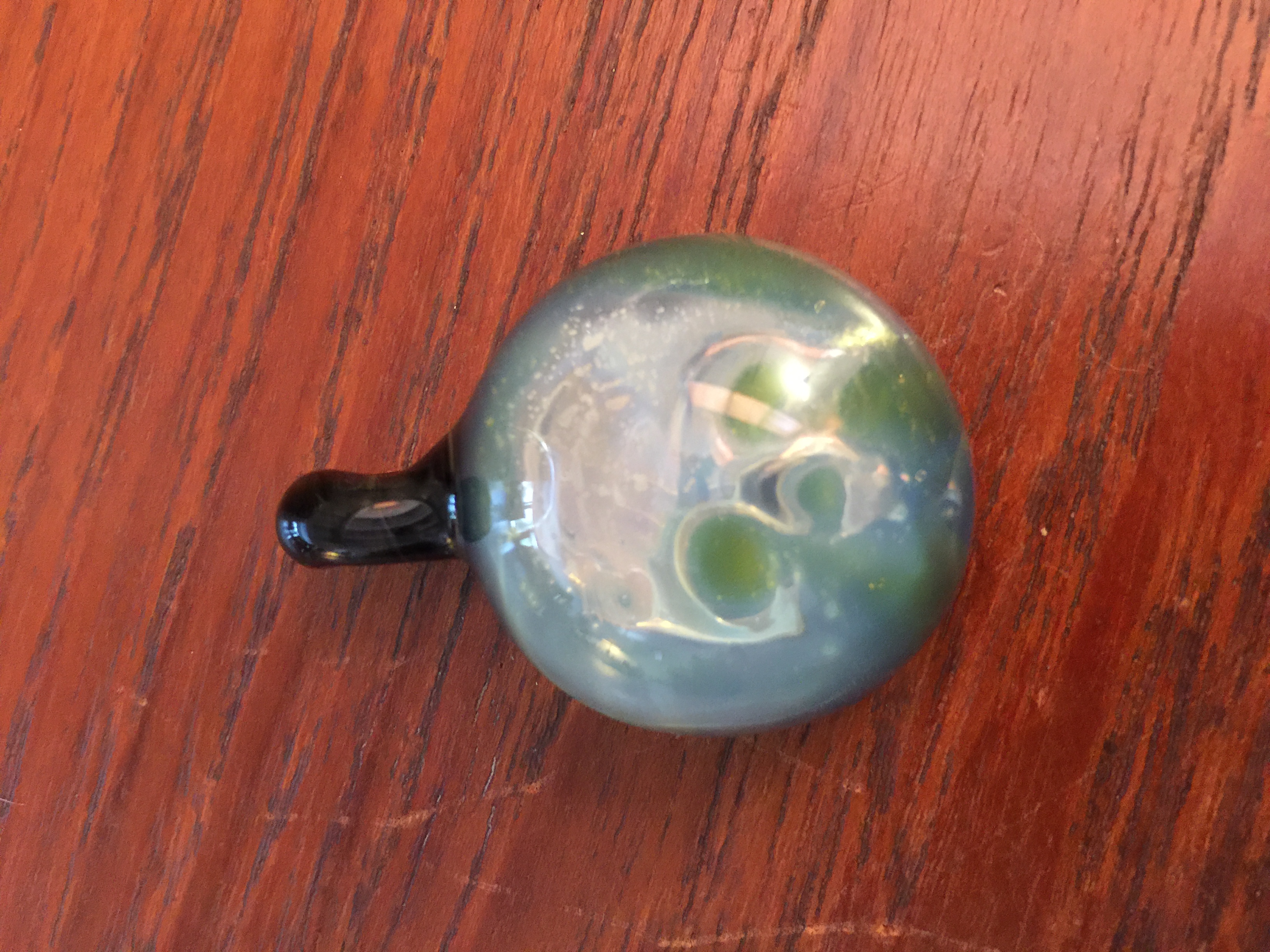

Tried a new style pendant, did one with haterade, one with purple rain and one with blue stardust. All fume centers, all backed with eclipse. Photobucket definitely worked better than imgur quality wise, So thanks cheesenip.

No problem. Also keep in mind, if you are using a phone for your pics, the pixel count may not be high enough to upload really good pics once they get blown up to size. I've got the Galaxy S5 with 16 MP, so it's not really a worry for me, unless I'm uploading large scenic pictures or something similar, but there is that to consider as well.
Yup, I'm pretty camera illiterate haha. Posting from an iphone 5s over here. I think just switching to photobucket was enough to improve the pics. Thanks for all the help cheesenip!
