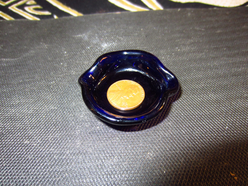

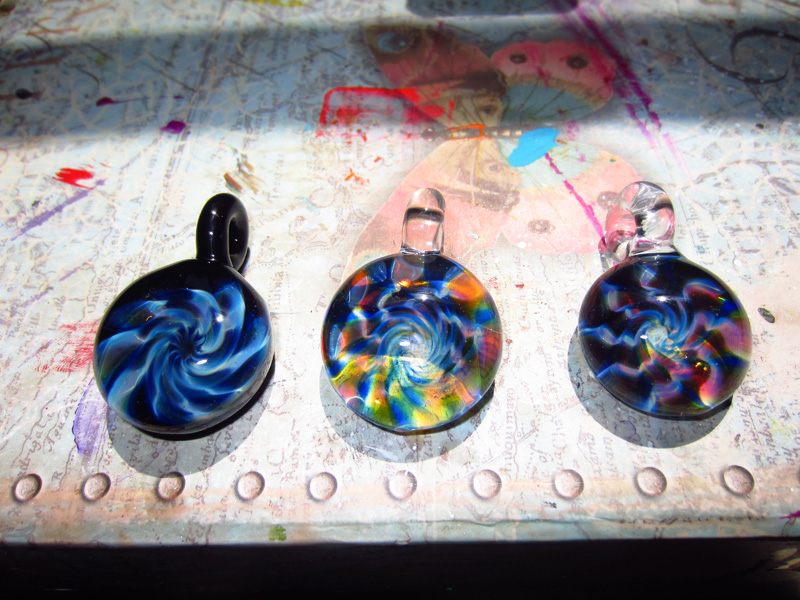

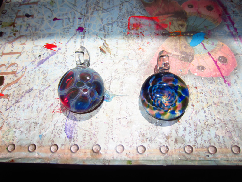

Thanks everybody here's some more pendants and a coil potted cobalt dish.

Hey man, fill up a case of those and take them to the bead store!!
Your pendants are telling me that they want to help pay for your next bottle of O2
Very nice colors your getting, great job. It's a feast to my eyes.
Those pendants look good.

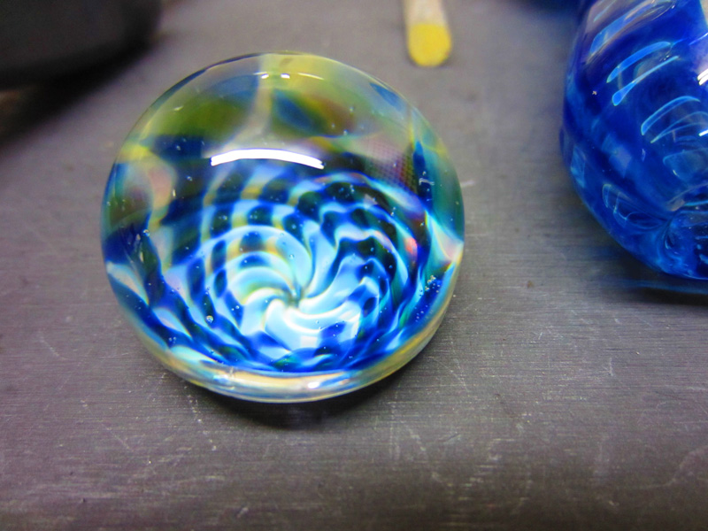

The colors are real nice and the only advise I would say is try to get your terminations even cleaner. You really want to try and pull the end of your design or spirals to as thin and clean of a point as possible. That way when it re-condenses there isn't a blob of color or a clear spot in the middle of the piece. Everything looks really great though so keep up the good work!
When I melt my termination back down I kinda keep the heat away from the tip I pulled off and let the heat from the mass of the pendant or marble or pipe or whatever it is slowly melt and round the tip out. Especially boily colors does this become important.

I've been working on getting my terminations cleaner. I started doing it just the way you said a couple day's ago and they are coming out pretty clean the more I practice them the better they get. Here's a marble from a couple day's ago let me know if this is any better.

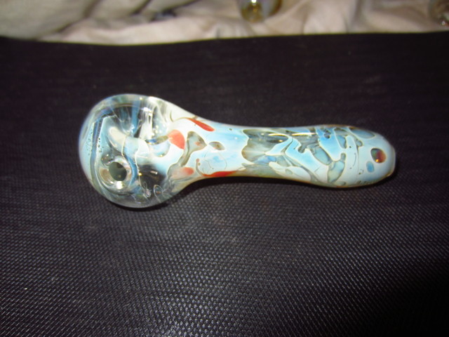

On this one did you just fume it then dot some clear and red on and melt it in, or what was your technique?:
