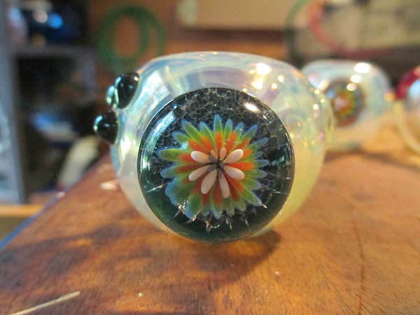

Attachment 54157 Looking good 'Land's Glass' I think this one looks like the MGA logo haha.
^^^^lol, I guess if you think so.
