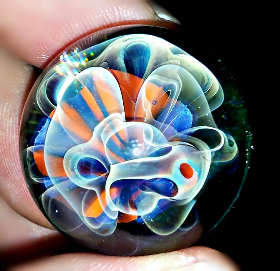

This thread rules. Just finished up a piece made specifically for this thread. I've needed an excuse to stop the insane amounts of production and have some fun :)
If she survives (fingers crossed) I'll be making a contribution tomorrow.
Lmwfy, vinpin or tungsten? super clean.
Awesome photos, esp chubbles! When I take photos it tends to be really hit or miss, I end up just taking a bunch and get the fume to show it's colors well 1/10 times. My photos range from missing the fume all together and leaving the pc. looking clear or very slightly color tinted, to the other extreme where some photos bring out brilliant tones of fume that are difficult to see in person (leaving the pc.looking better then it does irl )
Anyone have general tips on getting fume not only to show up but to look sexy when photographing?
lots of light, dark background? then again i know fuck all about photography.

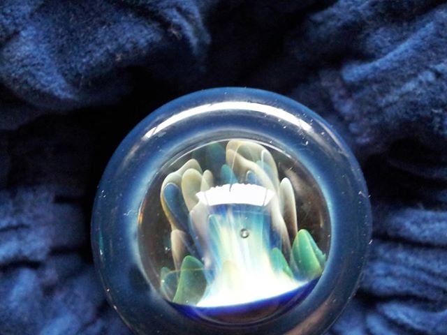

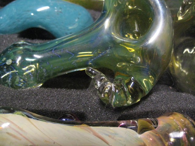

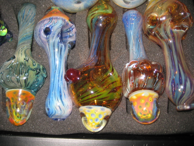

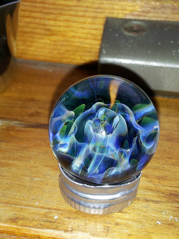

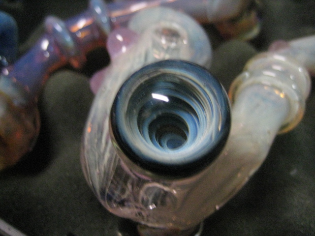

Guess I can add a few of my more decent fumers.
Attachment 50794Attachment 50795Attachment 50796Attachment 50797Attachment 50798Attachment 50799

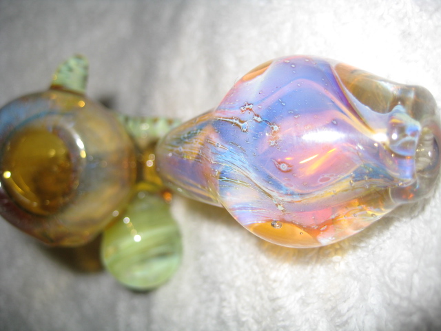

Again I must say, this thread rules. My contribution,
Nothing too fancy, messing around with a new way to make fumed lined tubing,
http://i857.photobucket.com/albums/a...k/IMG_0354.jpg
