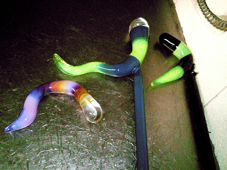

I make a lot of these. I make them all day long.
http://i1052.photobucket.com/albums/...ciiucwfx_1.jpg
New style of sherlock I've been doing.
Cool Sherlock looks like something a warlock would smoke from. Claw of the dragon that bit you, my friend.

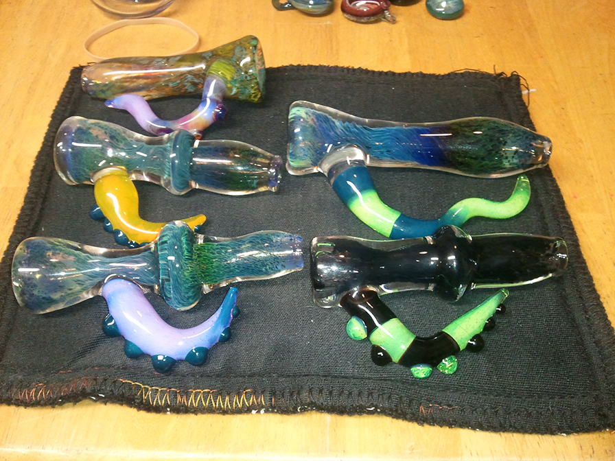

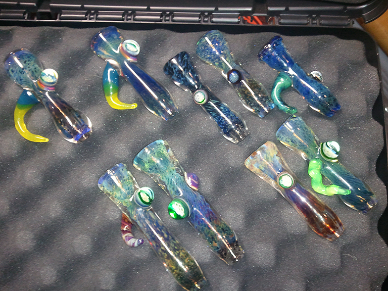

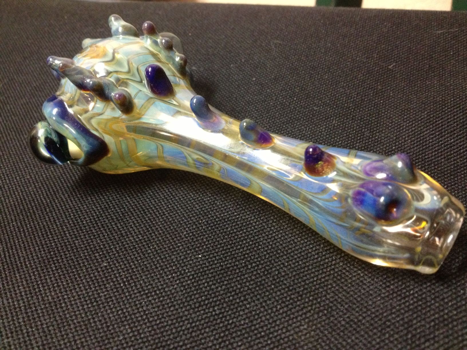

My first relatively big sherlock i made last night. What would you price this at?
how long did it take you? I would ask for $30 maybe for it? It does not have a reversal in it so that is why I say maybe. I get $35 if it had a reversal. That is why I don't do that stuff really. Just small bubblers and spoons and chillums mostly.
That's what i was thinking! Being my first one, it has a couple of defects. Just not as smooth as i would have liked. I need to work on my bends. It took me a couple hours. A little longer with the prep.
Moon munkey ,
If you hold the piece upside down , and gently heat the underside of the bend by the mouthpiece , the little lump of extra glass will smooth right out. No puffing needed most likley... Gravity will do it for you. Doesn't take much heat. Got to make sure the top of the bend stays cool and stiff to keep its total shape at the same time.
If the bend gives you trouble , I would heat a bigger section of the bend area , and go really gently, little at a time. Most importantly , with a fade in the heat base ,So more glass can move at one time. The glass further from the bend needs to give a little to keep it all clean. I'm always thinking about how much glass actually needs to move for a certin step. The longer I do this , the more I understand I usually need a bigger area heated to let the glass flow smooth and "give" ( flex or stretch ) like it wants to. Not nessasairly hoter , just a bigger area heated.
+rep. For posting , and not boiling the un encased colors.
I would get 45 wholesale , they get 90 in the store.
No less than $35 , they get 70$ in the store.
Etsy or retail from you to the customer .... 60$ plus shipping.
( I'm assuming the it's full size , and that's a soda can in the picture. )
thanks boro! It's the same for me bigger area but less heat. I alway end up with too much of a concentration of heat. I did sleeve the the orange cran after coilpoting. Thanks for the rep!

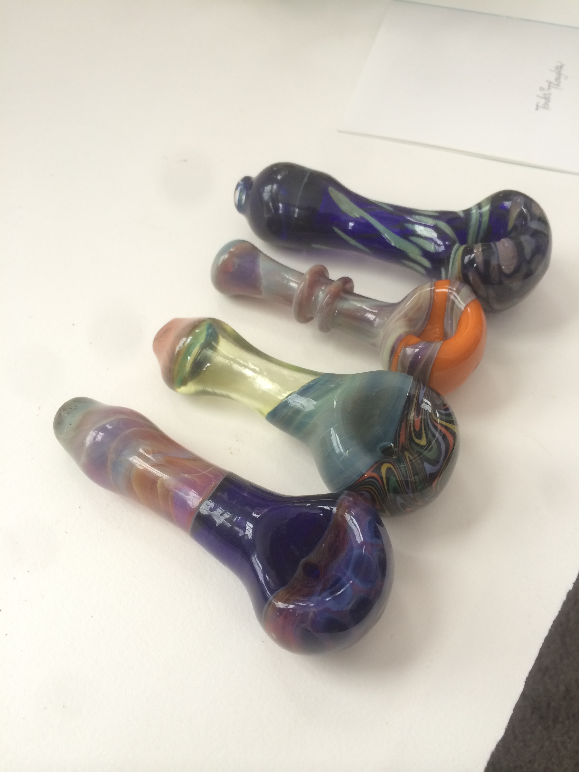

Attachment 71088
a few attachments (practice at making smooth bends, I am slowly getting better me thinks...)
Attachment 71089
I need to practice bends more too. Nice job man!

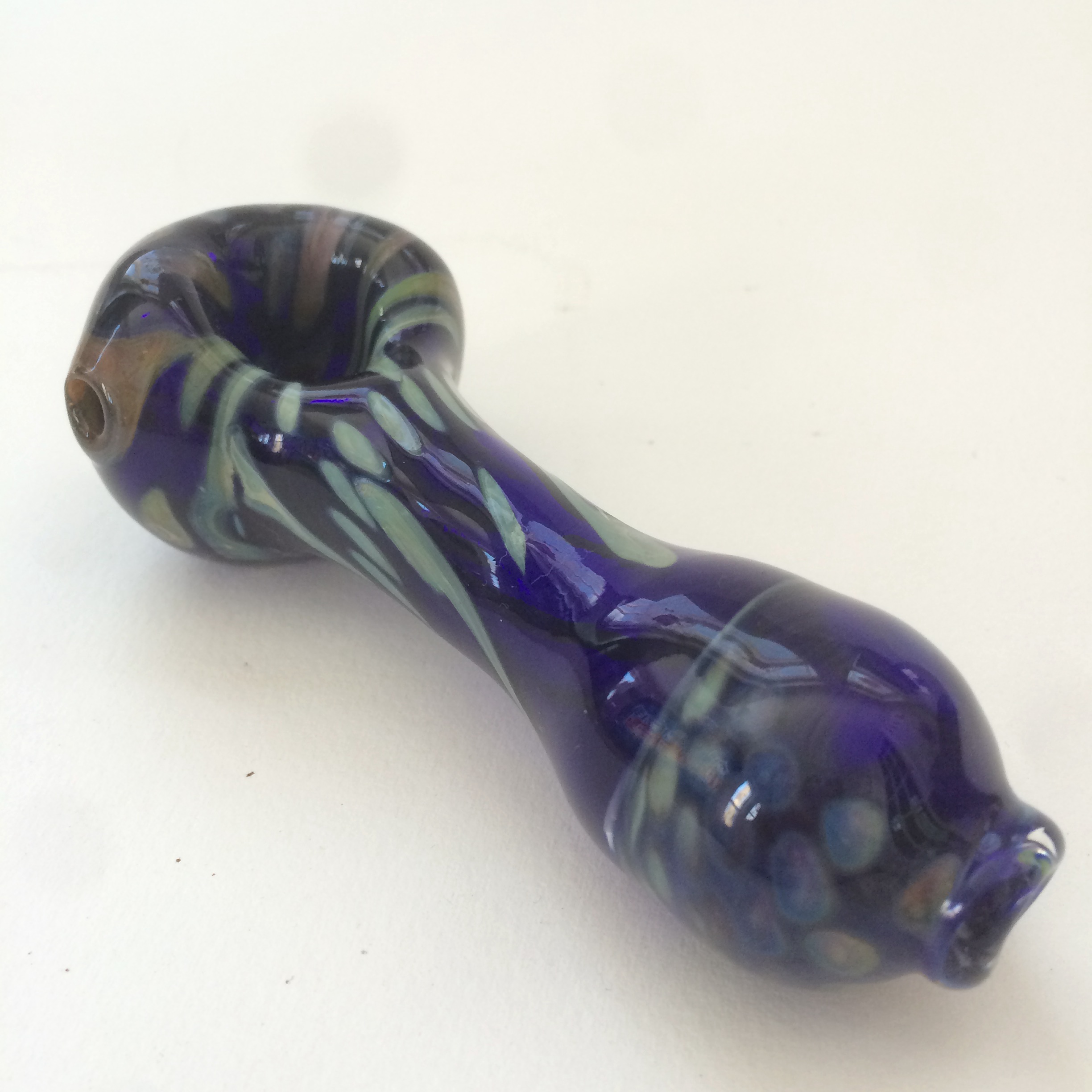

more chillums lol:
Attachment 71121

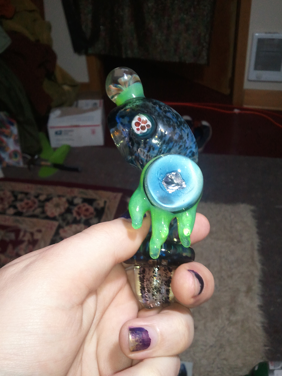

First spoon on my scorpion 3 balls encalmod together finally able to work thick pieces with new torch, Keeping everything nice and even and nice bowl holes so much easier working the glass thick thanks for the guidance tmp <3
liking those slides nomad

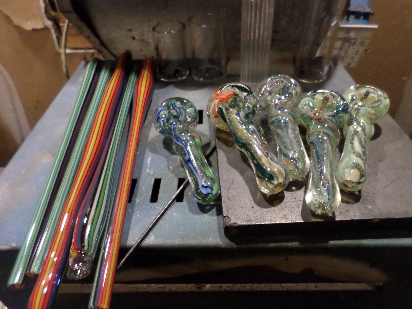

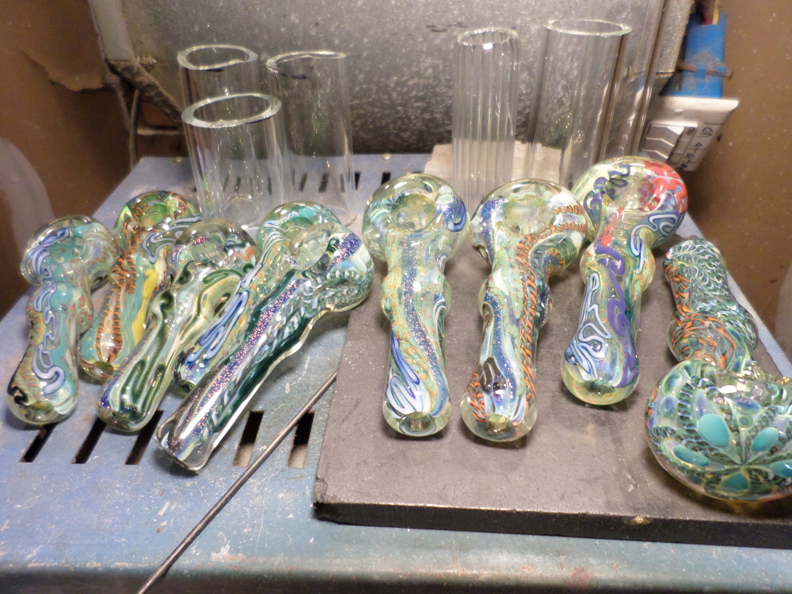

Working on encalmos. http://tapatalk.imageshack.com/v2/15...e87b2ec66a.jpg
http://tapatalk.imageshack.com/v2/15...ebd7f47e50.jpgalso working on encalmos haha.
cheater. XD
looks like a 10 stack. pump em out

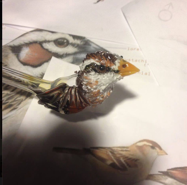

Super proud of how the dragon came together.
Attachment 71209Attachment 71210
