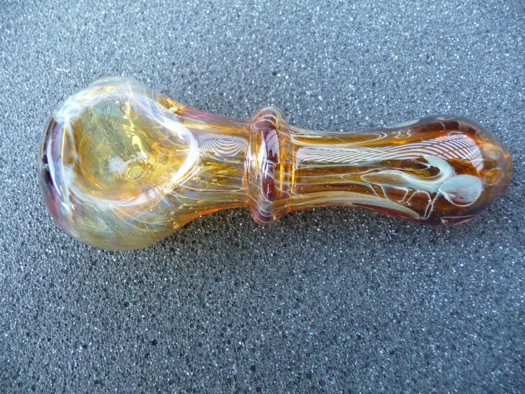

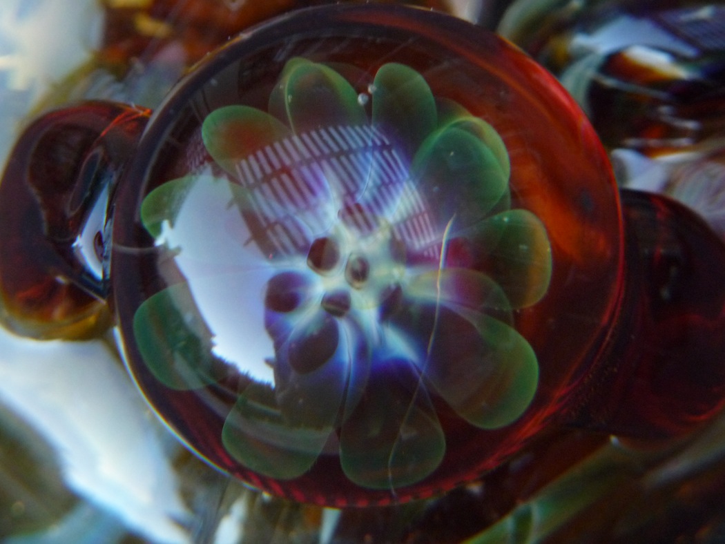

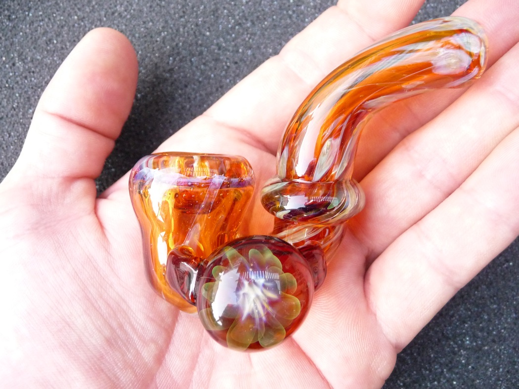

Attachment 41994Attachment 41995Attachment 41996 Amber pocket Sherlock with gold and silver fume implosion marble. The photos don't do this one justice, in the sunlight it really catches the rays. The marble came out interesting, implosion flower with a honeycomb center. Also a simple spoon. I'm liking this chinese amber rod, it handles almost better than clear.
nice!
