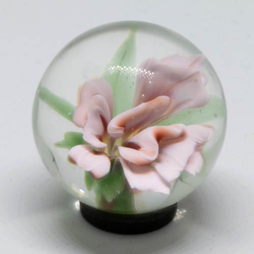

Attachment 92594
Hi!
Just wanted to give an update with regards to my implosions. I'm actually really excited because the advice Valinski gave me was spot on. This was my deepest implosion ever and it looks great! Still needs a lot of work with regards to colors and the pattern, but the deeper implosion makes it look more organic.
For those that want a few more details, here are a few things I noticed. The marble I made is small (0.5") and took me about an hour to make because I was trying different things. Hopefully it'll save someone some time.
- The flower opens up when you press against your graphite pad. The more you press, the more the flower opens.
- If you want to remove the divot that forms as you're heating the maria by using the pad, make sure the maria barely touches the pad. Remember the goal is to get rid of the divot, not press the maria down (which will open up the flower). By having the maria barely touch the pad, the molten glass will automatically flow into position. You'll actually want to exert an upward force to counteract gravity so the maria doesn't flatten under the weight of the rod and the gather.
- When heating the sides of the maria, the rod needs to be almost horizontal. This causes the implosion process being significantly slower, but you'll end up with a deeper implosion. I think you can speed up the process by using some more heat but I still have to try it out.
- You can "reset" the shape of your maria and remove the divot by moving your elbow down and heating the sides of the maria. This will obviously change the shape of your maria and you can only do this maybe 2-3 times before it will start to deform the shape of your flower. Also, I find you will need to press pretty hard after you do this process to get a flat face on the maria again. What I did find though is the flower does not open up as much as it would normally. This is because moving the elbow down causes the flower to close a little. Pressing just undoes this. I still need to experiment a lot more with this to see how useful it is, but just throwing it out there.

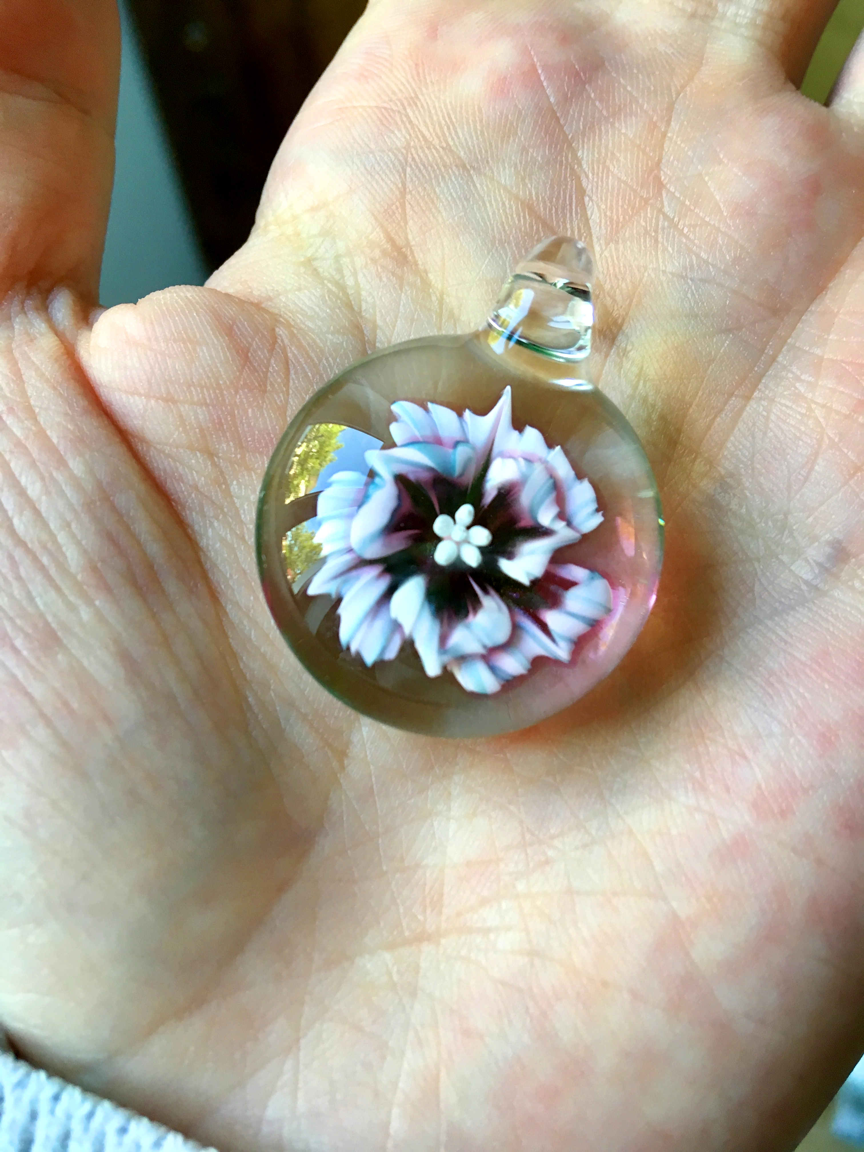

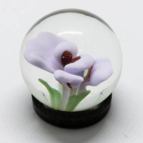

For this pendant:
Attachment 92618

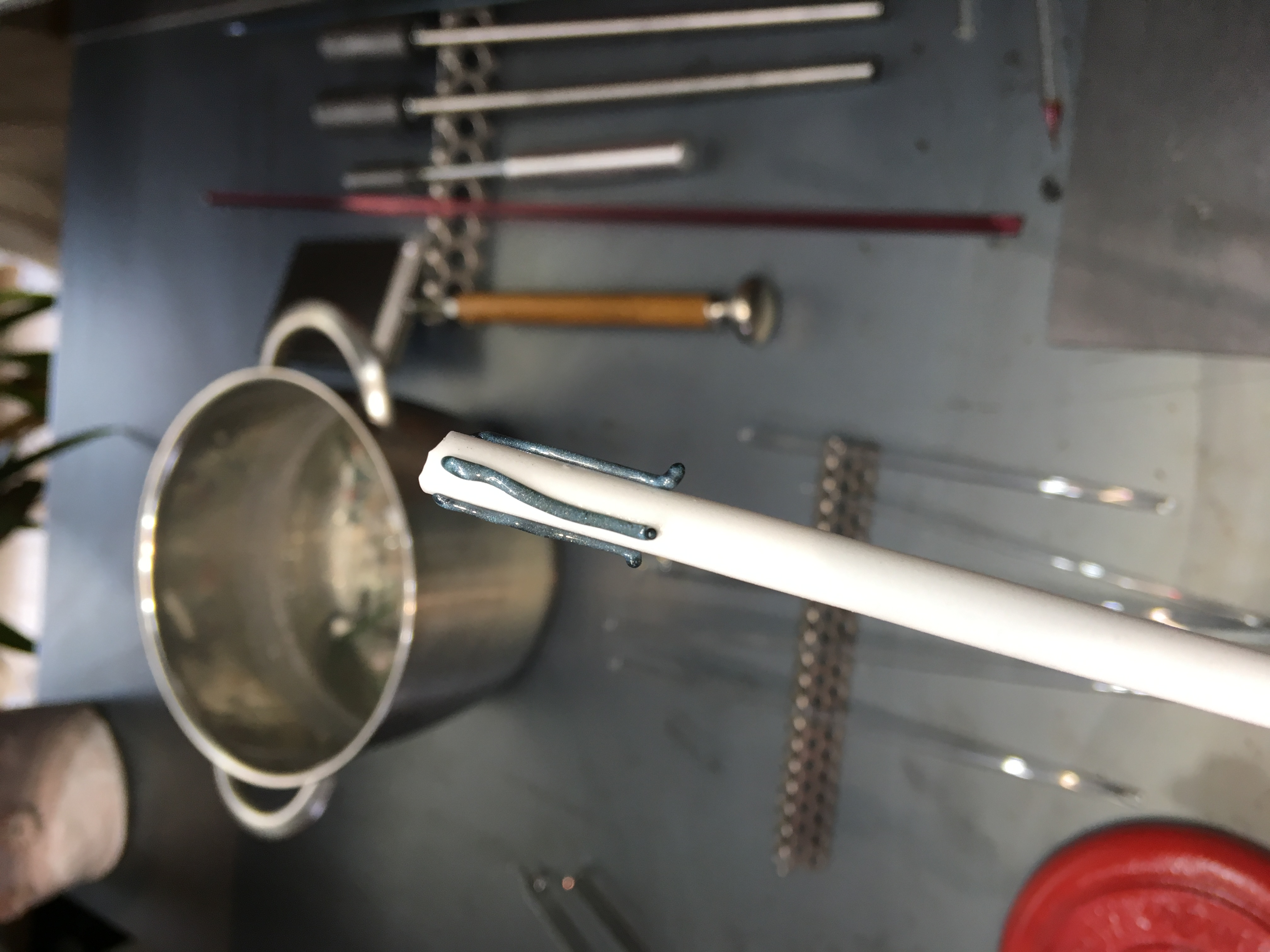

I drew a few stripes of NS Unobtainium on a rod of chinese white:
Attachment 92619

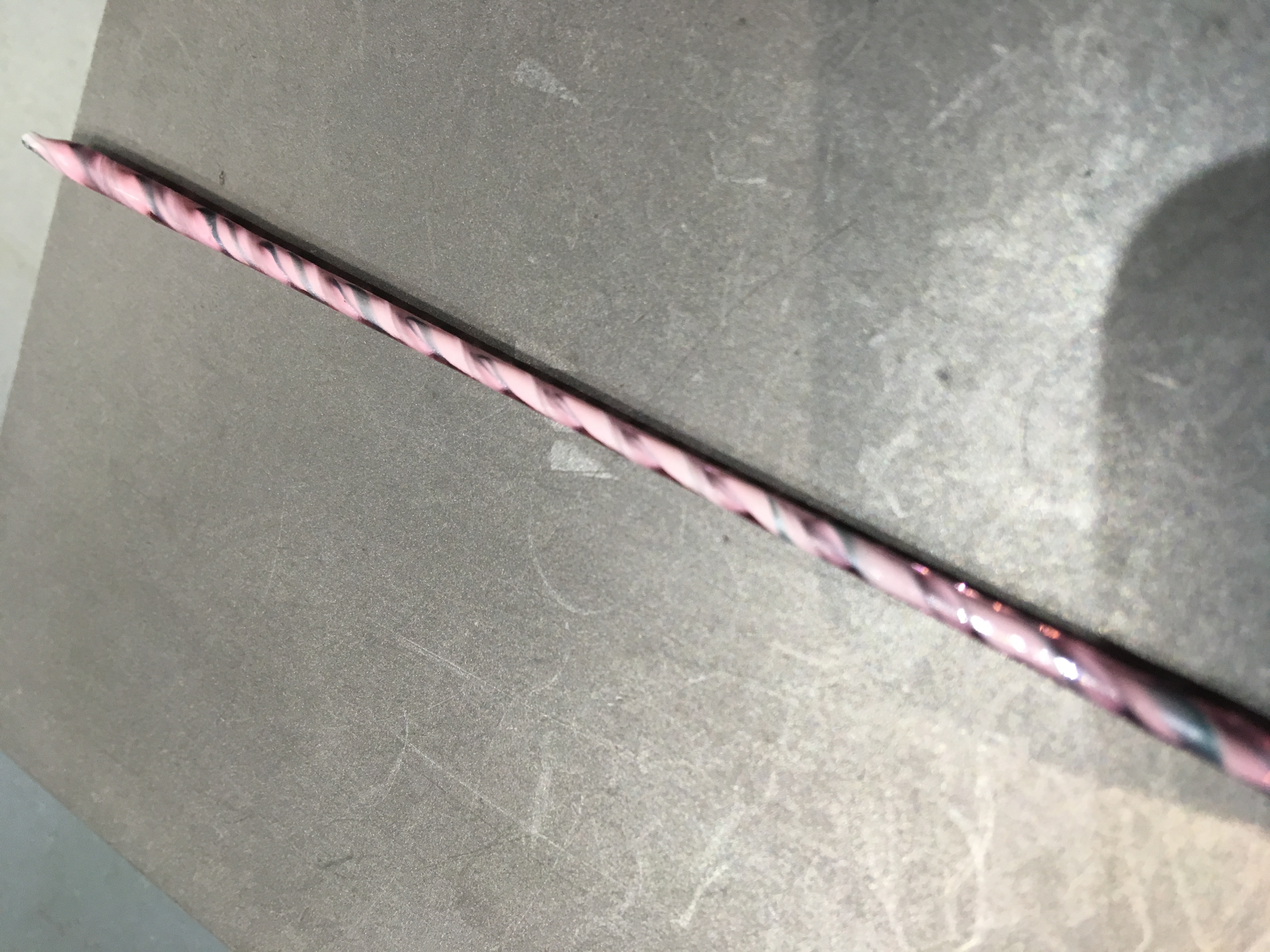

then encased it in Gold Ruby. This was a part of the pulled twisted stringer:
Attachment 92620
The petals seem to be "toothed" because of the clearer color I used to encase the cane.

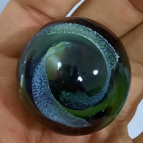

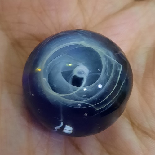

Hello everyone
I've recently gotten back and noticed the forum is not very active. I'll post some progression pics in the hope that people can provide me with advice.
I'm trying to up my marble game again. This is the second vortex marble I made since I got back.
Attachment 94212
I made a few mistakes and I have a few ideas on how to improve my technique for my next attempt.

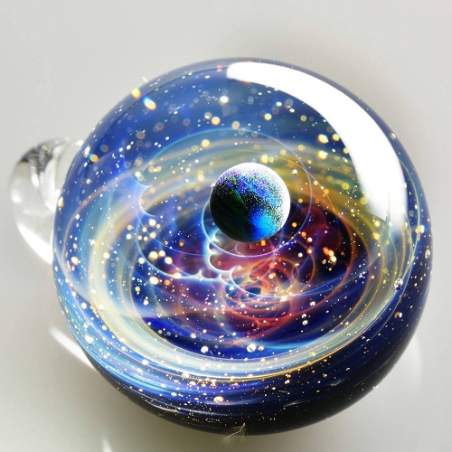

I also tried to make a space marble. This is what I have so far:
Attachment 94213
This is what I'm trying to go for (in fact, these were the pieces that inspired me to get into glassworking in the first place):
Attachment 94214
I'm fairly happy with my fuming pattern (I can make a few tiny improvements on it), although suggestions how to improve it are greatly welcome. However, the one part I'm not sure about is the purple near the bottom of the piece. Is that gold fume? When I tried fuming gold over a black backing, I got a really ugly brown-like color. Nowhere near the vibrant purples in the picture. I have been able to get pink out of gold fume, but that was only on a white backing.
