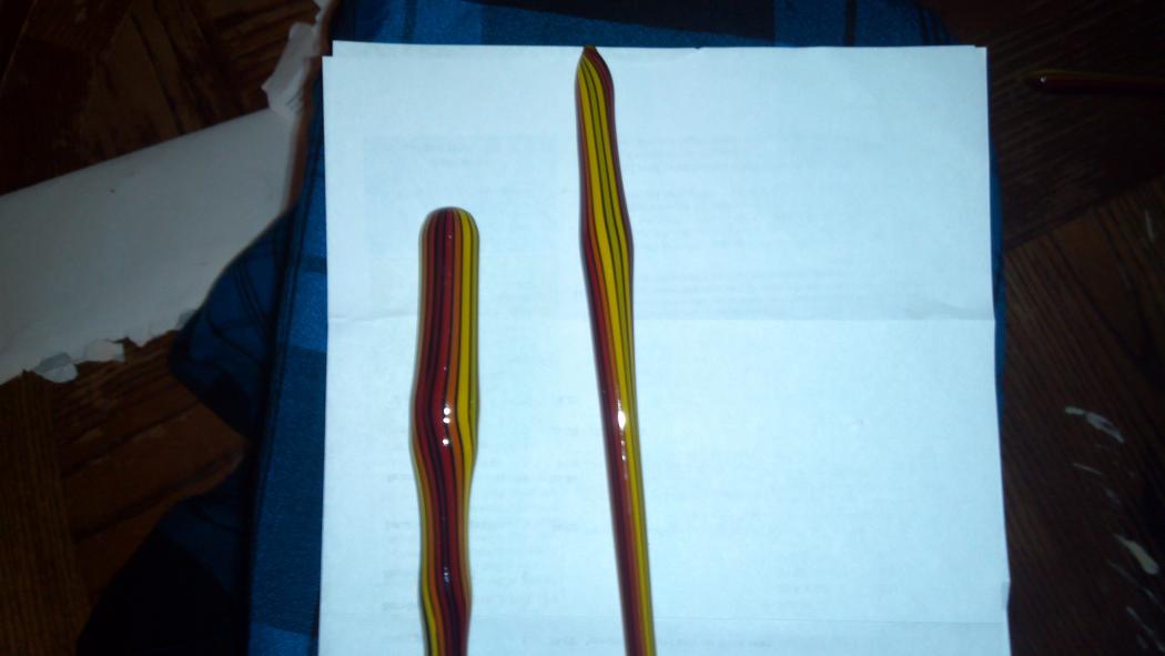

Attachment 45105

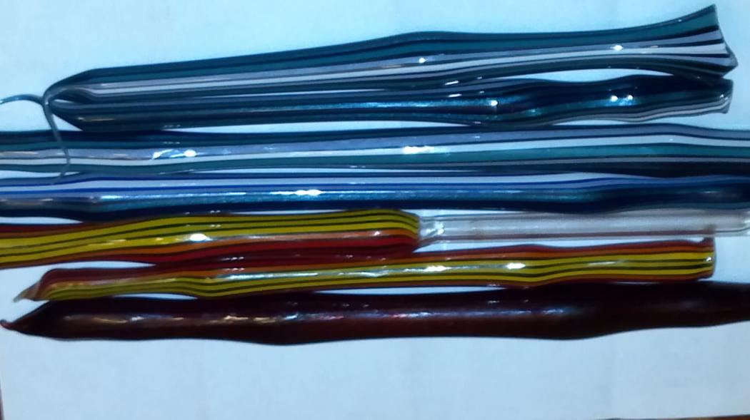

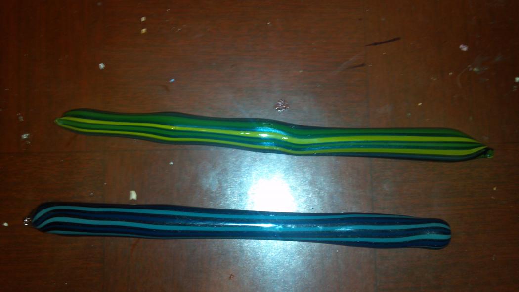

these are the other two tubes i pulled lastnight the top one in this pic is the one that everything went wrong with it. This is a i got out of it. Think im going to go back to pulling smaller tubing and work on being able to see it coming with the lines

are you laying the color down by hand, or doing stacks?
looking good...i've tried to do lined tubing (by hand) a few times and just gave up for now...i'm nowhere near making it work though. still doing silver/gold fume on clear.
Re: Noob pics *open fire*
By hand, by the time i get the clear encasement on my back and wrist start working against me. Makes me realize how much of a pussy jon it is working at my day job. I work at a plastic factory with injection molding. Its amazing how similar glass and plastic act when heat and pressure are added. Doing glass blowing has helped shoot me up the ranks pretty fast and working with plastics have helped me get structural ideas for glass blowing and a idea on heat base.
do you sit or stand? i can make a pretty giant tube pull that way before wussing out, but i sit and can rest the arm that holds the tube against the bench when applying color. standing and doing it would be much tougher i think. and if i do get weak, i can actually rest the handle of the tube pull on the bench sometimes, but its kind of tricky.
At home i sit but at my mentors i have to stand. Sitting is so much better and its easier to keep the hand steady.
My biggest problem with prepping tubing that way is seeing where I'm laying down the clear. That and trying not to burn or reduce sensitive colors. Sleeving seems like the better alternative because its faster and consistent but you need to take the time to work out a vacuum system and also its sometimes a pain finding and cutting the perfect sized rods to all play nice together between your tubes. I've had good result with the old stick stack method too without the inner clear layer.
my last linework pull I did the oldschool way with thick stringers and a really flared out tube section ISO application. That way has a nice optical effect when done well.
Looks good though so keep up the good work and do whatever works for you.
I've been pulling small sections of tube lately, if for no other reason than when I go larger I tend to flail it. And the tube you think is so bad....you're doing really well for a n00b.
I don't use much color, but had a batch of red elvis 2nds/odds mixed together that I later regretted buying, so I've been using that to pull tube the last couple of weeks. 3 inches or so of 38mm heavy wall tube, fume, five stripes of red elvis (which leaves me room for three lines of 5-7mm clear in between each stripe), a stripe dead center between the elvis, more fume, then do clear over fume over fume for the last lines. You might just try working with clear/fume for a bit to save on color. You could also buy some colored tube and stripe clear over color and clear over fume on that.

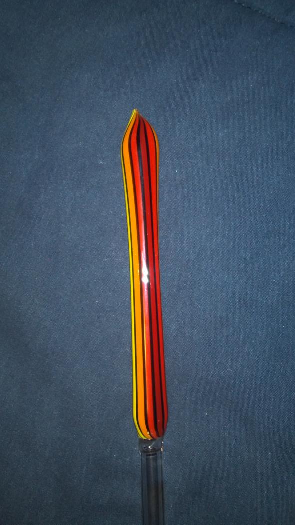

Attachment 45329Attachment 45330
I failed epicly tonight on this fire fade i started wrong and ended up missing three lines of color
it looks good from here. :)
The lines where alot more even but i still screwed up. On the other hand this is one of the more complicated tubings ive pulled so far so progress if small but still progress. Its one hell of a learning curve.
Yeah but damn dude.... Talk about progression! You're pulling tube like a madman.
Looks great, you're lucky to have such a good teacher.

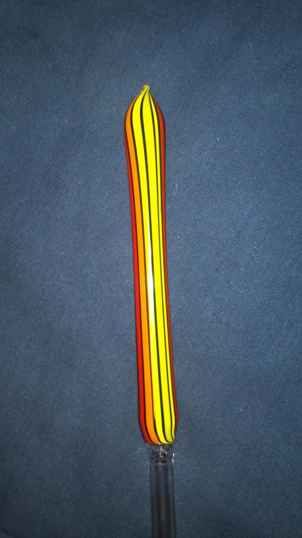

Attachment 45560Attachment 45561
a couple sections showing their termy spots (had two burnout on me) and my retry at the fire fade tubing. Got all of the lines in this time and only a few small lines compared to the rest.

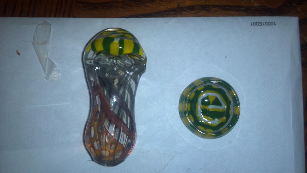

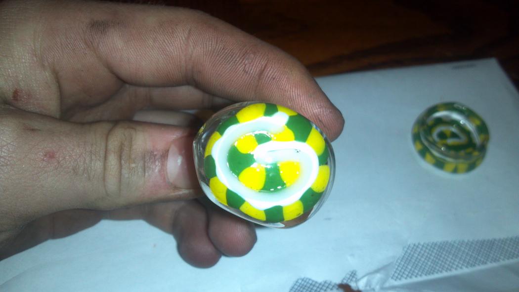

Attachment 45763Attachment 45764
A green bay packers peice i did for a friend.

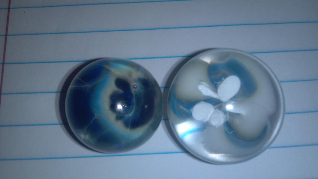

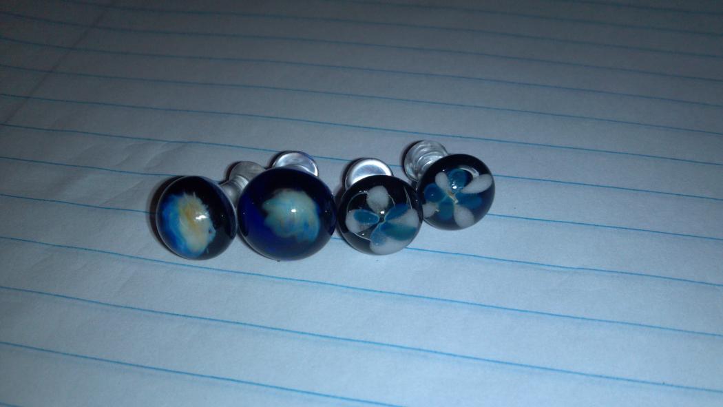

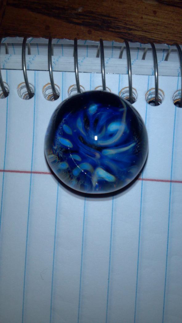

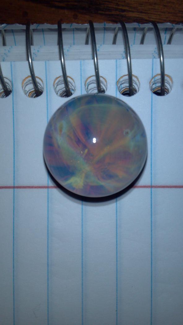

Attachment 45921
My first two crappy marbles.

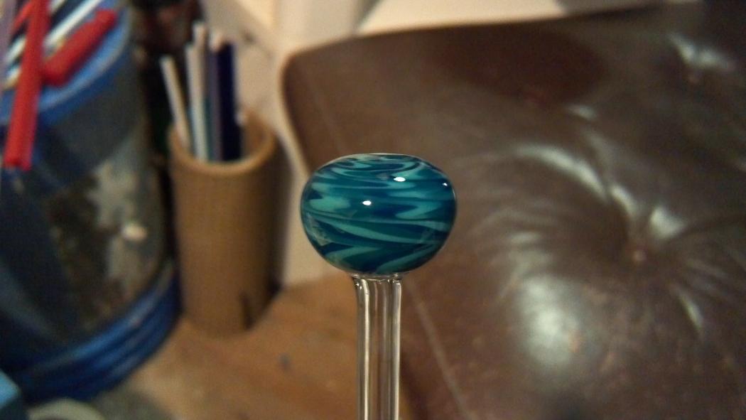

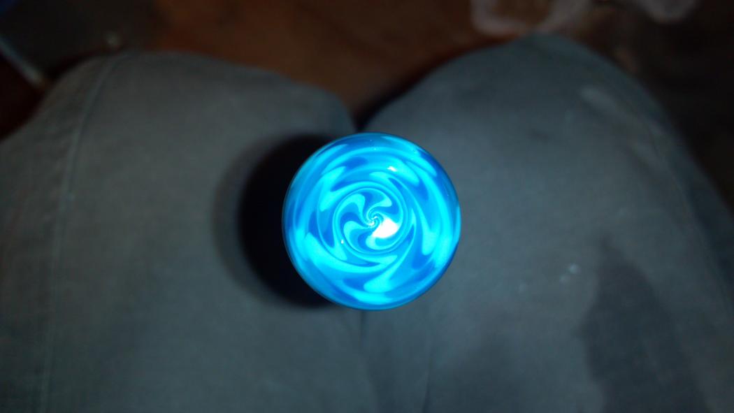

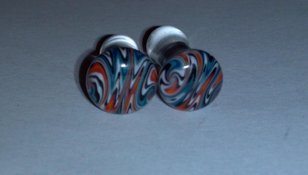

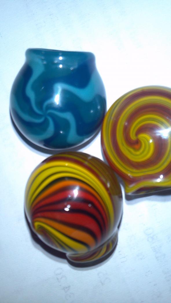

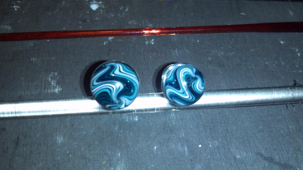

Attachment 45994Attachment 45995
First attempt at wig wags and condensing them into a ball. I condensed the top almost flat so i could see the patternA bit more. Is this considered a re-ball?

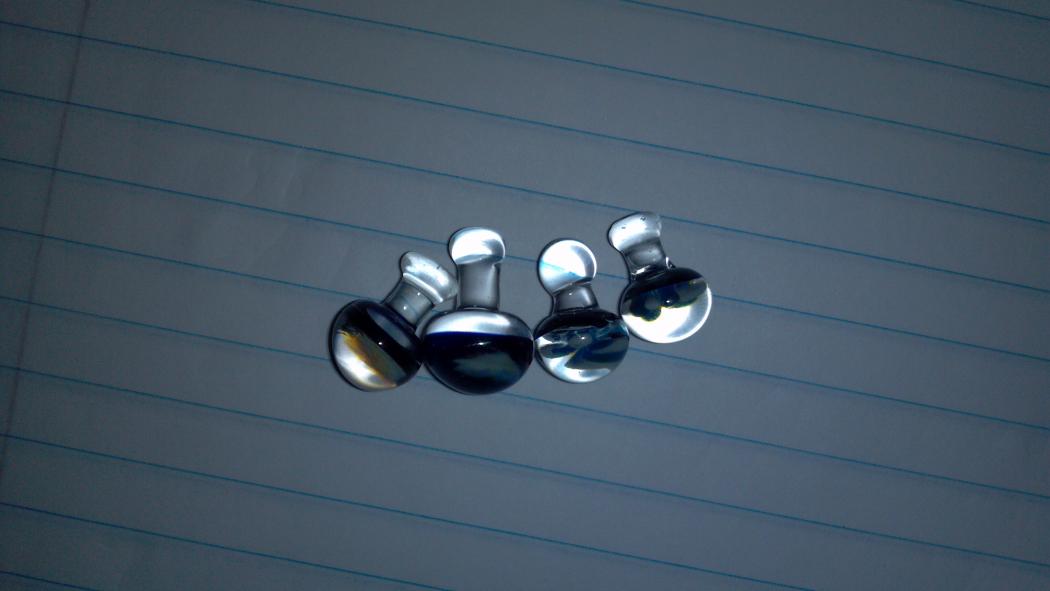

Attachment 45996Attachment 45997
first attempt at using sections and trying to make the gauges hollow w

A reball is a reversal ball. Meaning reversed axis. What you have there is a ball of switchbacks. TO make it a reversal ball you reverse the axis. Pop a hole 90 deg and weld a new blowtube/attach it to whatever there.
Thats what i thought just want to make sure. (i feel stupid now)

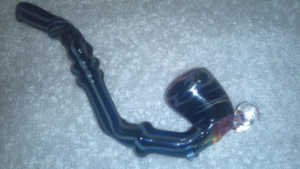

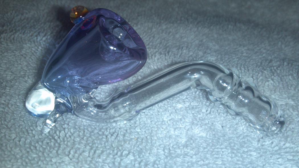

Attachment 46618Attachment 46619

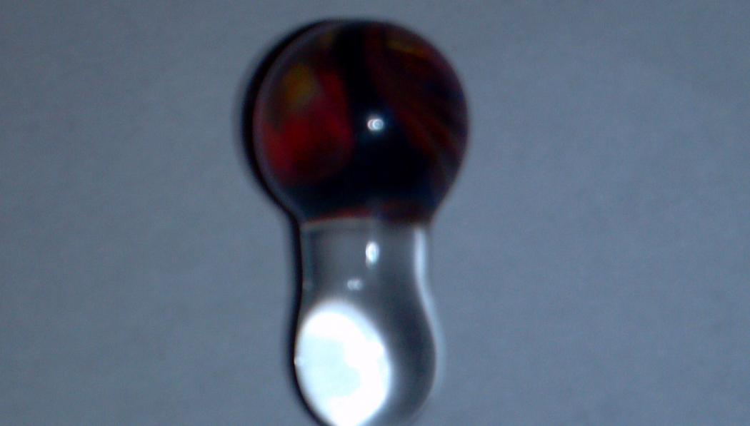

First two attempts at sherlocks. The top was my first victim pour welds and shaping. Not even close to the right ratio of bowl to stem (probably wrong on both).
The second one was better all around better weld, shaping, and size ratios owell lesson one learned.

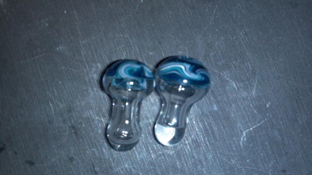

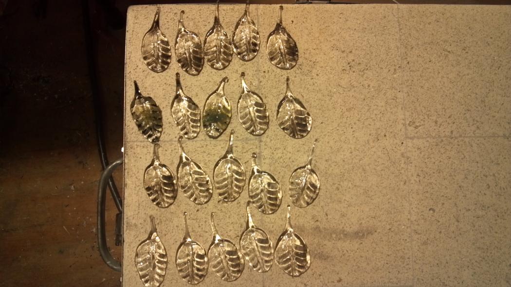

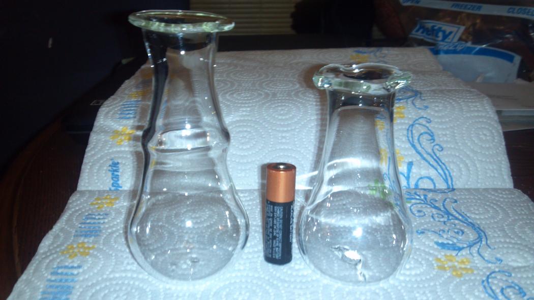

Attachment 47147
Some vases a double AA in between
the cane pulls are some good progress !
I love making vases they are not as easy as they would appear esp to get them clean.
you showed us these two now go in and make 50 more and show us some progression on vases.
I would like to see your inner perfectionist shine a bit more :)
sometimes when i watch my teacher working on things i can also do i notice the big difference in the way we work is he takes great care to make every step clean as hell . i suppose after doing them janky so many times he got tired of it and did that extra work to make it look clean. where i alot of times am just happy to get a piece out that is in one piece so im happy to make a janky one. its that attention to detail that makes his work shine.
keep at it
