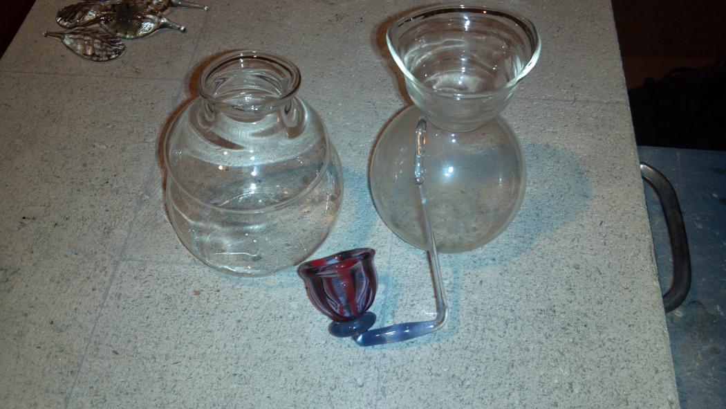

Re: Noob pics *open fire*

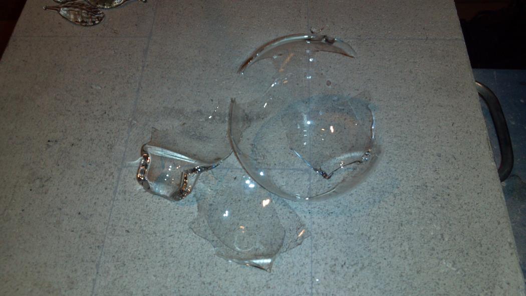

Attachment 42643Attachment 42644
A couple failed vases trying to decide if i should go with a big base and semi short neck or a long neck and small base. The shattered one is a larger base about the size of a softball. The other thing is a candlestick holder idea that i sorta of had on the spot did a better one tonight its in the kiln though and is just clear. Tell me what yall think still crankin the ornaments out.

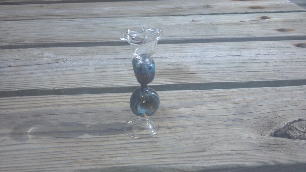

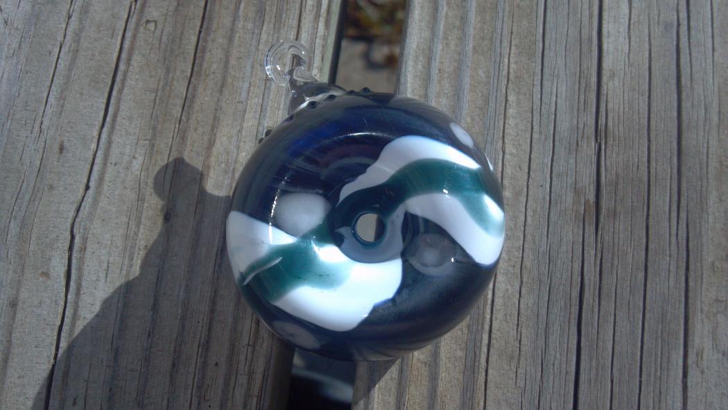

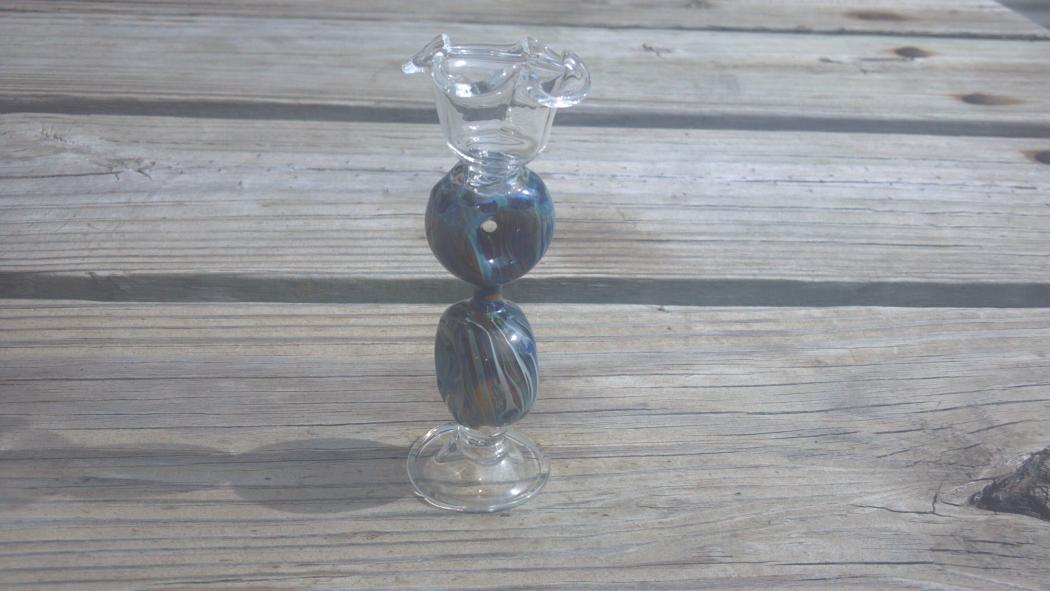

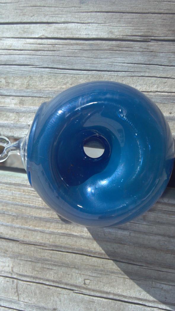

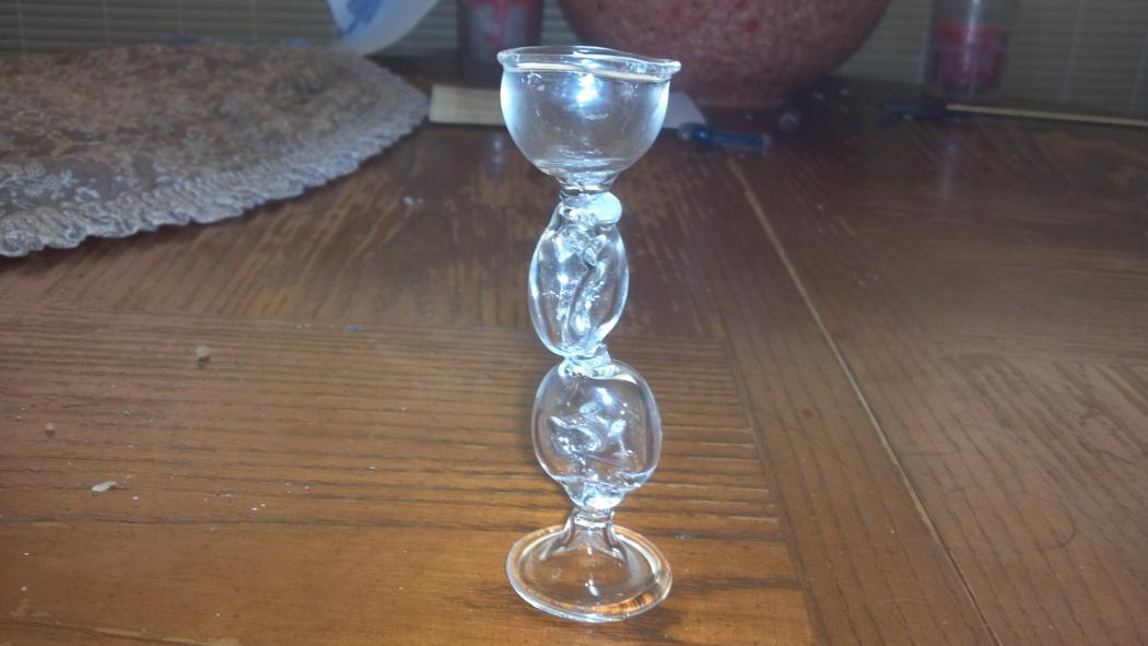

Attachment 42809
Prototype for a candlestick holder. Those are my first two doughnuts. They both have a vaccum in them. Thanks to the guys that wrote on the doughnut pole they turned out alot better lastnight. That foot took forvever i wasnt going to except shit for a foot. Comments are welcomed its not that great but im getting a micro torch soon so i can do the welds better without worry of over heating the vaccumed areas. Thanks for looking.

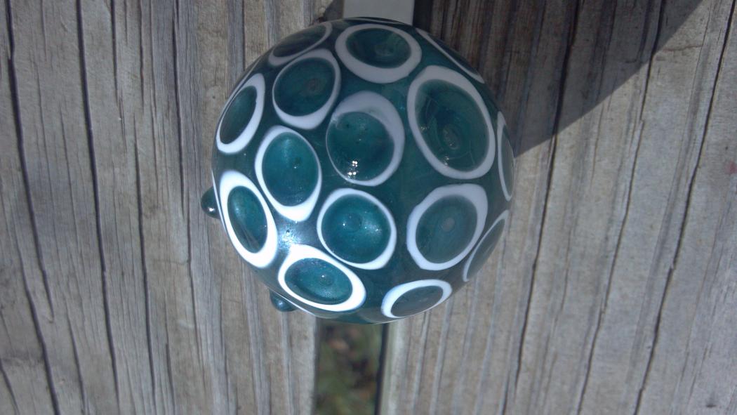

Attachment 43215
My display at the local library not much but it helps get me out into the world a bit more. On the 17th my work will be displayed at the emporia kansas art center. Im hoping to be a permant artist there permitting the show goes well. I finally got the micro torch so ill be posting some pics of my revised misltoe soon hopefully. If there is a relegion for that little guy id like to join lol.

Wow man those candlesticks and ornaments have come a long way! Nicely done!
Look at the difference from 20 days ago to now, crazy...

I find it hard to believe you can't tap in to the pipe market. Even OG artists are now making pipes because its a great market.
None the less, clear or fumed vases will give you similar practice to a spoon.
I will say it one more time, because you seem to be missing it. Stop using color. Every color moves differently. You are giving yourself a terrible foundation for understanding hear base and movement. You must build your foundation on countless hours of clear or fumed work.
I hate holes in my ornaments. I put a restriction where my point/blow tube meets the blank. Shape the ornament. Pull off on the handle side of the restriction and make a loop. The vaccuum sucks the glass in to the restriction where it cools and stops.

The Homer Hoyt style blown doughnuts are cool, I would fume some of them metallic to catch the "holiday"
colored lights and reflect them back.. ;)

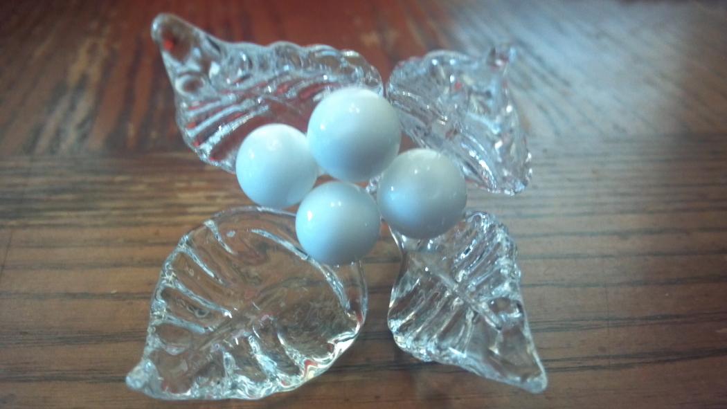

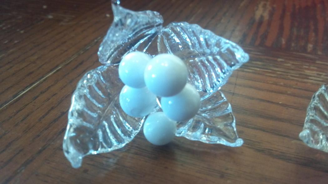

Attachment 43232Attachment 43233Attachment 43234

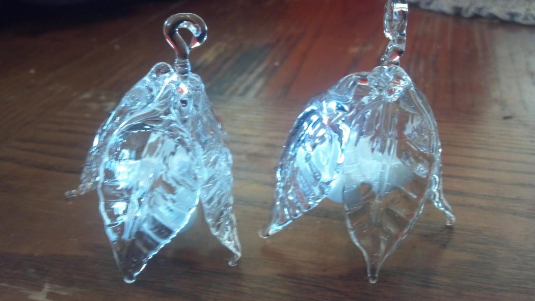

Heres the new way im doing the misltoe. Im going to try putting them together in a different manner to make them look seemless.
