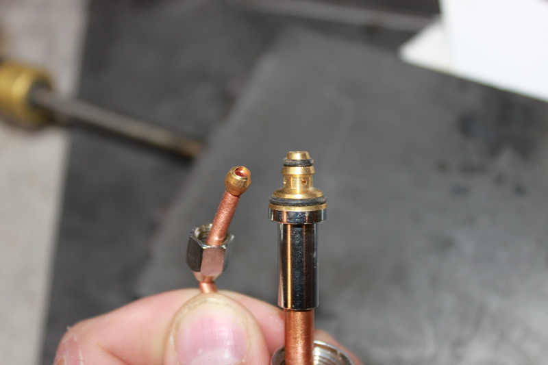

I posted this info in another thread, but I feel it should be here as well to help clarify a few differences between the Compact and the Gentec Small/Smith torches, so here is a copy:
I want to address this real quickly, as the difference between the Compact and the Small/Smith is something I get asked about all the time. The Compact has the same handle and knobs as the Gentec Small (which is a copy of the Smith), but after that is a different torch. The reason I love it so much is it is designed like an actual micro brazing torch, instead of using the hobbyist/jeweler platform.
The Compact uses a double O-ring seal on the tip that is tightened down by hand via the wheel. This is a way more durable, fast, easy, way to attach a tip. The Compact uses the same platform as the Victor J-28, a true workhorse in the industry for decades. In fact, you can swap Victor W-J tips onto a Compact if you are so inclined. The Compact tips also have a mixer on them (one main hole and 4 smaller ones around the collar, while the Small and Smith just have one hole. I think this is one of the reasons (combined with the larger diameter shaft) the Compact's flame is so much more stable and forceful. There is also much more material surrounding the orifice on the tip of the Compact, which means it takes longer to toast one than the tiny Small and Smith tips.
Here is a photo showing the difference:

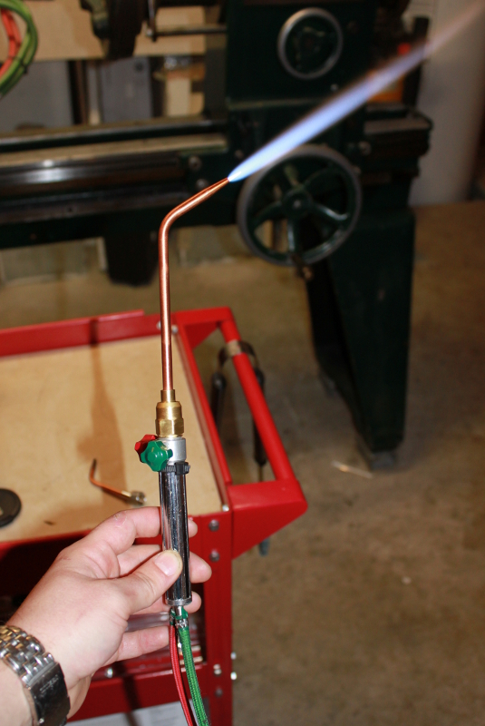

Compact tip update:
So, I get a lot of inquiries regarding different tips that fit on the Compact. While they do their best to not explain it, I found that the Compact can accept tips from the Victor W-J line. I have some tips from Gentec I will be offering soon, that are longer and offer a variety of orifice sizes. I want to order a few more and put them through some testing so I can offer up the ones I feel are best suited for our work.
Here is a quick shot of a #3 W-J style tip on the Compact, it appears to have the exact same orifice as a Carlisle #3 centerfire. Notice it is longer and beefier than the normal Compact tips.

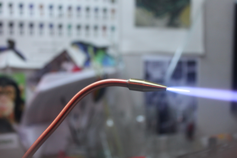

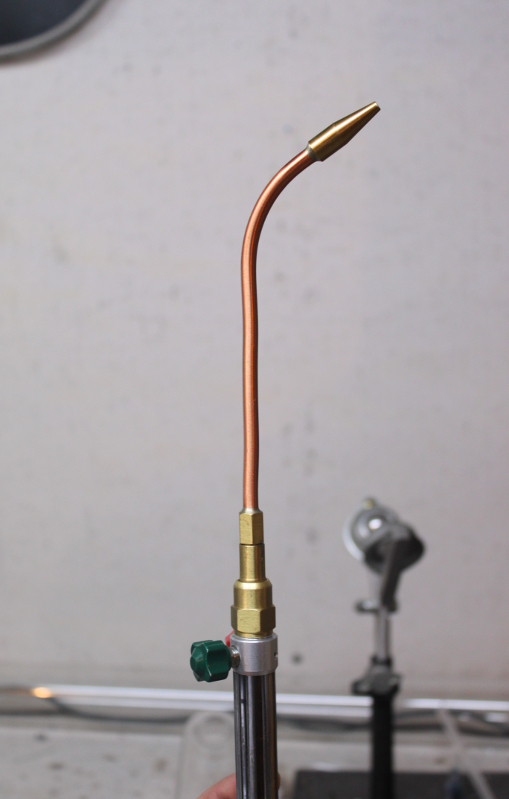

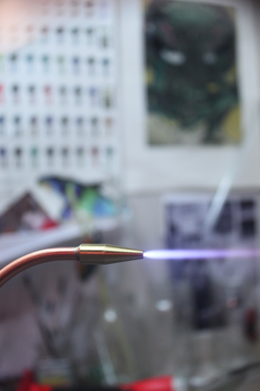

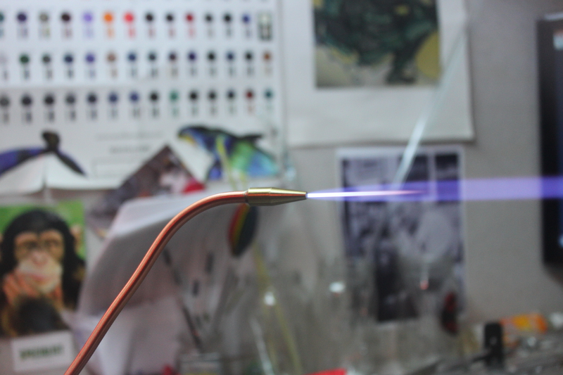

I now have an extension tip for the Compact available! It is 9" long, and is flexible so you can shape it how you want it - perfect for you in-kiln torchers and those who wish to overcompensate alike. It has a #6 sized tip on it that is actually really nice. It is has a softer touch than the #7 or even the shorter #6, but is still really stable and really hot. We have been putting it through the paces here in the shop, and we really like it.
So, I will be ordering some in my next shipment. I will be selling them for $29 + $6 shipping, so $35 shipped here on TMP. If bought with a torch you can save on shipping. If you want one off this first order, please message me so I can guarantee you one.
Here are some pics of the tip and a few flame shots, it has a really nice range.

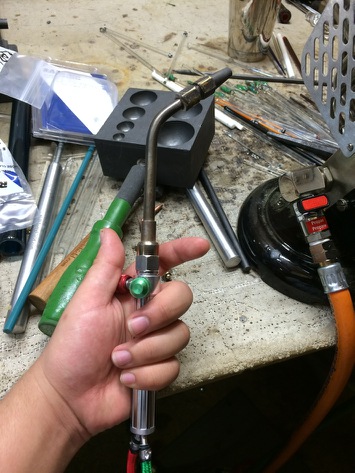

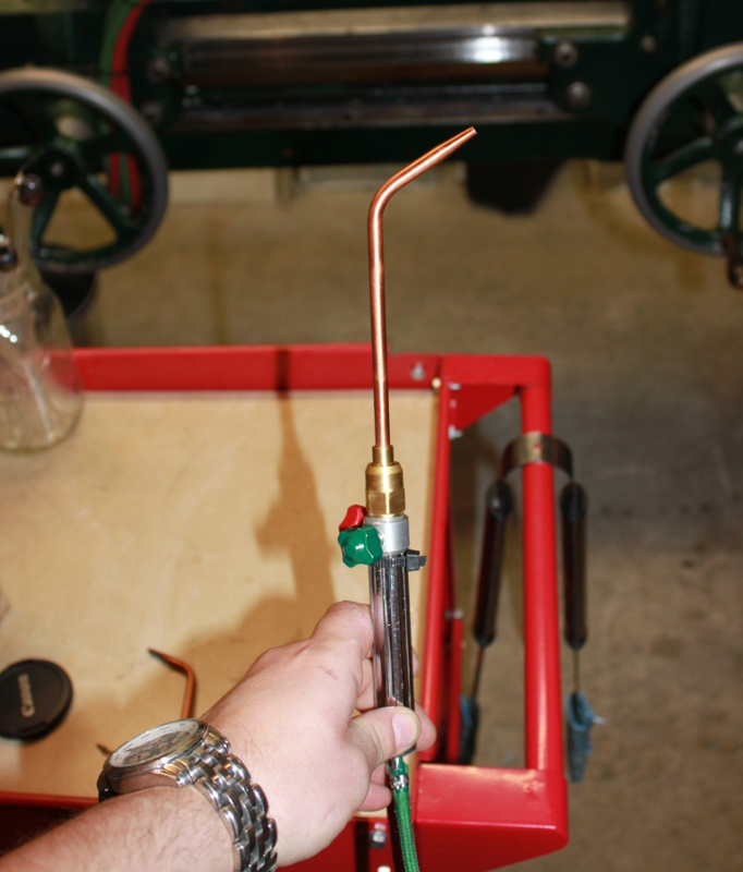

Here is a photo a customer sent me of one of his old Victor necks on the Compact. Thought it was cool and worth sharing. I have both Compacts and Small Torches in stock, so holla if you hear me!

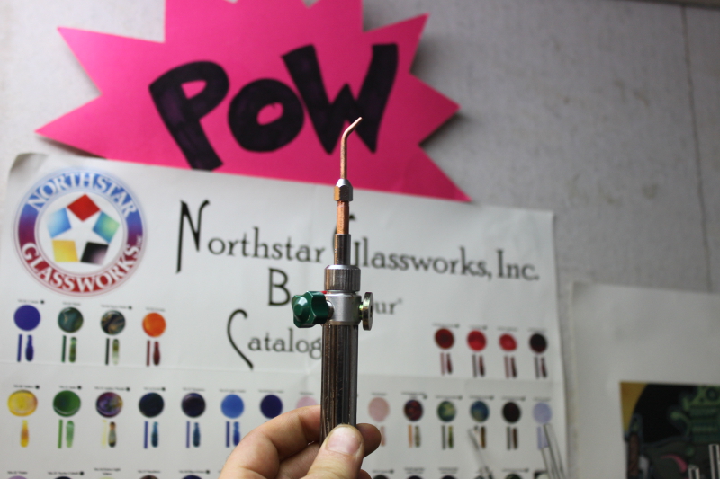

Sneak Peek: Small Torch tip on a Compact.
Aftermarket tips that fit on the Compact with the added stability and thrust from it's mixer? Yes Please!
(Onomatopoeia sold separately)
