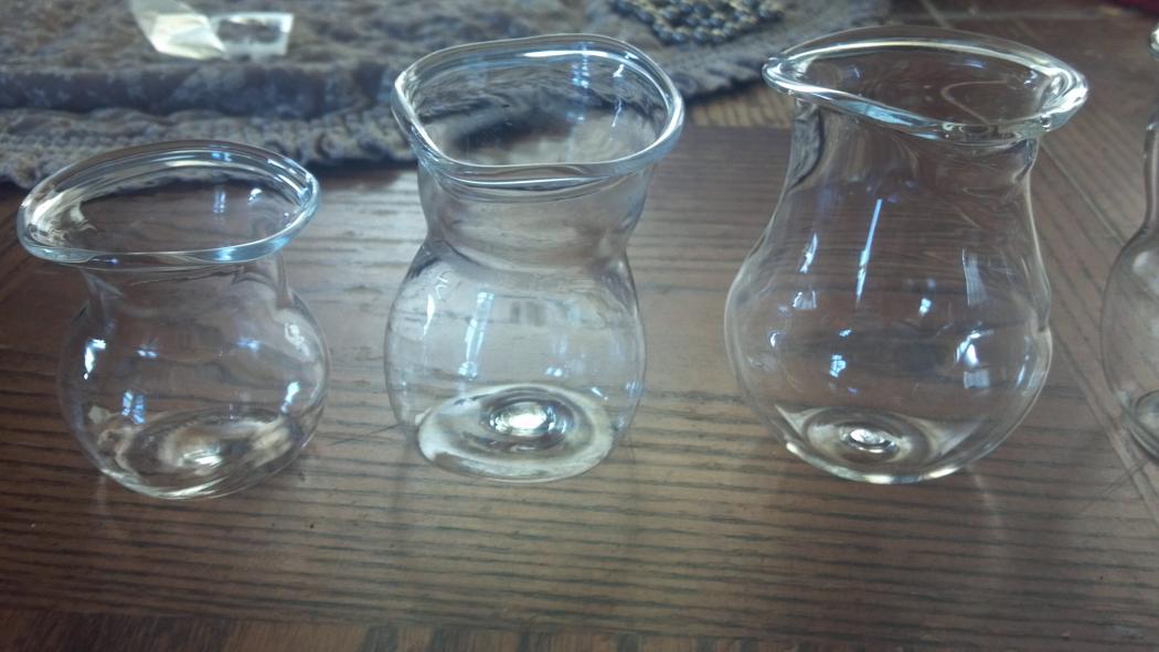

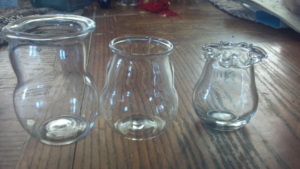

Attachment 43461Attachment 43462
these are the vase attempts i did last night.

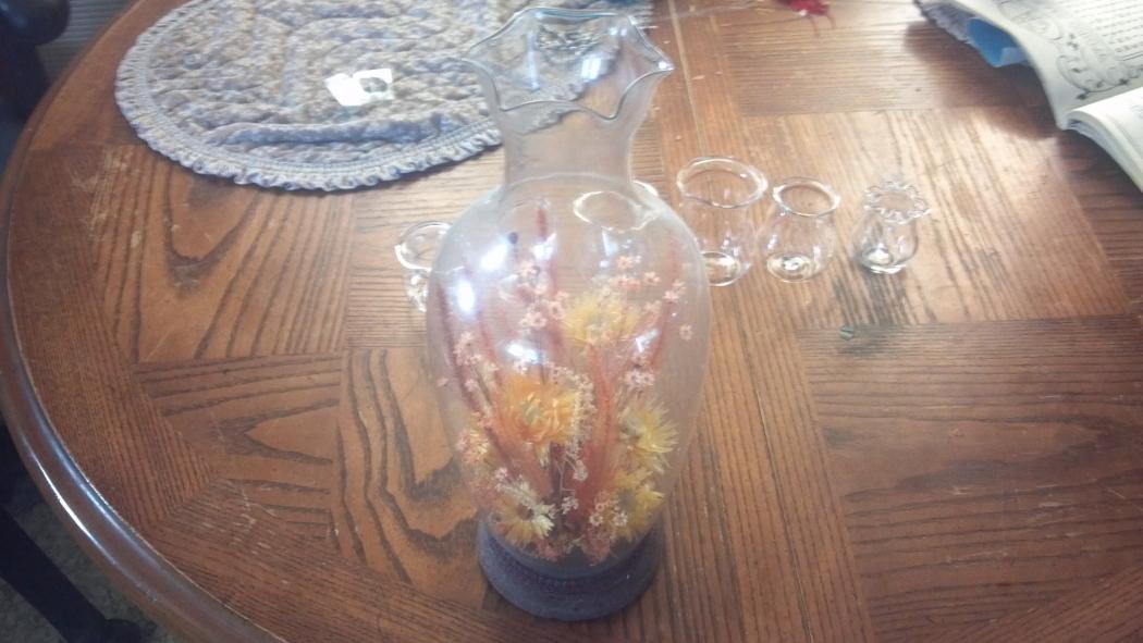

Attachment 43463
this is the shape im after. Someone left this at my house before i moved in.
What size tubing are you using for those vases ?
32mm x 4mm its all i have for now tonight im going to try for bigger and not be so afraid of it failing
Cool I knew if must've been bigger than the 25mm I was using kuz if I blew it out that big it'd be paper thin.
Good luck tonight dude.
You can go huge off 25, and it is actually an important skill to be able to blow a large bubble out of smaller diameter tubing. Condense your tube down into a thick egg using gravity an light puffs to maintain an even wall thickness and shape. Once you have a large enough mass blow that shit out! If you are still having issues you can condense smaller bulbs then combine those before blowing out. Hope that helps.
