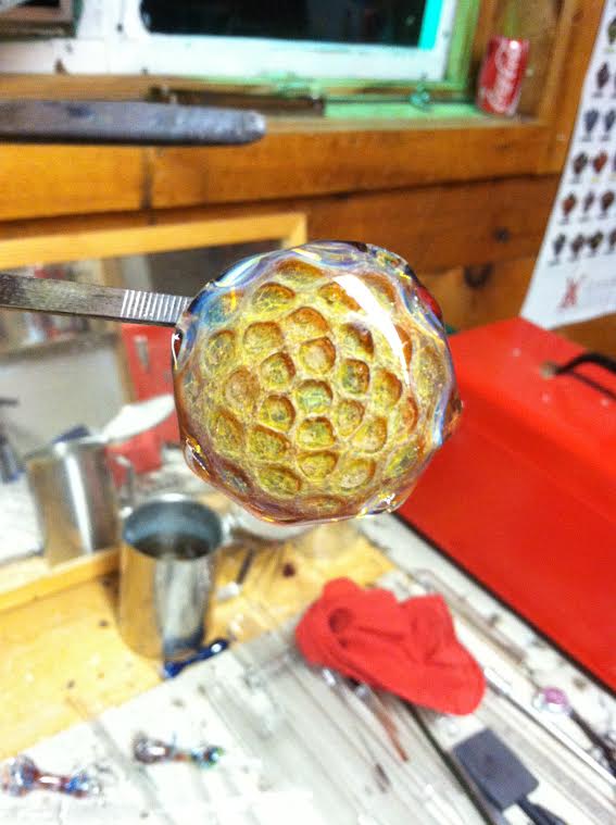

had a buddy in the studio the other night, had a relaxed session. trying to take it easy lately. heres a honeycomb and a onie, my apologies for the terrible photo.
Attachment 65288

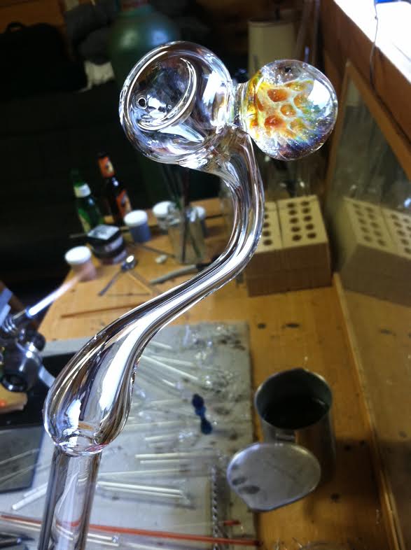

trying to get sherlocks down. One of todays with a honeycomb mib. I wish the honeycomb came out better but I didn't blow out the bubble even.
Attachment 65345
Re: my progression
The shaping on that thing looks great!!
Re: my progression
Thanks AC. I have been trying to get a decent sherlock for a while now. This torch is helping me big time. I have not really attached marbles to my pieces yet and I think this one might be protruding a little bit. I don't have a marble mold so I am trying my best to keep a round shape.

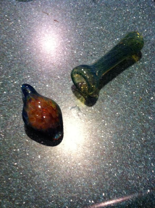

Made a few fumed honeycombs. Still need a lot of practice to get them to pop I guess. I like the look of the double amber frit honeycombs. Still having a lot of trouble with overheating the glass, like the io frit spoon. Looks aweful. Still having trouble getting that double amber frit to pop purple. I'm using a oxy rich flame. Not sure where I am going wrong?

Those honeycombs are looking tight man!!! I haven't even made my first one yet so your doing better than me
Re: my progression
check out northstars website, thier is a TON of good info for working all their colors and the tricks to achieve the different variences, deff a bunch of info worth printing t and rereading, your combs are lookin sweet!!!!
Re: my progression
Thanks guys. I guess I just need more time working with double amber purple. Hope to get some cobalt tubing in for some sherlys and throw some fumed honeycomb marbles on them. Need some oxy and propane first :/
Re: my progression
Ohh man that's going to be so sick with that dark cobalt to back the honeycombs on!! Maybe a fumed one on one side and an amber purple one for the other!!
Ohh and about the amber purple I use it in rod form and I've noticed these things about it.
Once it gets molten it goes clear and bringing from cold back up into orange range generally strikes it back to that deep purple. But it also has a reduction thing that it does. It'll kind of boil up the metals on a reduction flame and surface has the glass with purple/silver now I've heard contrary on weather you can reduce colors on the inside of a tube or not.... but I can see a good argument for both sides but haven't worked it enough to know for sure

typically the act of putting clear over AP makes it reduce some, and often a lot.
Re: my progression
The HOT single piece Sherlock tip.....
I would guess you pull the shape of the lock with a tube handle on the mouth piece. ( rod on the bowl head)
Try to pull a lock with the tube on the bowl head ( no bell yet )and a rod on the mouthpiece.
Pull it so the bend is closest to the floor. Handle up most of the time it's still hot. ( yes you have to move it around and finesse it still)
Yes it is a pain to put a perfect bell on a pre shaped lock .... But way worth it for the final shape you get in the end.
Also , starting with a thicker diameter /thickness tube right before you hot shape it always helps me.
This may not work for some ... But was night and day for me when I finally figured that out.
Re: my progression
Boro, I blow a slight bubble on the bowl end and punty up. my blow tube is on the mouthpiece. I shape the mouth piece a little and then condense and stretch to make my shape while my punty is upright. Remove the punty and blow a hole then bowl push and carb. Seems to be working great, not sure me putting the blowtube on the bowl end would help my case but I might be confused as to what you mean? Ive had great luck using my method.
