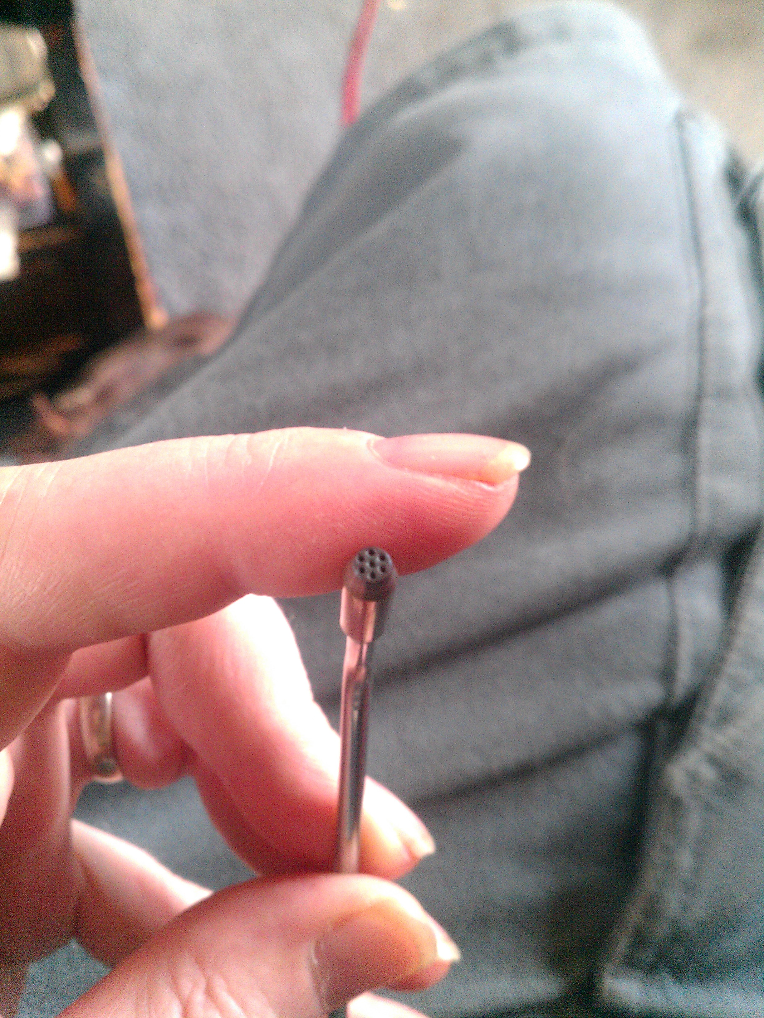

I just had a custom blastshield type 7 port tip made for my compact and it works great! Attachment 77067

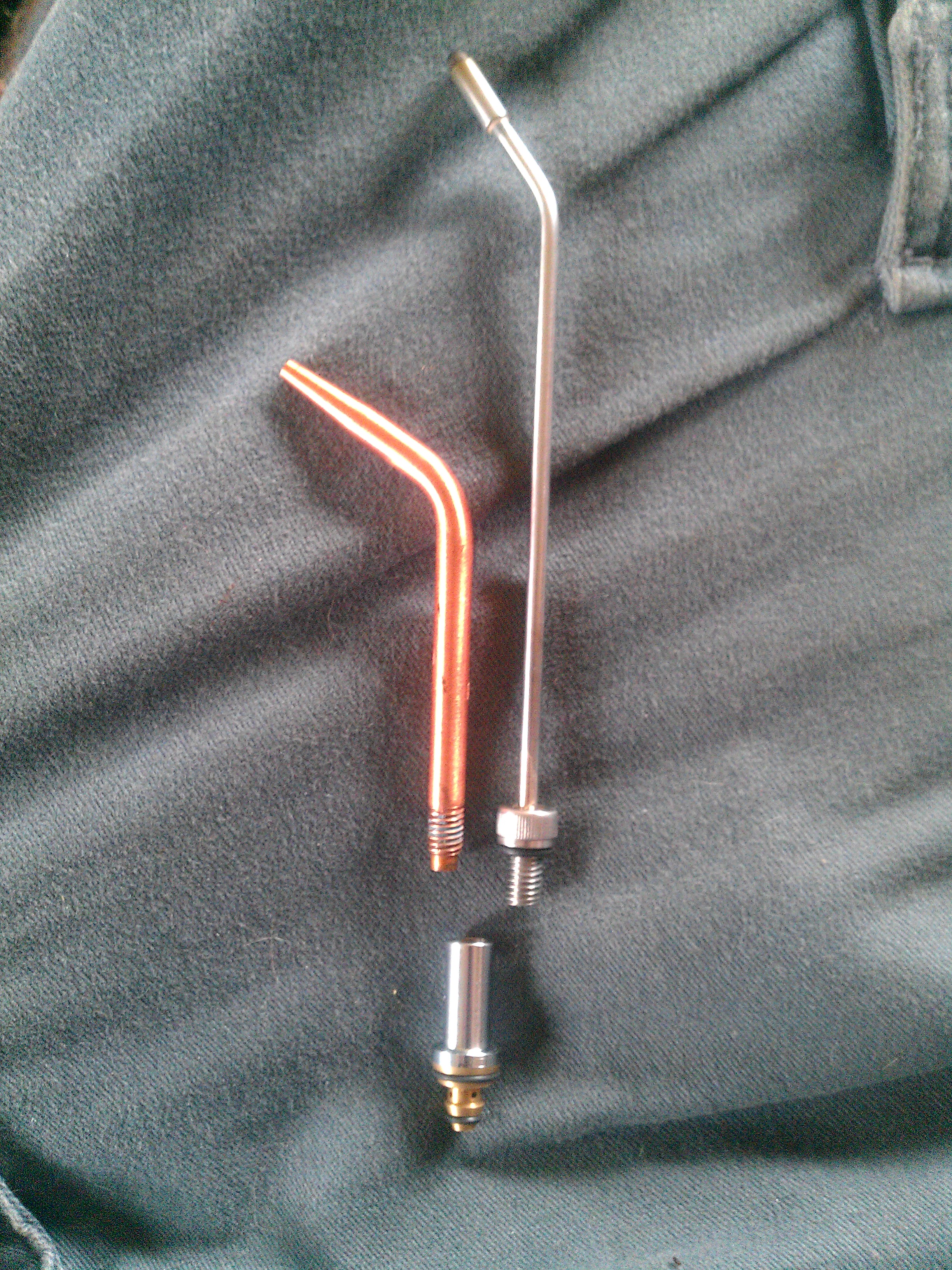

Or acually now that he has the sizes you can swap bottoms yourself and he can just send your tip(Attachment 77068 for compact.

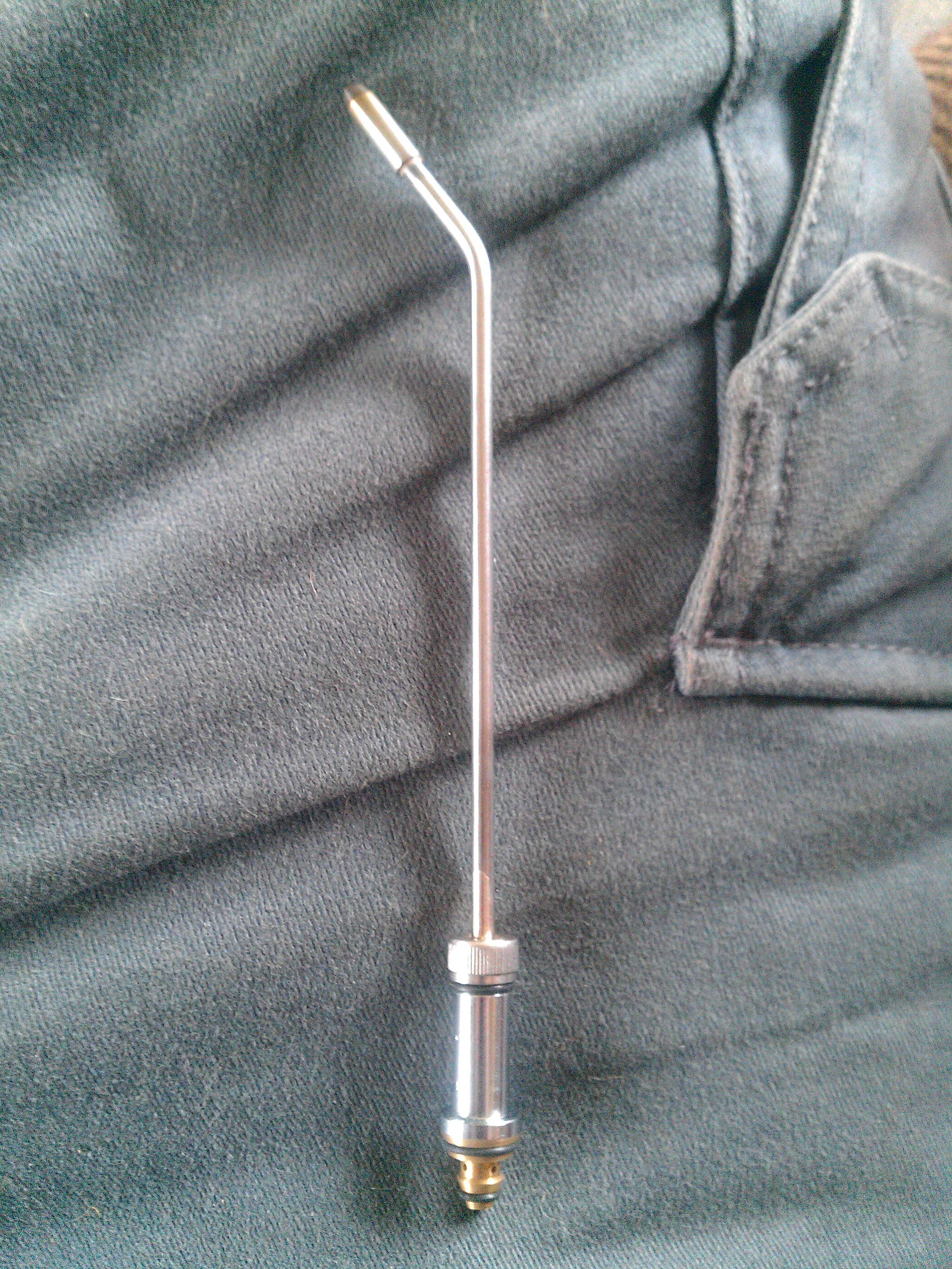

Attachment 77069 I've also had a 7 port tip alike for the small I used to have and it worked great! But this on the compact is more firepower, and I couldnt make it pop or blow out even raging at GTT pressures!

I don't know how I missed this neddo, these are great!
If you want tell him to take that bottom piece from the Compact Torch and make it so that you can thread Smith or Gentec Small Torch style tips on it. I think it is a 5/32 thread? This way you could use any aftermarket tip currently available for the Smith/Gentec Small on the Compact. This should really increase stability and thrust to the aftermarket tips as they have will the 5 hole mixer that is on the Compact.
I made a prototype of this adapter last year, I just don't have the time to dedicate to the design and fab process to sell it but your buddy seems like he would be great for this.
I know there is a market for it as I still get asked about it, and it would make the Compact the superior torch in every facet as the lack of aftermarket tips was it's only drawback.

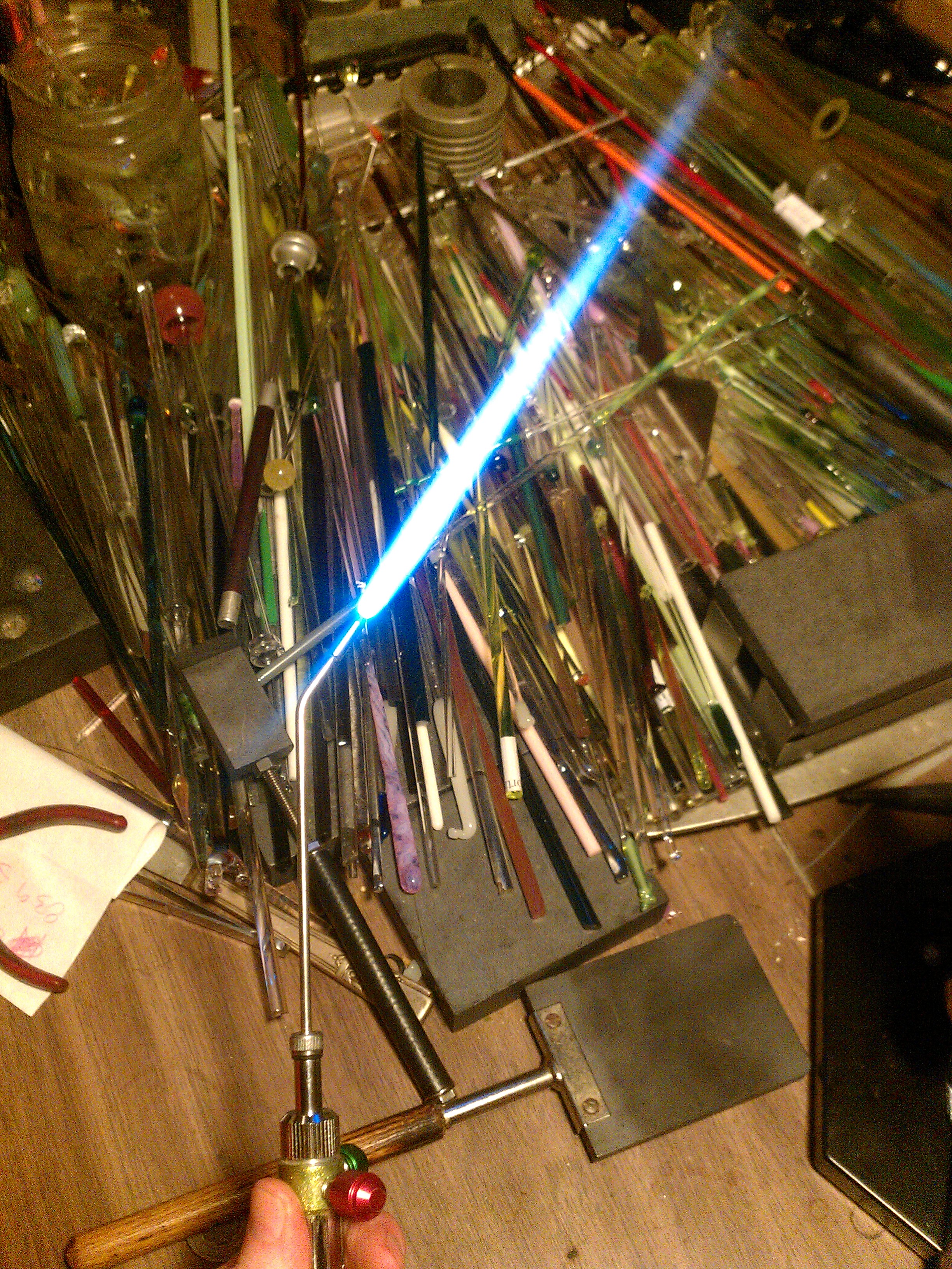

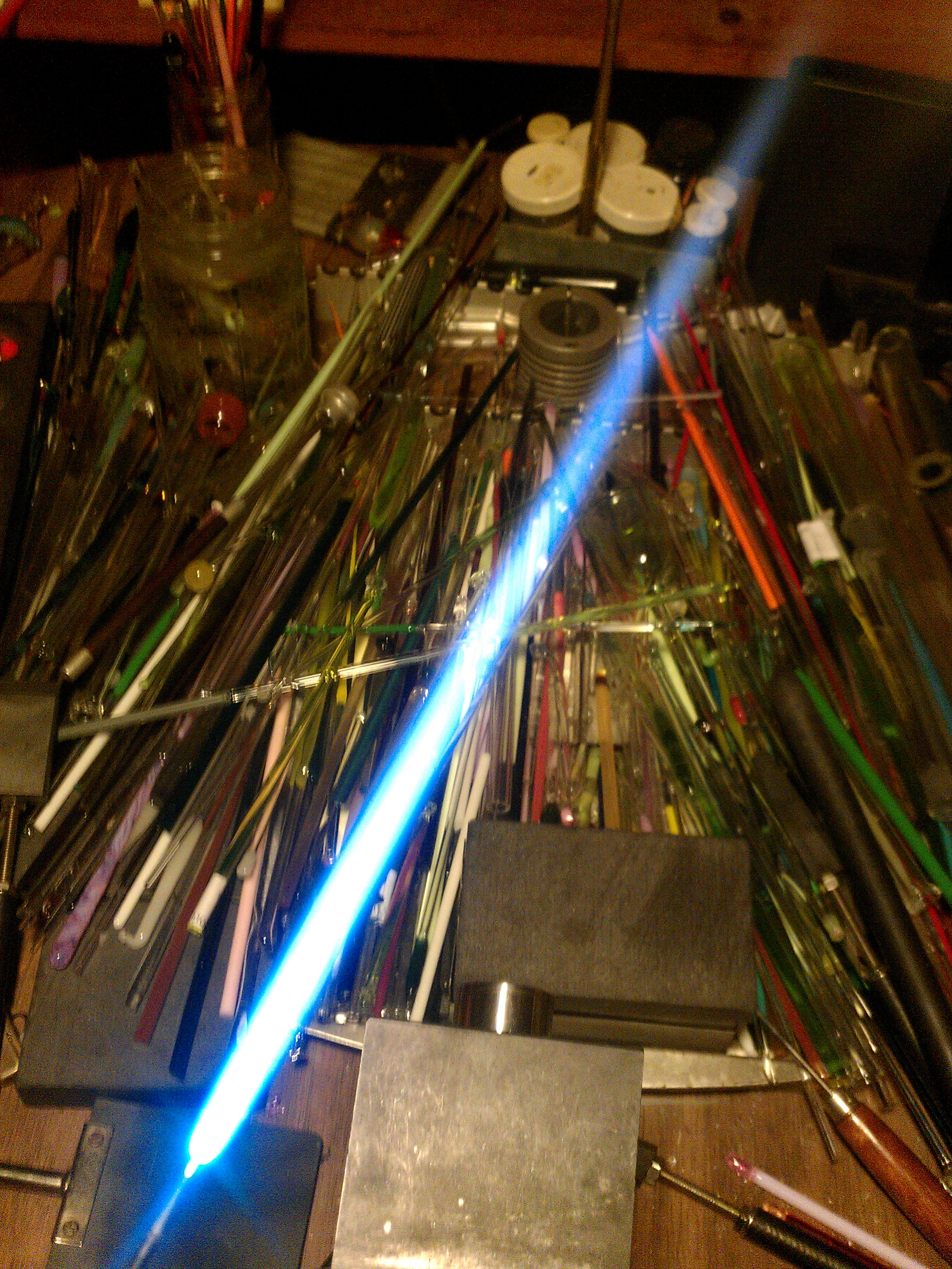

Attachment 77175 Yes I believe Dave can make the adapters, or anything else really! I told him you would be contacting him about this. Tips are awsome, made on cnc for super precise port holes, just top notch! Here's flame pics at 5 prop/ 20 oxy.
