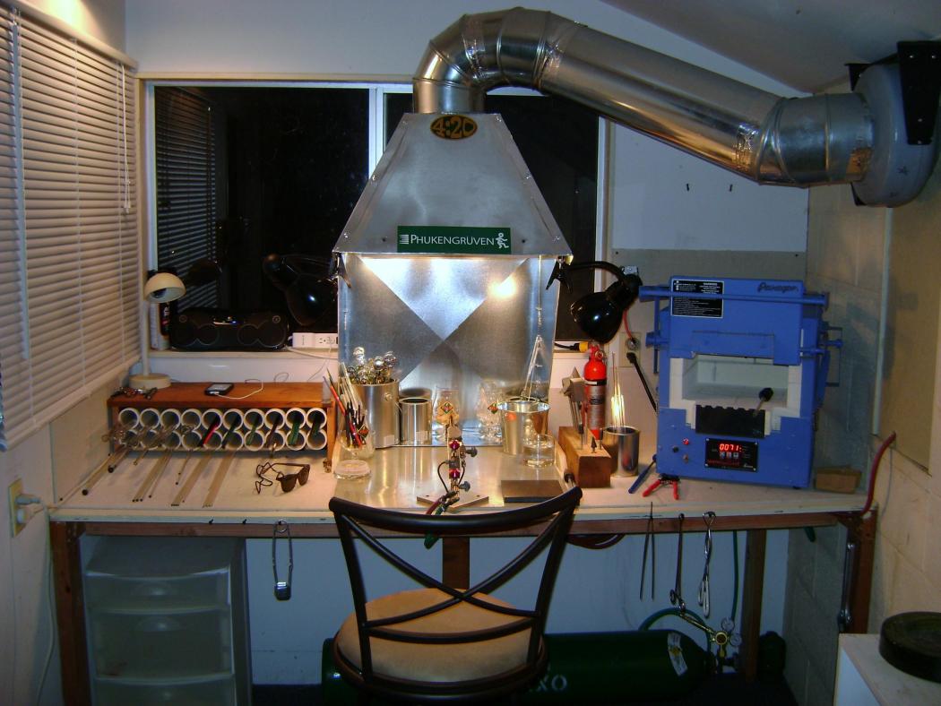

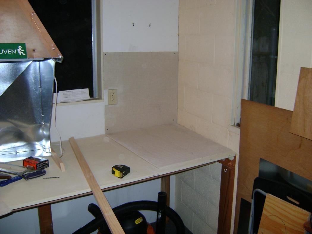

So... I have been at it for about two months. I owned a Nortel major for the last 5 years, however I have never had a place to set up shop. I moved to San Diego from the East coast back in April. I recently moved into a new house that had an out building that was just screaming for a studio. I built out my shop and have continued to add pieces, parts and make improvements as needed. I am self taught so far, sponging up as much information as I can here and elsewhere on the internet. I have spent much time reading posts here and watching youtube videos in attempt to build my skill set. I am eager to learn so please offer any input or criticism you might have.
I also want to thank everyone for their posts here and their willingness to share knowledge with the community. If anyone is located around San Diego please shoot me a message. I would love to meet some good glass folk!
Cheers,
Adrian
~Studio Build

Great looking space ya got yourself, welcome to the pot!

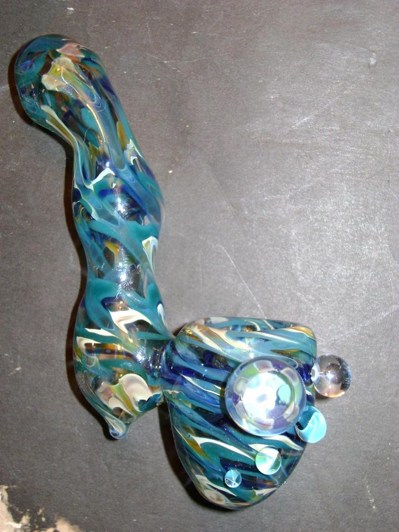

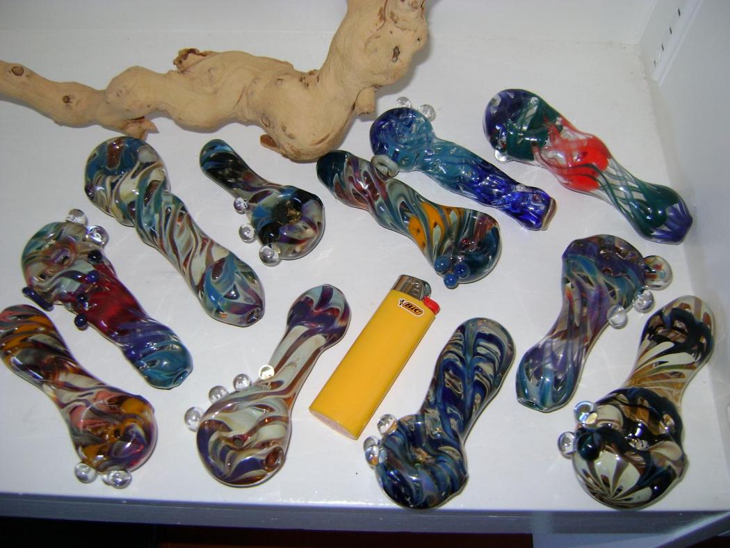

A collection of my better spoons so far... I know its all raked pieces but i need to start somewhere. I have been working on trying to get clean spirals on my bowl and mouthpiece terminations.
Re: Adrian's Torch Progress - Feedback is much appreciated
Practice, Practice, Practice! Lots of scrap but knowledge gained.

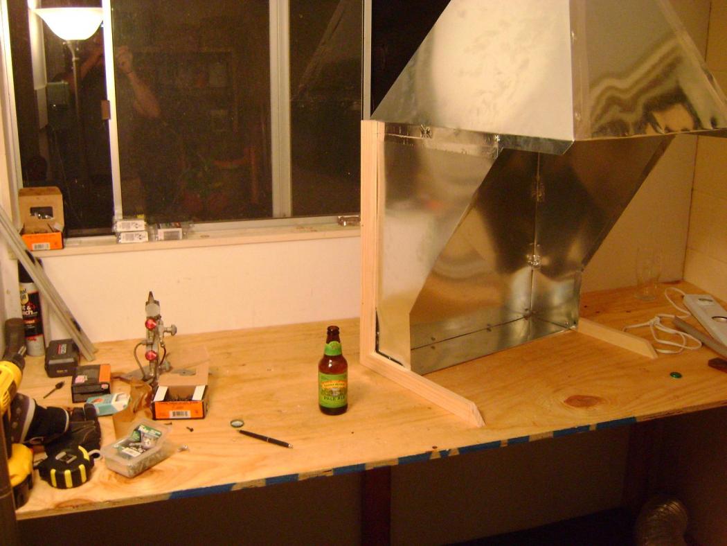

Studio Upgrades.... Scored a deal on a bunch of Tools, glass, and a Carlisle CC that was in the listing. I ended up scoring the CC only used a handful of times for $350. The CC was not originally part of my plan but at that price I incorporated it into the plan.

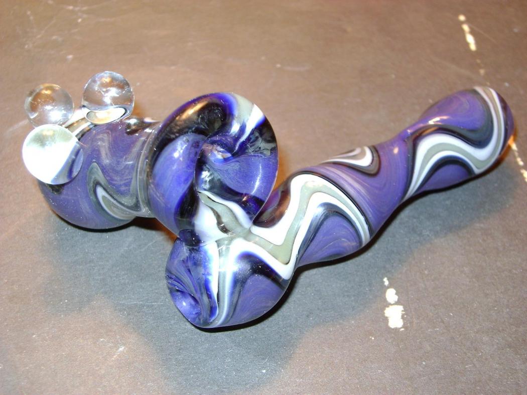

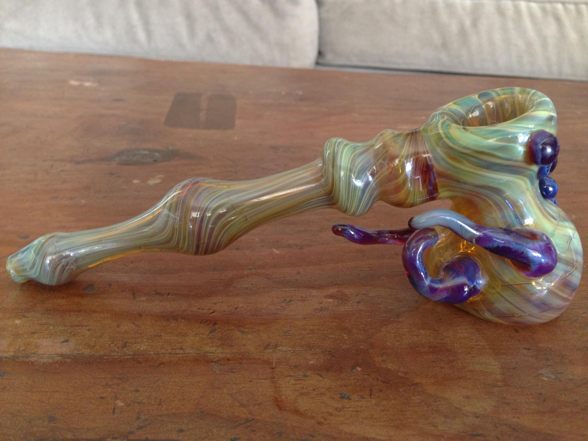

Some New Pieces. I am still working working on getting even wall thickness on the Wig Wags. They all seem to get squirrelly on me once i blow them out. I believe my problem stems from the actual wig-wagging/condense of the pulled tube. I seem to get some kinks, or unevenness when i condense the tube down. Also overworked the purple a bit.

the studio looks cozy for sure. welcome to the get down. things to add....when you shape glass, think of it as a sexy woman. the more curvy, the more appeal. dramatic changes in width, and marked transition between bubbles make for eye catching work.
i might also recommend skipping the reversals for now and just work on shaping and avoiding boily colors like crayons or that purple. ( which looks like a color thats just hard to surface work, so its probably not so much a color you want to use in that way)

nice job. one thing I might suggest is that after you condense and pull the middle, going back and constricting the mouth piece then heating up right next to where you made the nice restricted area where your mouth will go and pulling that kinda thin. then go on to finish your spoon and after you are done you will have next to no work to make a nice looking mouthpiece that doesnt go all crazy as you try desperatly to fix it and make it look right.... I hope you understood that because it took me a long time to figure it out and about a thousand shoddy mouthpieces

I really like your set up, especially the smooth vent ducts, very efficient. I think you're right to go with the 8" Max Can Fan. I've used the 15" and the 10" and they are the bomb.

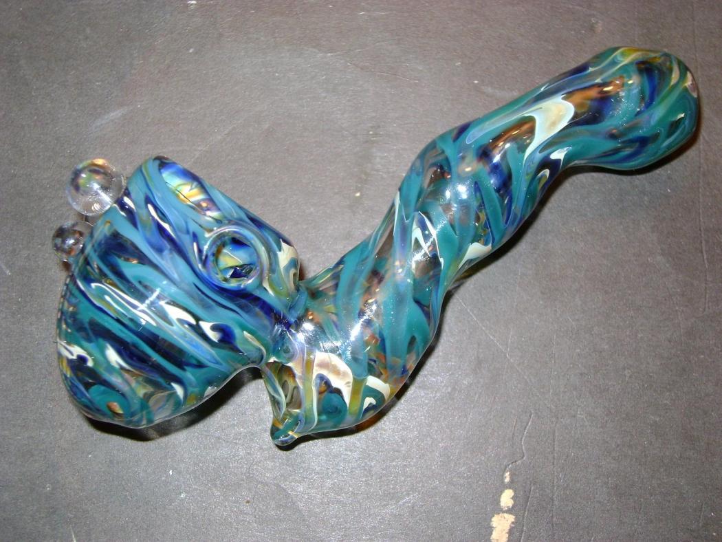

Its been a little while since I have posted anything so I figured it was time to get back at it. Unfortunately work has been super busy and I was slow in placing a glass order so I had a bit of down time on the torch. Since my last post I upgraded my ventilation to a point where I feel comfortable fuming. In addition I also built a foot pedal. I have been stoked with the two upgrades!
Most recently I have been experimenting with different fume techniques and applications. Most of what I have done has been surface work/Fume. I have messed with a little bit of IO, however my results were rather disappointing.
I appreciate the advice that everyone has posted. I have been at a little bit of a crossroads on the mouth pieces. I currently have the most success blowing out the mouth hole after drawing on and melting in my pattern. Then I punty up with a warm/cold?? seal and shape. It makes much more sense to pull a thin part at the mouth, fire cut and pick, however i seem to mess it up when i pick the hole. From a time perspective the pull and pick method would be much faster and streamlined. I need to just keep trying until I make it work.
I have been working on my shaping but it still has a way to go. I like the "Sexy Woman" comparison. Its funny but its so true.

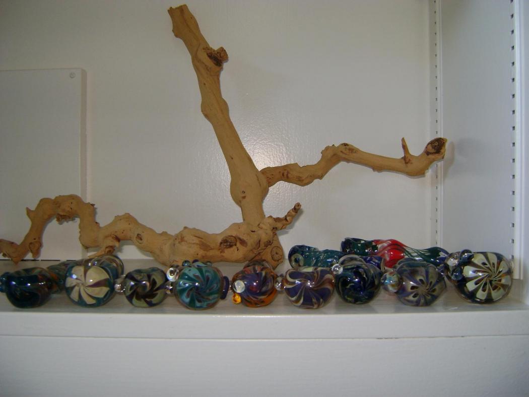

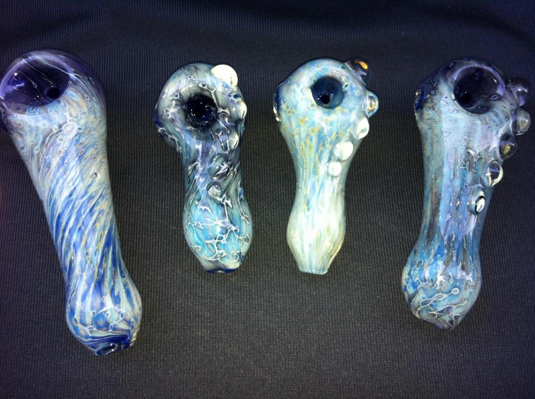

Below are some of the pieces I have been working on. Sorry about the 90's wrap and rakes. i know that they aren't all that desirable, however they are good practice for me.
I am really happy with the last pieces. I started messing around with the air trap lightning effect. I love this look and I feel like they are a nice step forward.
More to come soon!

Of the Air traps this little guy is my favorite!

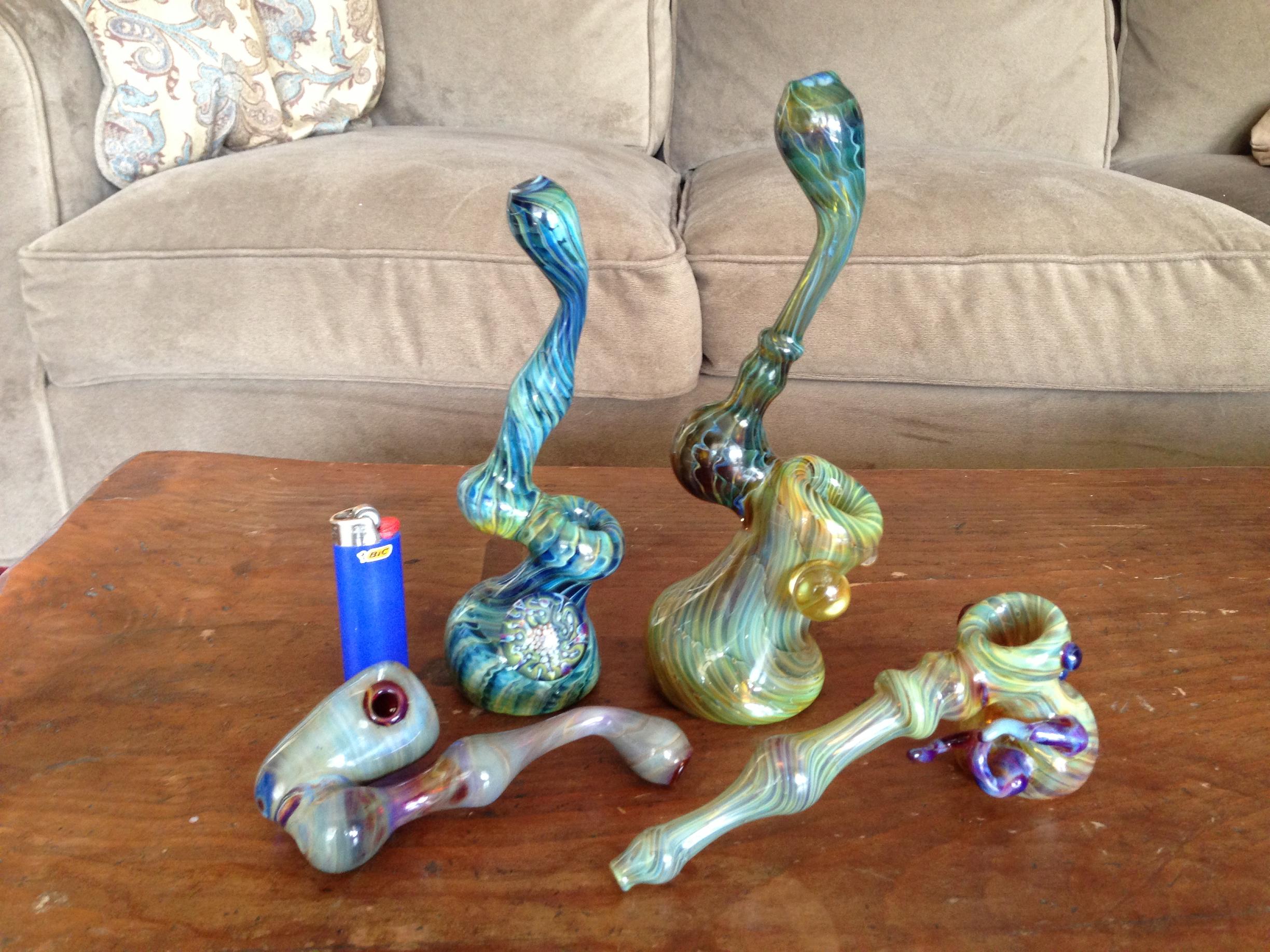

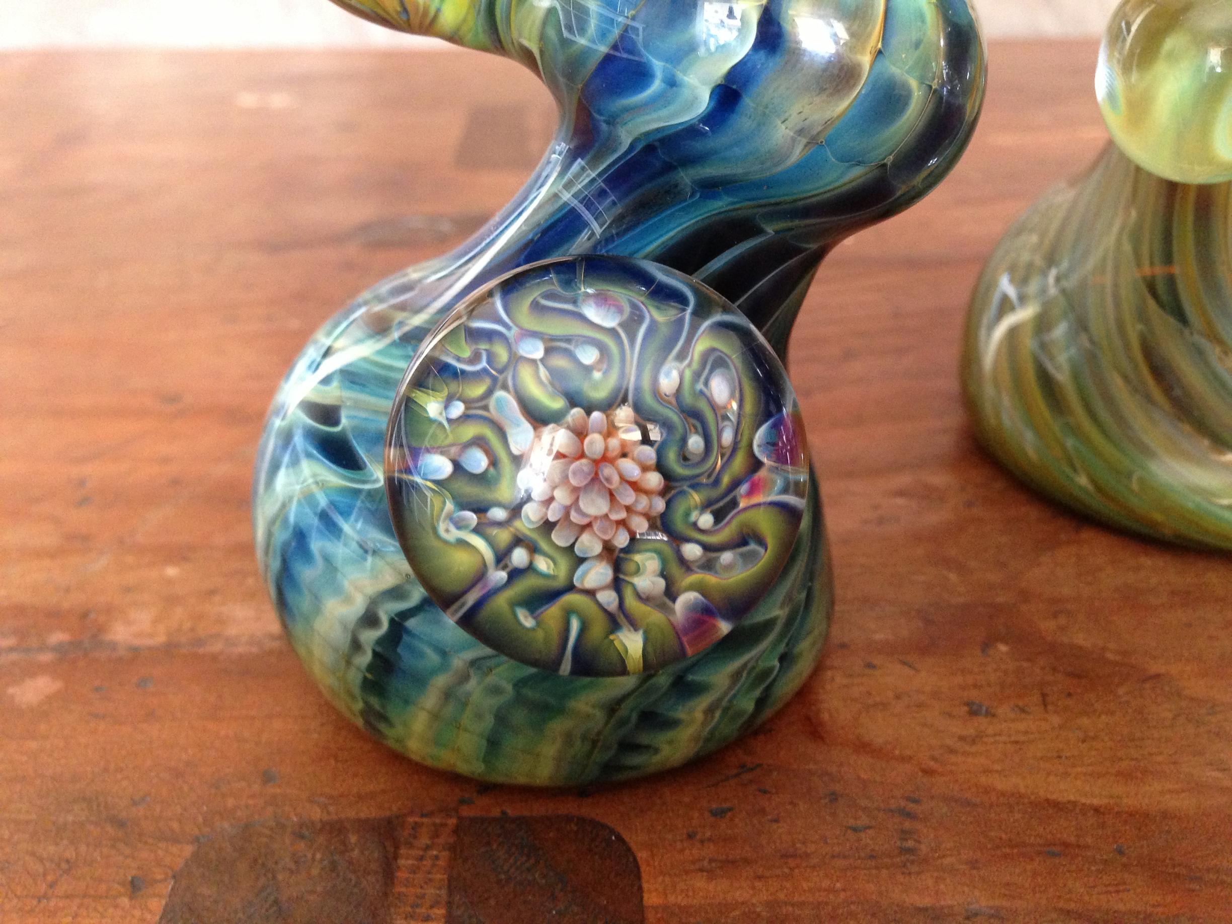

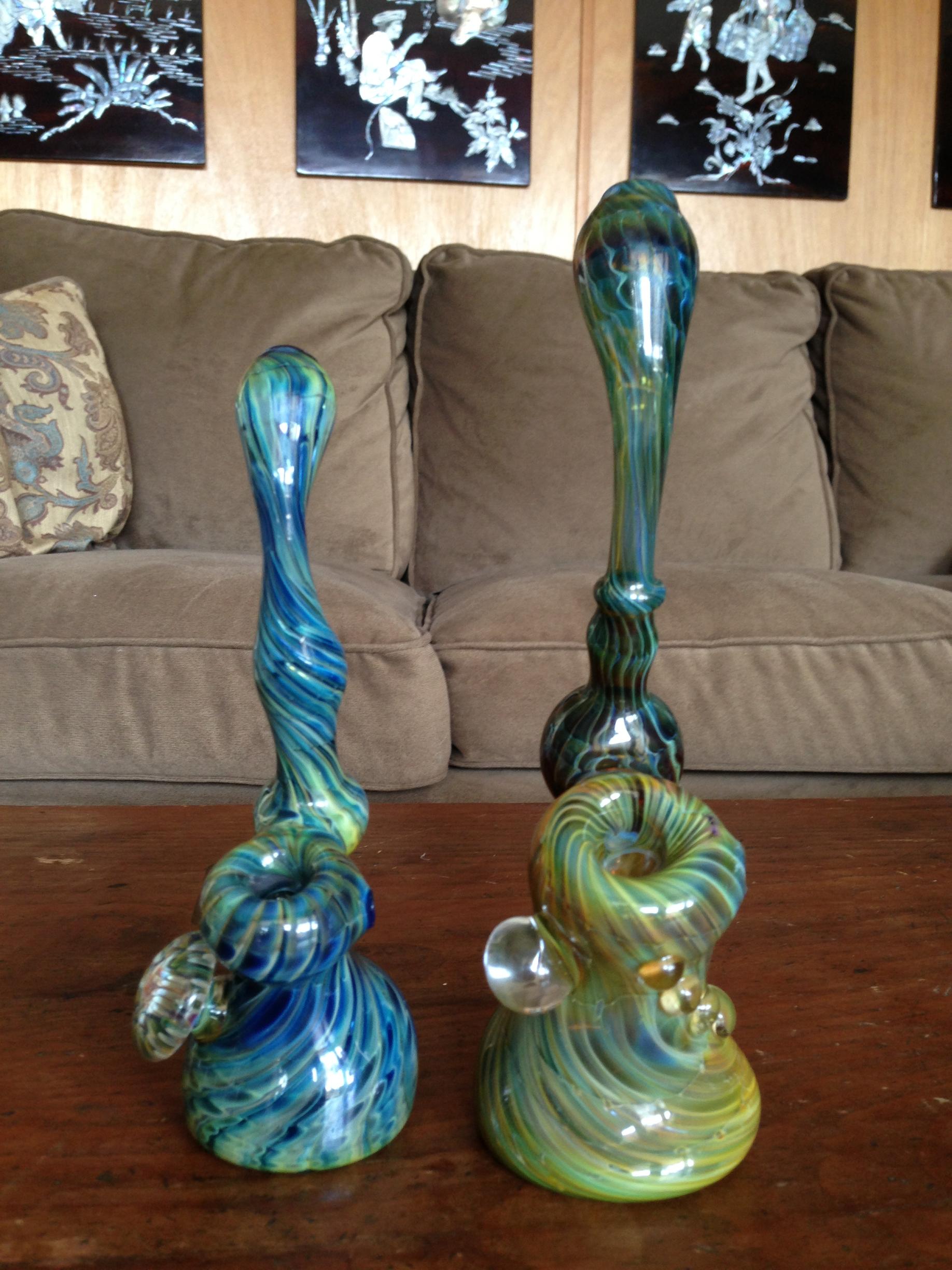

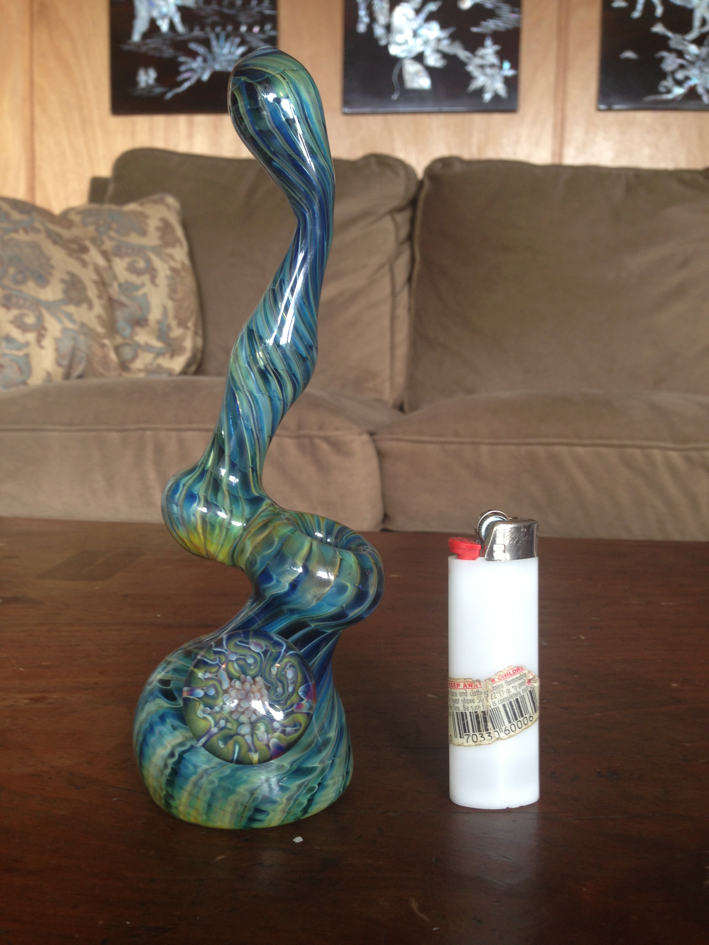

I haven't been on here for a while so I figured I would check in, say hello and update my post with a few current pieces. Attachment 62117Attachment 62118Attachment 62119Attachment 62120Attachment 62121
Wow, those are rad progressive pieces. Are you still part timing it here in San Diego? The magnified view on the darker bubbler is mesmerizing.

cool attachment on that blue bubbler!
