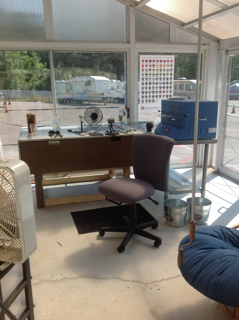

Any way I have some pics of some pipes and my studio space in my home. Please feel free to give some input I just want to get better so be honest you will not offend me :) my mouth pieces need serious help. Can't seem to shape them right. And I am really lost on bowl depth.
I have used the search bar so please don't lecture me on that. There is a lot of info here but not always easy to find. And some times I don't even know what term I need to search for.
I have been wondering what I'm doing wrong in that it seems to take me about 2 hrs to make any pipe with color. It may be I'm using to thick of color or my torch can't handle it. But I'm sure it's just something I'm doing wrong. I'm on a lynx and using 25.4 heavy wall tubing any thoughts would be appreciated.

All the glass doors slide open and so dose the glass roof. I have a fan behind me and one on table to push out. I would think this is good ventilation.

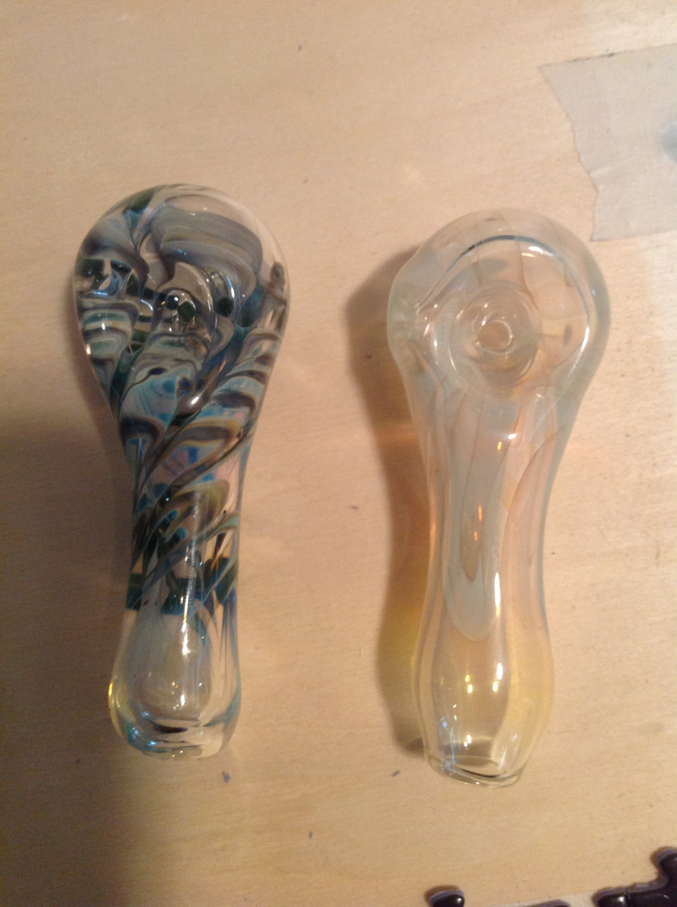

Man, I'm no pro by any means, but my roomate is and I have been to a lot of shops. I have to say from my experience you must increase your ventilation and make it directional. It sucks when the wind hits your flame from the side and pushes into your fingers or hands or something.
Your pipes look cool man. Did you start with rod first or did you go straight for the tubing? What is taking you so long for the pipes? You have to elaborate a bit more, I can't amagine what is taking you two hours :twitch:
My limited hands on experience but long time exposure suggests that you start learning to make marbles and pendents so you can learn some basics.

Really? I was sure it was enough ventilation. When the doors are open I'm practically outside. Plus with the fan at my back and one in front of me if I light a cig I can clearly see the smoke push out. I's there a reason u think this is not enough? I am seriously concerned if so I do want to be safe.
As far as time goes it just takes forever to melt in the color so that it is smooth an completely melted in. I don't know why as I see others on videos do it much quicker.

Outside is not the same as ventilation. What you have is not adequate at all.
I suggest you do some reading here on the subject.

turn up that lynx and get that glass hot! the lynx is a mighty torch and will easily take down a nice size chunk of 25hvy even if you add color thats thick...no reason it should take 2 hrs to make a simple w&w...turn up your torch, slow down your spin, keep your glass in the flame and work in a nice even heat base, but seriously turn up your torch...the lynx is beast mode...decent start...and yes your ventilation sucks...
Re: Ronnie's progression thread
When you say turn it up do you mean oxy or propane? I always hear it start to hiss alot and blow out the flame when I try to crank it. Also I REALLY appreciate any advice but so far that's 3 people telling me my ventilation sucks but no real specific reason why which is not helpful at all. I will glady fix problems if I know what they are.

A 6 inch office fan blowing at a sliding door screen isn't proper ventilation. Safety first, I would take ventilation little more serious and do some upgrading.
The hotter your flame the faster that color will melt. Turn your knobs up for more heat. However an even heat base & control is everything.
Spoons are looking good though for self taught, keep it up but fix your ventilation setup first, then keep spinning.

find a way to build an insert into the door so you can mount a more powerful fan. mount the fan to plywood vertically maybe with the fan on top and open the door a little and drop the fan in when you work. or find a better space. That whole space looks sketchy inside a house. Dont drop hot glass on the floor in there or blow up your torch. seems like you should do even more research about safe setups before attempting to work alone.

^What he said. Open/remove a window/door and fill the space with a sheet of plywood with an attic fan in it. Point torch towards fan. Open up a window or door behind you somewhere.

What do you mean sketchy? It's got a concrete floor and is as close to being outside without being outside as your likely to get. So what looks off to you?

This doesn't make sense to me( though admittedly I don't know much lol) why would I close off a fully open space that lets air out( only a metal screen in open doors) wouldnt that block more air from escaping?

No. You're shooting all the toxic shit right at the fan. It's grabbing it all immediately and pushing it out. You can even build a box around the fan to make sure you catch everything.\

What about just mounting a more powerful fan to the edge of my work bench and not blocking off window?
It'll be like 10% as efficient so, no.

I don't understand why it would be less efficient. Same fan only a few inches closer to me and a whole door to vent out of.
Also what fan. If I have so many open doors do I really need a fan to replace the air as well?

You're not getting the core concept here. You should do some research on fluid dynamics and then come back and try again.

Iunno about a musty smell. Poor ventilation smells like an indoor pool. If you set a smoke bomb off under your torch every last smidge of smoke should form basically a stream to your fan and immediately exit. In regards to what other windows you should have open, as I said in my first post in this thread, One behind you somewhere will be enough. You want to form a wind tunnel basically so that everything is flowing towards the fan.
Research general fluid dynamics. There are HVAC calculators that will tell you how big of a fan you need. I already told you an attic fan would work in this thread.

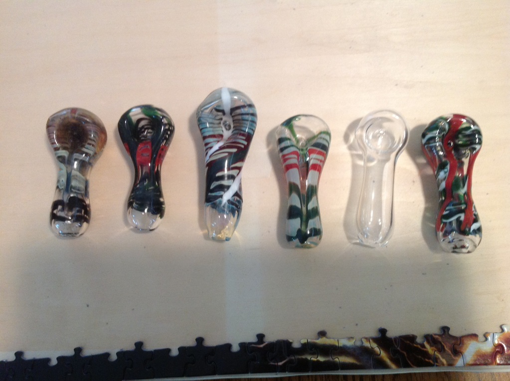

Also Ronnie, those spoons are looking good. I always like seeing color melted in nice and well in early work threads, its a rarity to see! Granted, I'm not sure why its taking you 2 hours to get there. The only question I could think to help figure it out is, if you were to make a completely clear piece out of 25x4, how long would that take? No color, no fume, no nothing. Just clear glass, pull a stem, puff out mouthpiece, blow bowl bubble, pop hole(s) and push bowl, finish mouthpiece, voila. What's the time for that? Lets not forget about the ventilation issues, but I'd like to know why your spoons take 2 hours. I now make in 12 minutes what used to take 25, and I can make in 30 what used to take an hour, so I know that things start out much slower and than rapidly speed up with experience, but 2 hours is a loooong time. I mean no disrespect, just trying to help. And you are on a lynx no less? Hmm... have you worked with many other glass blowers or on other torches? Again, pieces looked good Ronnie!
