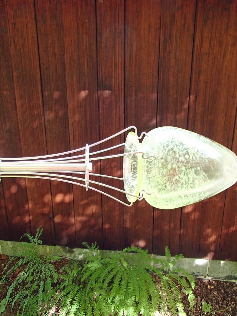

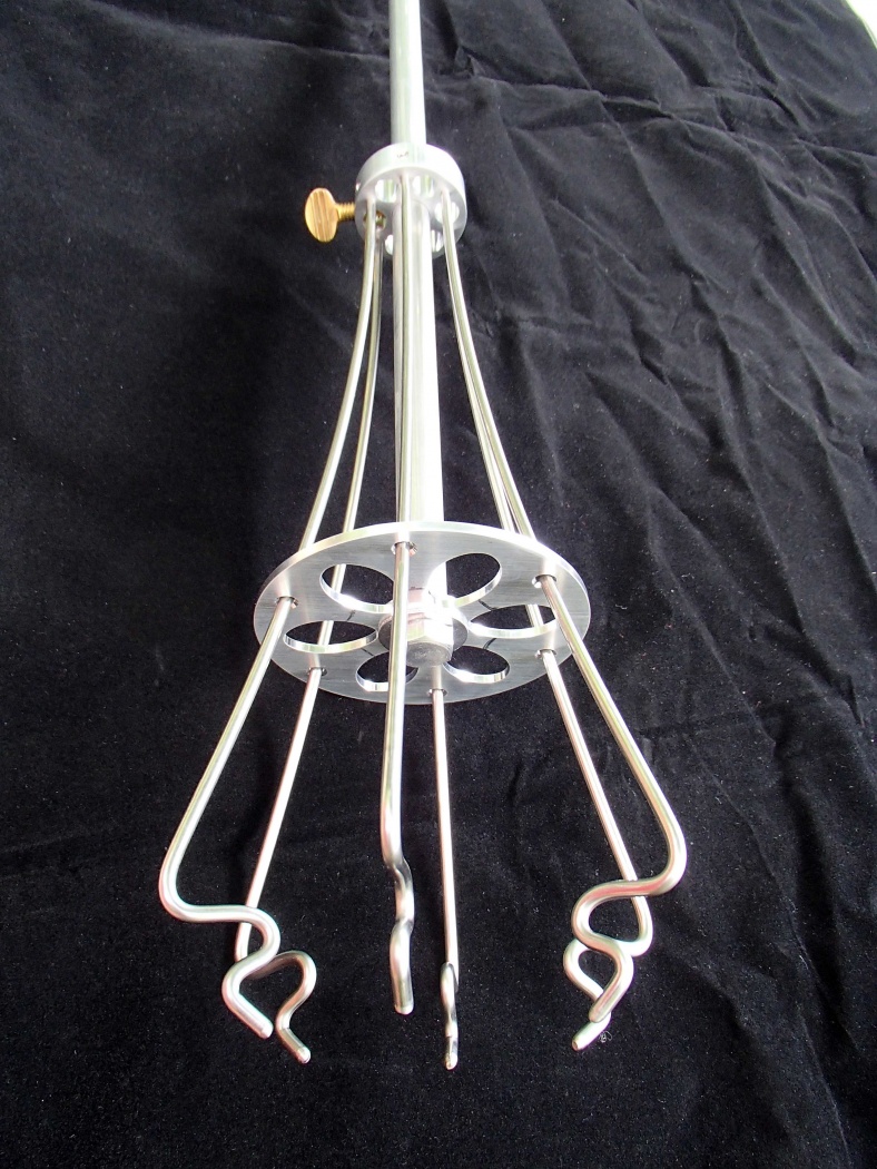

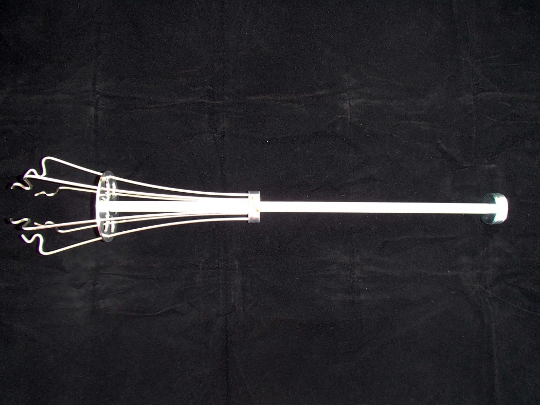

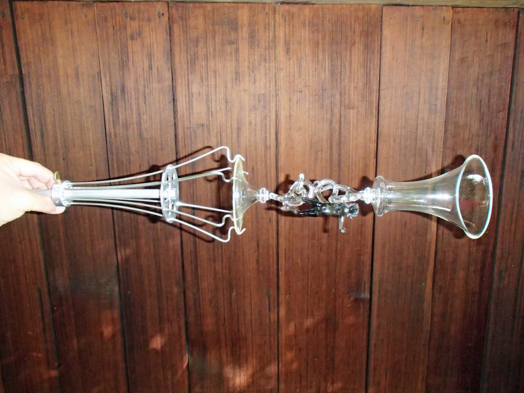

Hello all, so I am not sure if this is the right forum, as I am not a very active member here... So please bear with me, but I have some tools that I have been working on.
I set out about 5 years ago to design and build some kick ass grabbers, as I was unsatisfied with what was available. I made a lot of changes and versions, and have been using some of the first ones for full time use for about four years. I have about 10 of these ready to go, have the parts to build another 40 if people want them. Please let me know what you guys (and gals) think. So, they are made with 6061 aluminum, a heat resistant stainless alloy for the fingers, stainless set screws, a brass thumb screw, aluminum hardware on the front end (noticeable weight reduction), and steel hardware on the back as adjustable counterweights. Everything on these grabbers is replaceable (including the fingers). So I am currently putting together a website, and will post when it is done (tomorrow or Tuesday). Again, please comment or suggest, I need some feedback. The lampworkers I know really like these grabbers, and I love them, so I think others will too. here are a couple pics. Oh, I will sell these puppies for 180. But I will do the first ten for 160 each. I am proud of these tools, so go easy on me! I know the pics suck, I will try and get something better up soon.
By the way, the handle is about 18" long, with an over all length of around 20. They will grab anything from a 7" bubble to a 2" bubble. Also, the green vase in the pic is a very heavy 6" by 9" soft glass vase.

those look super nice, wouldnt mind tryin a pair of them, dont think i can swing the money right now though.

Is that a butt plug in the last picture? Just curious.

Thank you all for the kind words! Menty, that would be a most impressive butt plug. That vase is 6" by 9", and is about a half inch thick. Thanks Jusbag, those were some good times working with you. Here is a link to the site I'm building, but its still a little rough. http://steelheadglasstools.com

Thanks hash! I have done everything I could think of to save weight without sacrificing strength. I actually made one grabber with titanium fingers, but they made crazy marks on the glass...
