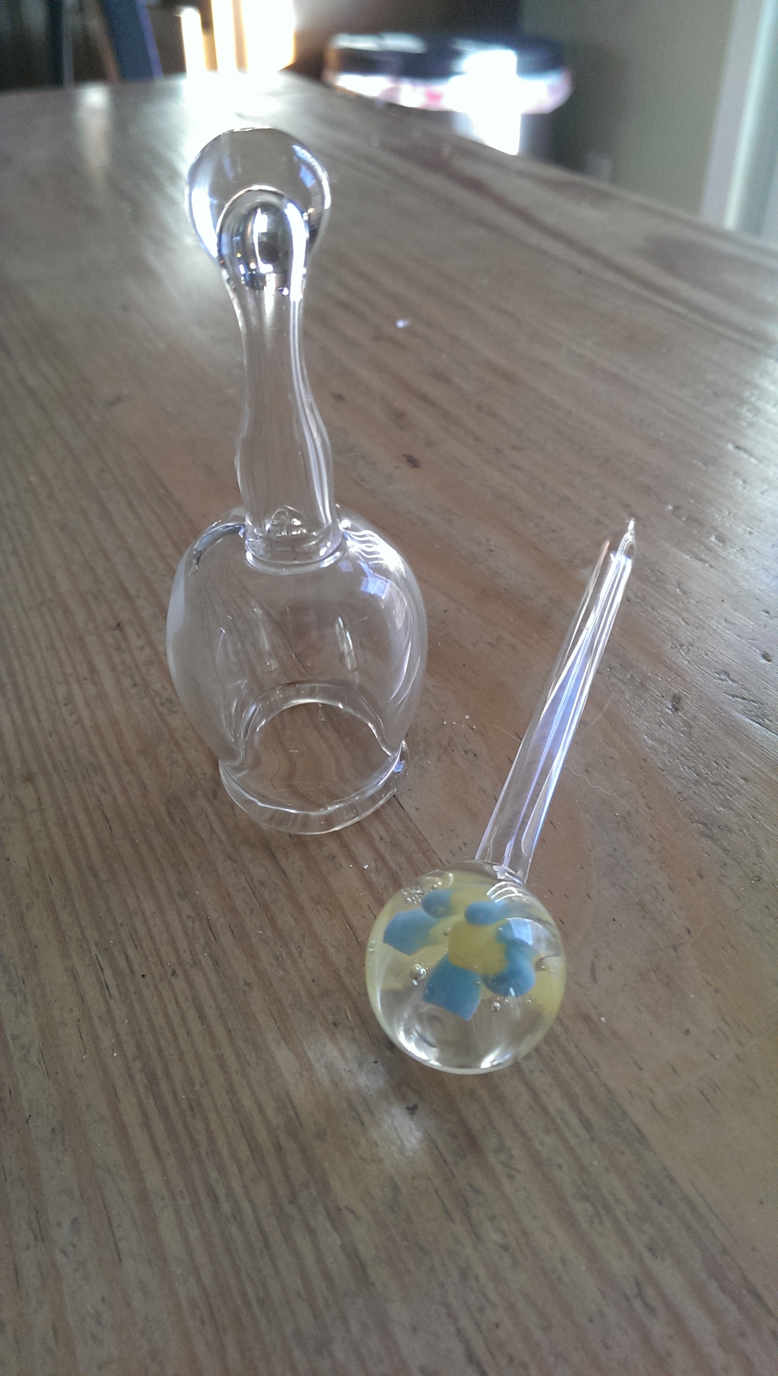

Finally got the ventilation up to par and had my first real day behind the torch in a month. Made this marble cap dabber and a bell style carb cap. Made some other spoons and finished up some marbles just to get back in the swing of things. I was gonna try to make some spoons using a blow tube instead of pulling points like I was initially taught but ran out of oxygen in the middle of the prep. Curious if to how everyone started in the beginning (pulling points vs blow tubes). I do understand the importance of a centered point and cable of creating them. Also if anybody has any progression exercises of what you think I should learn first in the early stages. Thanks!

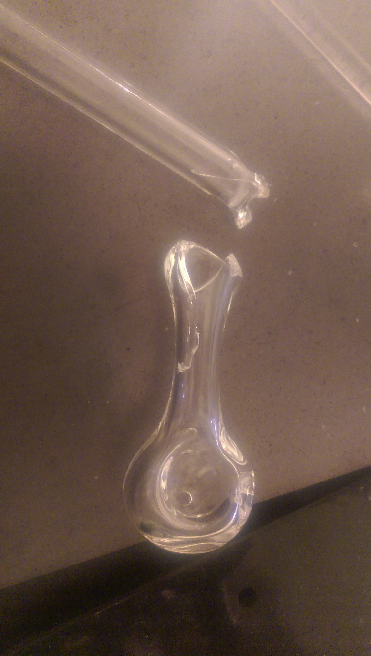

Attachment 72460
Had a stressful couple of days. I have been using the blow tube tech for making spoons on 25mil with 12.7 blow tubes and seems to work really well for me...until I have to take the blow tubes off. Its the basics that are messing me up with timing and having things prepped where my work doesn't cool down in the mean time. I will be garaging the tubes from now on for a few mins before detaching the blow tube. I've also had a few spoons crack from spit running down the blow tube after creating my bubble for the push bowl.
Any tips would be greatly appreciated regarding kilning spoons before breaking off the blow tubes and maybe your easiest way of going about that?

yeah that was one of the best parts in the beginning. it took me months to realize i needed to continuously reheat. i learned most of what i do from revere, and he never shows himself reheating.
i would spend ten minutes working on the bowl side of the pipe. popping the hole pushing the bowl, popping the carb, flattening the bottom, then when i would go to work the mouthpiece boom. it was so irritating. i found that pulling points made it happen less frequently. especially when working all clear like above. i think the blowtube attachment puts some stress if not done perfectly.
on the plus side the shape of that broken piece looks good.
so anyways just always keep the other side hot. pop bowl hole reheat mouth piece, push bowl reheat mouthpiece, blow carb reheat mouthpiece, flatten bottom reheat mouthpiece.
the garaging thing takes too much patience for me, but it does work
Re: Brand new glassblower. Progression pictures.
use your claw grabbers (flash them in the flame quick if they're freezing cold) and melt the blowtube off. then pick open a hole with some 5mm rod. clean up a bit with flame, pop in kiln. done.

after working bowl end throw it in the kiln grab another blank that youve made up and make the spoon then throw that one in the kiln and grab the other one that has been soaking for a while take off from blow tube like an inch before the piece and the radiant heat will heat up your mouthpiece alot more gentle then you can work the rest of blowtube off and pick mouth. any time i take something out of kiln i heat entire piece up in end of nice bushy neutralish flame just so i know its nice and hot thats the worst is having something you spend alot of time on crack after having it happen just a few times ive learned to be way more patient with letting a piece soak in kiln and reheating whole piece especially once you get more than one section. your spoons look awesome youll be making some some killer stuff quick. how clean that connection is from blowtube to blank can aslo cause it to crack alot easier if it isnt perfect. when shaping mouthpiece side of spoon i go in on the blow tube a little and make sure everything is nice and melted evenly. gonna follow you on ig
there's also quite a few people who just anneal with the blowtube still on. the next morning (or whenever it's cooled off) score and snap the blowtube off and flame polish the ends. i think mostly the people who do this, do it just for low end prodo, and i have no idea if they bother annealing it again after.
