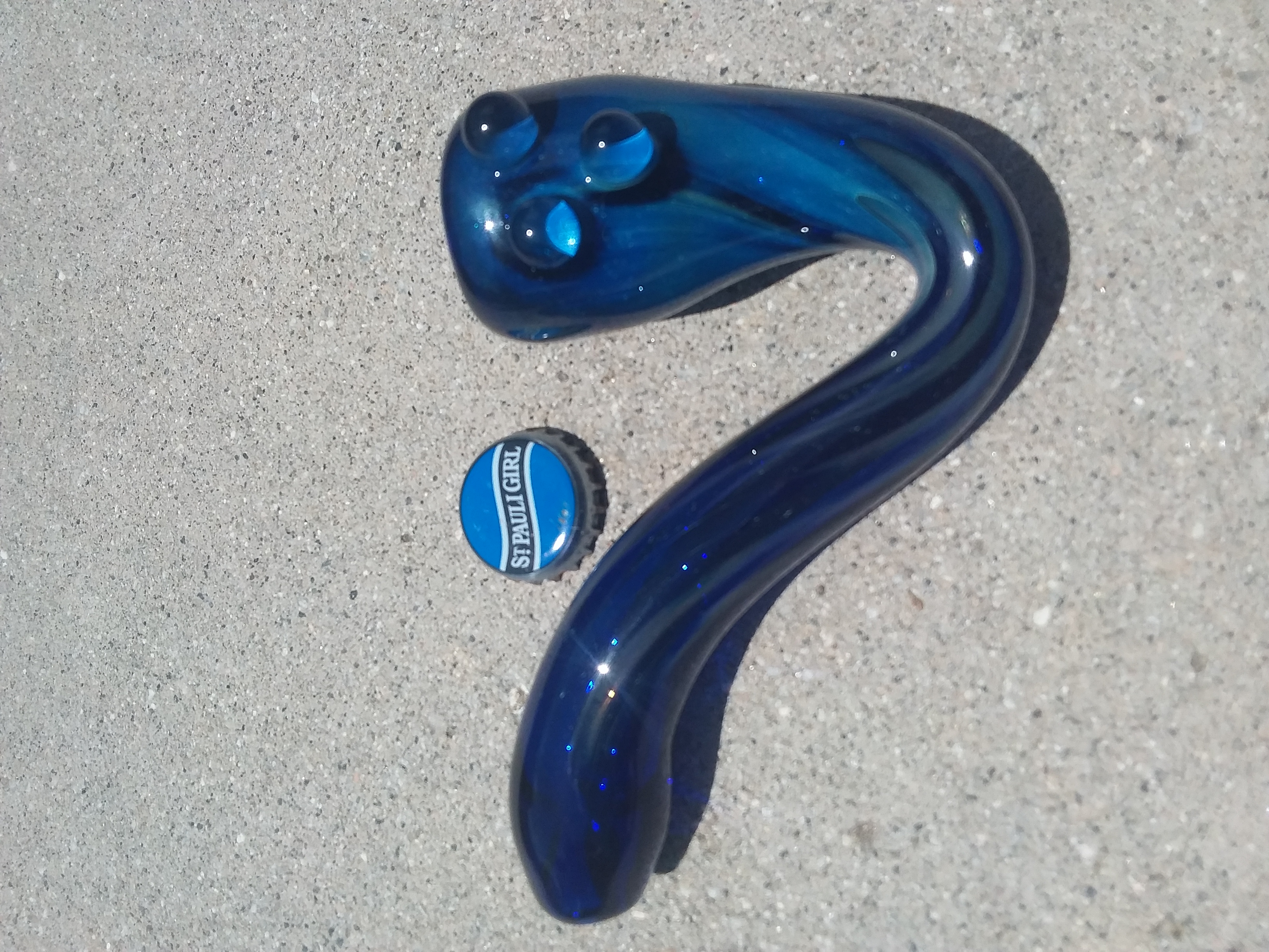

nice! dudes chillin :chilling: i made a decent one today ill post it up when the kilns done with its thang.
Attachment 90266 here it is I used 4 or 5 inches of 38x4 it's got some weight
Attachment 90361Attachment 90362
Ns aurora
Nice! I really like Aurora frit, one of the few colors i have on my bench.
thanks i always enjoy making these. occasionally i completely mess them up and theres usually no saving the piece if it goes to hell.
but most of the time i nail them and they're faster and more fun than spoons. they take more concentration though.
i just do a hot seal for my punty on these now and the tube doesn't crack and the punty never lets loose in the middle of the bend.
also, if i messed up and forgot to or didn't preshape the bowl area well enough i add a dot of glass or leave some of the hot sealed punty clear on. then i blow the bowl hole out of that like a kicked out carb so the hole is nice and thick and it doesn't open on itself and makes it easier to push the hole to the center even and all that.

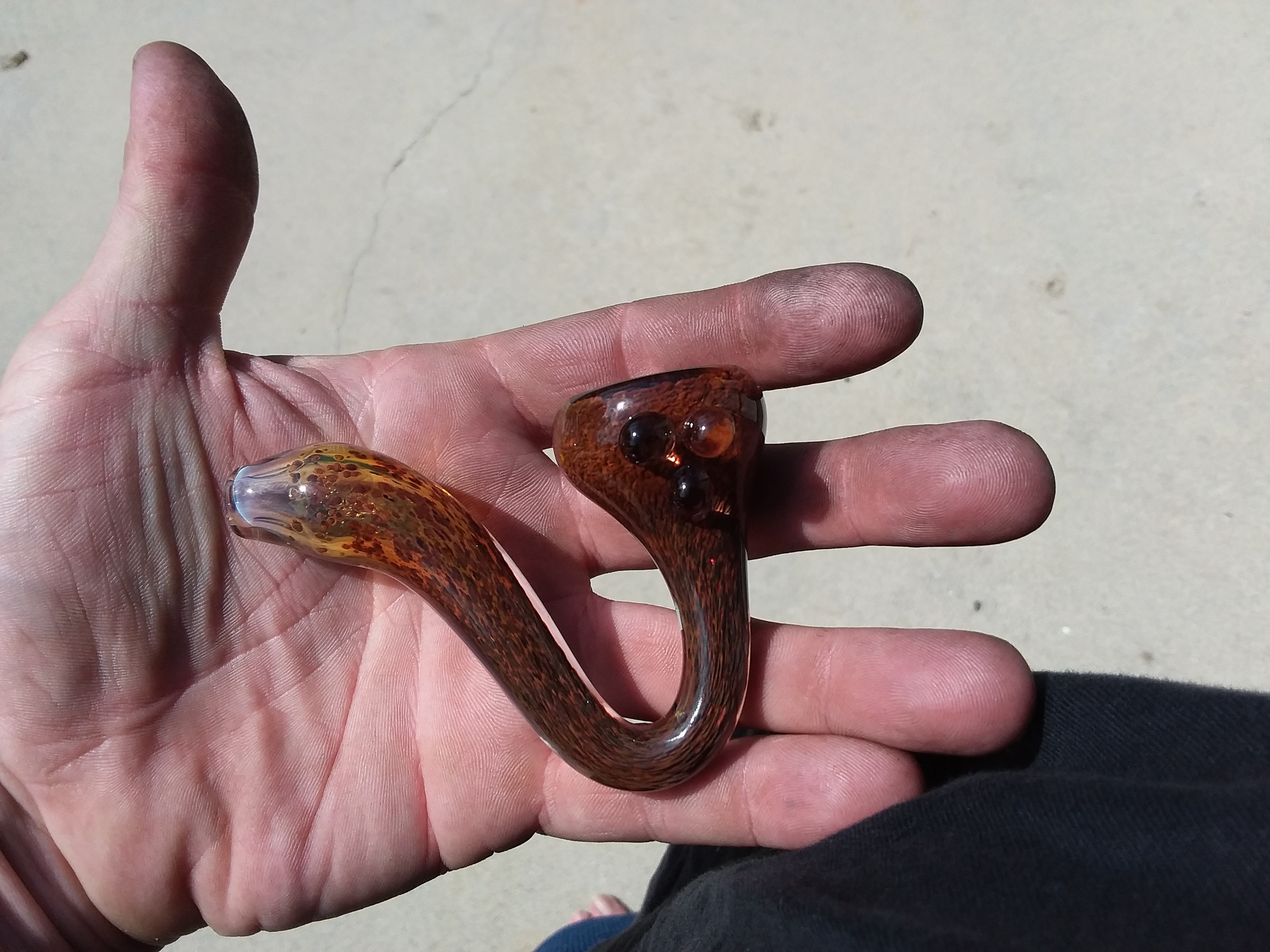

went through this whole thread. great info and well done when u started those cerebrus. i have been practicing one pieces here and there and i have a super thick frit piece im about to bend but i practiced on some clear a few times today bc i dont wanna fuck this one up, even though i could start over again easily. you guys know that feeling. i just really want a shape that is not so thin on the bend on this one. heres the "blank". bowl is already pushed so i'll punty up with a cold tack to the bowl i guess. https://uploads.tapatalk-cdn.com/201...ae27069bd6.jpg
Sent from my 6062W using Tapatalk

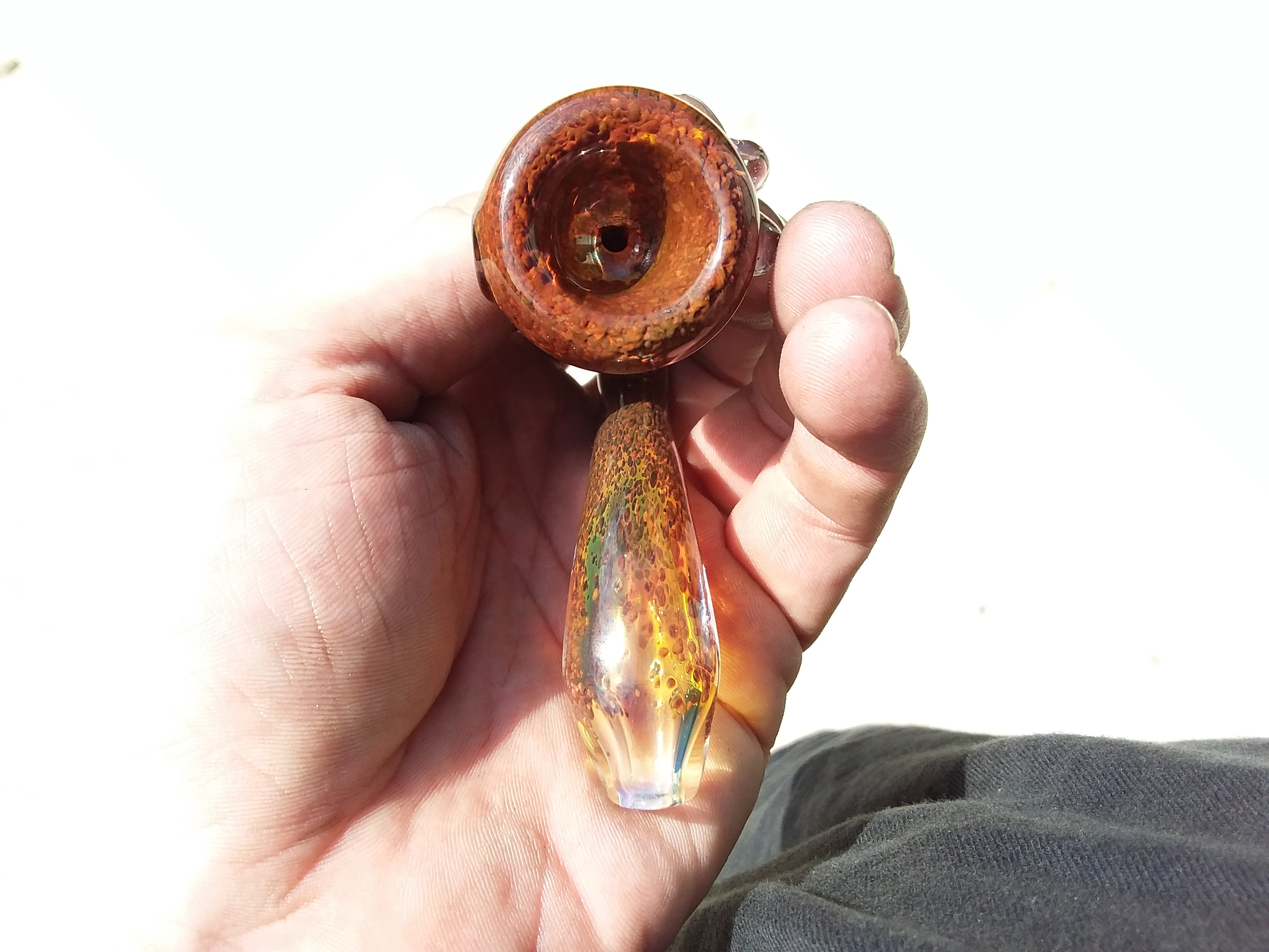

don't know if i posted the butterscotch one finished somewhere else but these are really fun to do with a kickstand. I dont post my stuff here to say "look at me", most of you guys are far ahead of me and i welcome critiques and advice and opinions or whatever. This forum is a great place for shop talk unlike other platforms that are more sales driven. Anyway....the 2nd one is my first encased opal. I've had a little issue with these popping the carb in the super thick bowls. I might start removing glass from the spot before i go to pop them bc damn......https://uploads.tapatalk-cdn.com/202...3f5bee04ee.jpghttps://uploads.tapatalk-cdn.com/202...8fbde1aac9.jpg
It looks like it went well for ya! Interesting tech on the bend by punty to pushed bowl.
Not a bad idea to remove a bit of material for a carb on these thickbois, takes a lot of heat to punch through.
