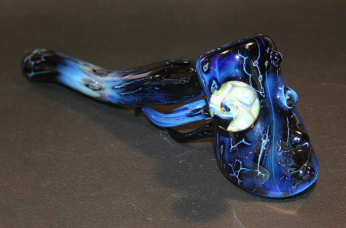

    I've been blowing since early 2008, and I've learned virtually everything from this forum, so I figured I'd start posting my progress so far.
    Any criticism is welcome. Let me have it! It's the only way I'll improve.

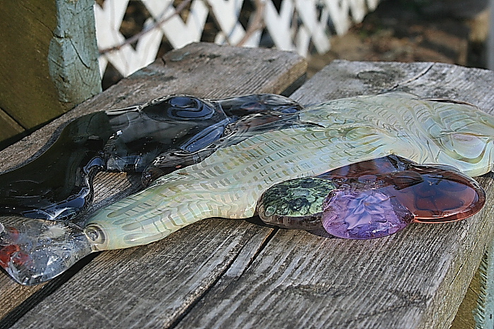

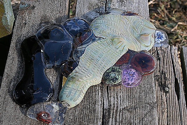

    But first, I'd thought I'd start out with some pics of last month's disaster...
    I had finally started nailing my floral implosions, made a thick hammer bubbler, and a couple of spoons, and was pretty excited to open the kiln. I found this...

    you should keep the first work of art, people get a kick out of seeing what goes wrong.

    The thing that amazed me was the almost complete lack of devitrification.
    It's hanging beside my bench now...

    As a reminder to set the dial on the kiln? lol - I've come pretty damn close to doing the exact same thing.
    You're work is looking pretty damn nice - I really dig that blow-in hammer up there. You'll have to let us know how you got such good sparks from that. I've done a lot of those and getting that effect consistently has been hard for me.

    I like your wall art, that looks really good. Abstract.
    No devit either, well done.

    I sleeve instead of blow-in, but consistency is a problem for me too. I'm thinking the most important factor is the amount of fuming.
    My 'wall hanging' is more of a reminder to install an upper limit alarm relay. My first relay stuck closed, even though it was mechanical, so I've changed to an SSR, but I still want to add another relay to shut down the kiln if it gets to a certain temperature.

    The lack of devit is very neat.
