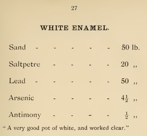

    What types of colors have arsenic in them? I heard pink slyme is heavy in arsenic but dont know many others. I wonder if any glassworkers ever get tested for heavy metals in the their system.
  20. #40
    brads's Avatar
    brads is offline Intelligence has its limits. Stupidity is infinite. Higher Learning Member0-1 years in glass!1-6 years in glass!7-12 years in glass!13-18 years in glass!19-25 years in glass!25-49 years in glass!Ninja Badge
    Mar 2014
    Zombieland, Georgia
    942
    59
    Default Re: Bullseye pollution problems
    Nearly any color can have arsenic in it because it can be used as a fining agent. I can't speak to low expansion boro, but in soft glass the opaque glasses known as "enamel colors" typically contain arsenic. Arsenic and lead together make the best dense white enamel color. Many other opaque colors use that as a starting point and simply include additional colorants.
    Here's a copy of a white enamel recipe from the 1907 book "Recipes for Flint Glass Making". The lead would be in there anyway, since the recipes are for lead (flint) glasses. The 4 1/2 lbs of arsenic in this is what causes the lead glass to become a dense opaque white.
Name:	Screen Shot 2016-02-11 at 10.26.08 PM.jpg
    Arsenic can also be used in cadmium-selenium colors to help with oxidation/reduction reactions.
