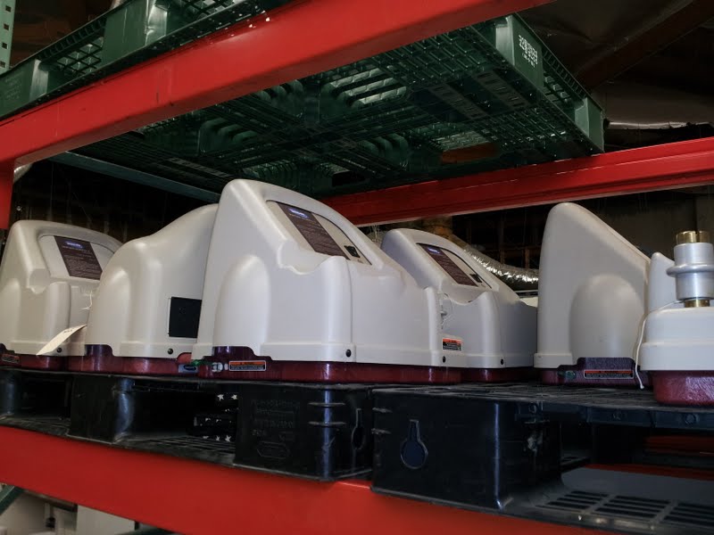

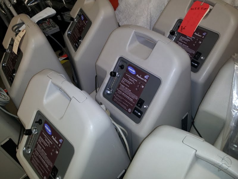

I usually post my excess equipment on craigslist, and in the last 24 hours had 3 inquiries about homefills for the glass blowing community. That is how I found out about this forum. I sold 2 by walk in yesterday.
I have 35 homefills in excess at the moment, along with their corresponding platinum 5 concentrator. I closed my LA warehouse and I am currently palletizing my excess inventory.
If you would like a homefill, invacare concentrator, 5 LPM, 10 LPM, let me know.
Here is a tip for you, if your platinum 5 is alarming for purity, check the 4 way valve, the old style with the chrome ball bearing tends to crack. Good news, lifetime warranty on most of those. It gets sent back as a core to Invacare, and you get a new one. The most important filter to change is the small round filter, not the hepa.
