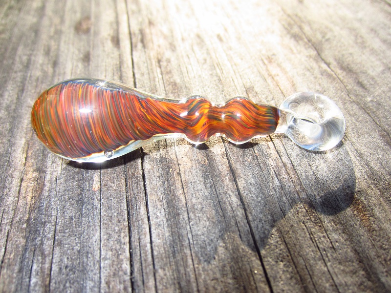

Crayons = SUPER oxy flame, work way out in the flame. If you have a inner/outer flame crank the shit out of the oxy on your outers.
Atleast this is how I work them on my Phantom. When I had a red max I wouldn't even try because they boiled so bad.
I'm going to test it out and see how I like it up there. I noticed it made me feel a little confined last night while I was on the torch. If I do move it it will be right to the left of the wall that it is next to it will still be like it's on my bench just not I'll snap a pic after it stops raining so you can see what I'm talking about.
Thanks bro I had alot of trouble using them at first too, Last night was my first time getting it not to boil and I still had a little bit of boiling. I think it is just practice the more I practice the more I'm able to use the colors I couldn't use before. I start out using a real soft bushy flame and get the color I want to work in the back of the flame do not rush it I find if I rush it and get it too close to the flame that's where my problems start. As it get's good and hot and you have a good heat base you can start introducing more heat but easy does it. Once it starts boiling it spreads fast and you will have to tear the boiling parts off.

LOL, so my major/minor will probably be even worse. I actually used some orange crayon today and made some glass sea mines. I used a really low reducing flame and it turned out great. I boiled a couple pieces but was able to pull it off and salvage it. I noticed the closer I got to the tip the faster it would boil even in the reducing flame. It just seems crazy to work with that much solid crayon, it would take me a year to make something that size lol

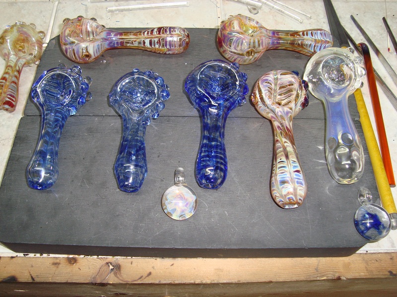

I'm digging the kiln on the bench I think I will keep it where it's at, It's not in the way and it's right there within arm's reach. Here's a couple spoons I made last night. This was my first time striking in the kiln too I'm figuring it out slowly but surly.

These spoons look very consistent, nice shaping and coloring. What size tubing are you using?
Thanks bro I've been working hard on my consistency. I'm using 25.4 x 4 tubing for all my spoons.

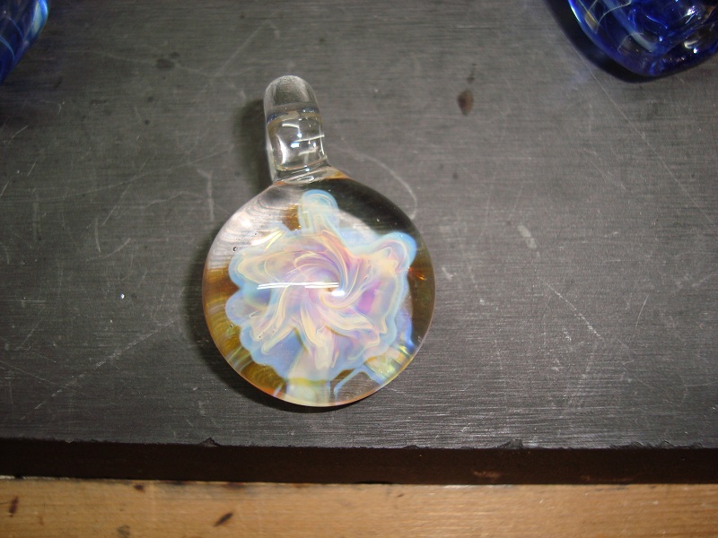

And some pendants

Progress is coming along great Levi! I am yet to try a retti, but you're really inspiring me to do so! Your pendants look great, your dishes are looking better, and your spoons are consistent, you're starting to develop a style, for sure. I'm sure jealous of your kiln, look awesome! I really wish I had something like that, but hey, my top loader works, and its mine, and that's all that really matter :D

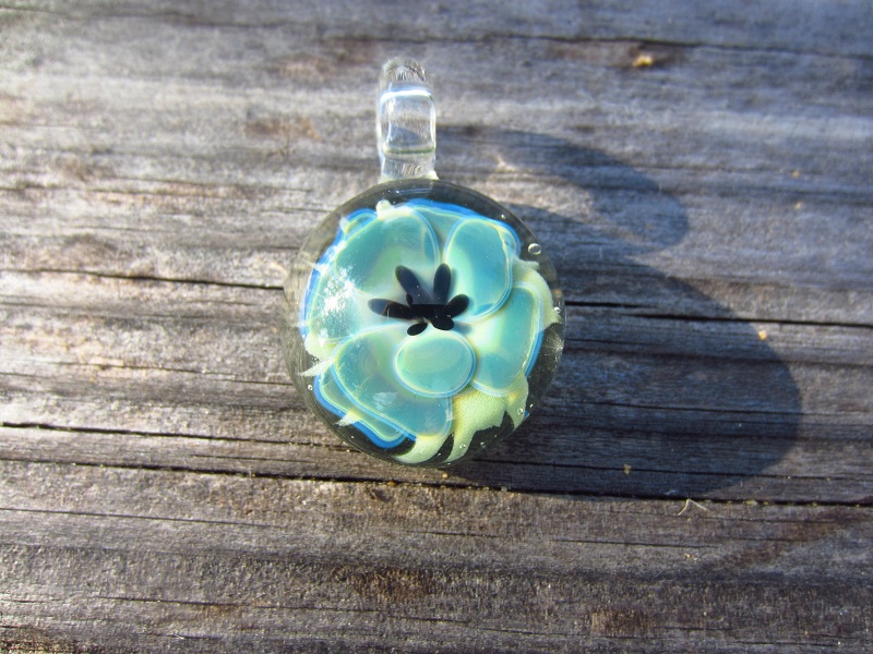

Some zigzags I've been adding to my W/R bubbles
