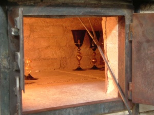

Previous to the advent of electric kilns, gas- or wood-fired kilns were used to anneal the glass. Such kilns required constant attention of someone to both monitor and control the temperature of the glass at any given time. In some cases, temperature of the glass was changed simply by incrementally moving the glass further from the heat source inside of the kiln (see photo.)

goblets being annealed in a gas-fired kiln at a glassblowing studio in Murano, Italy. The forked pole is used to pick goblets up and move them further away from the heat source inside of the kiln as the temperature evens out inside of each goblet. Photo credit: Wesley Fleming, 2004

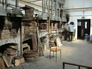

A wider view of the bank of kilns in this Murano studio. Although these kilns are now gas-fired, they were previously wood-fired. A fireplace is visible underneath each kiln - the exhaust (chimney) was directed up through the kilns to heat them. Photo credit: Wesley Fleming, 2004
